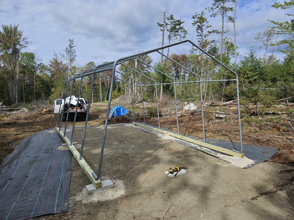

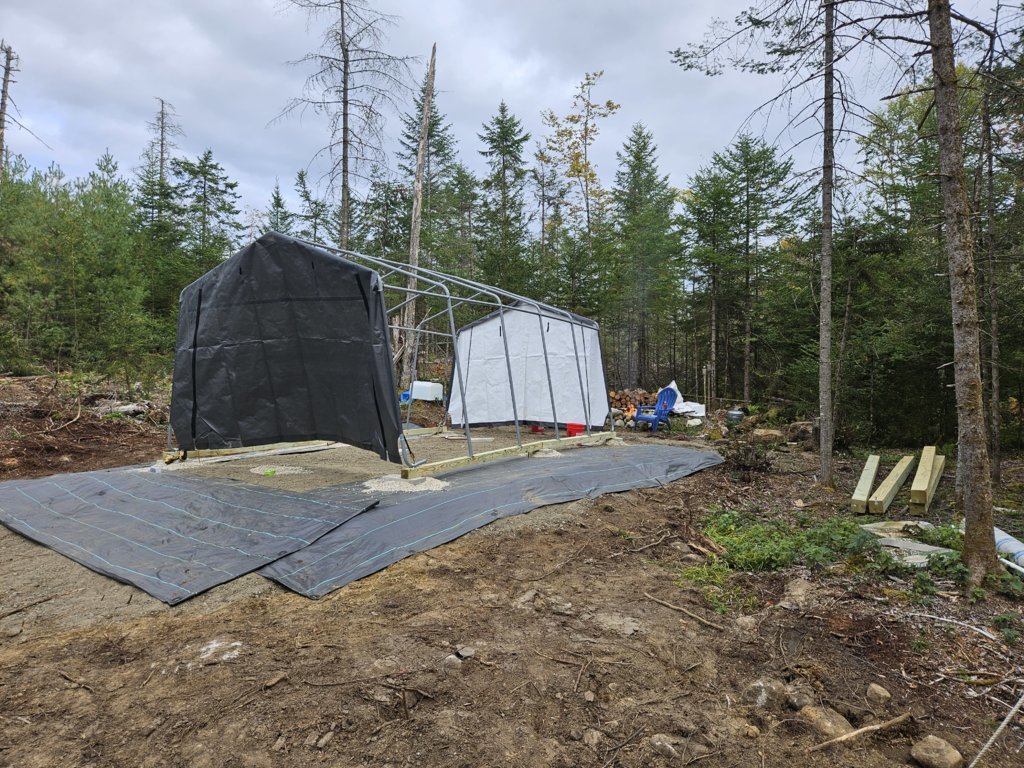

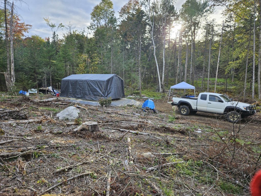

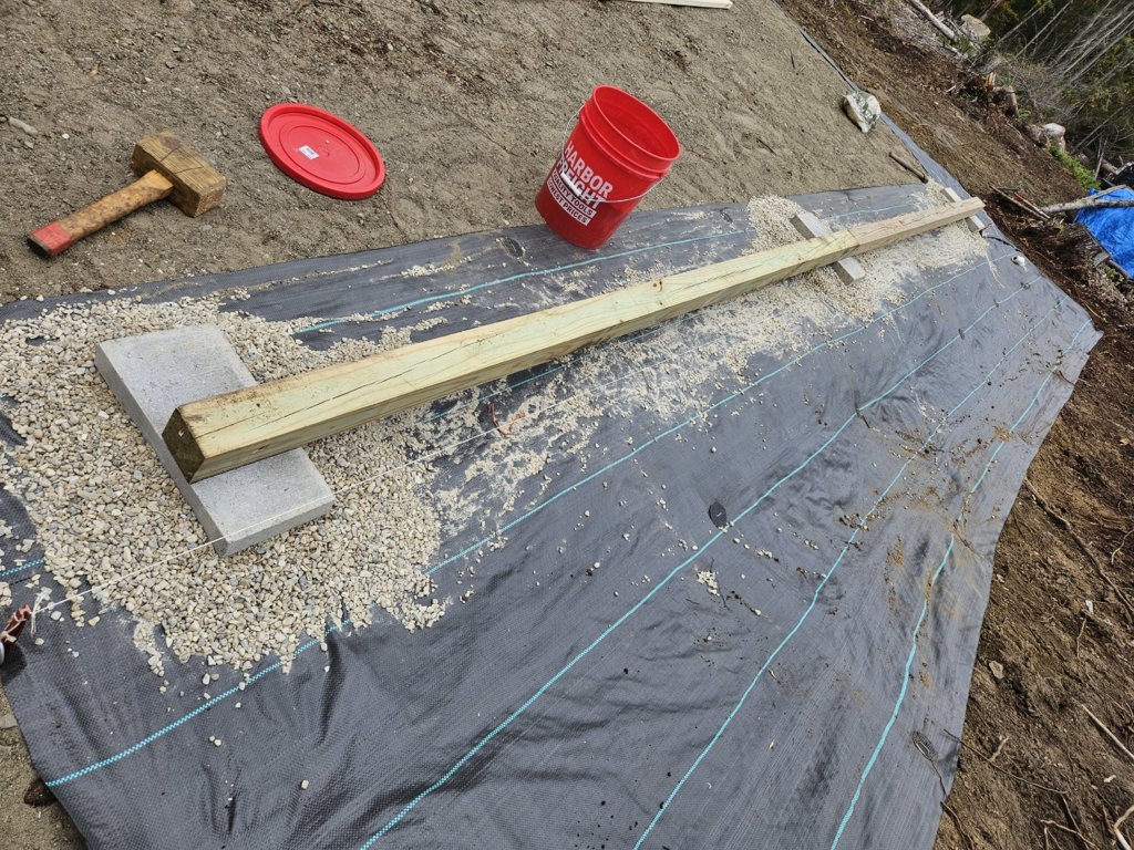

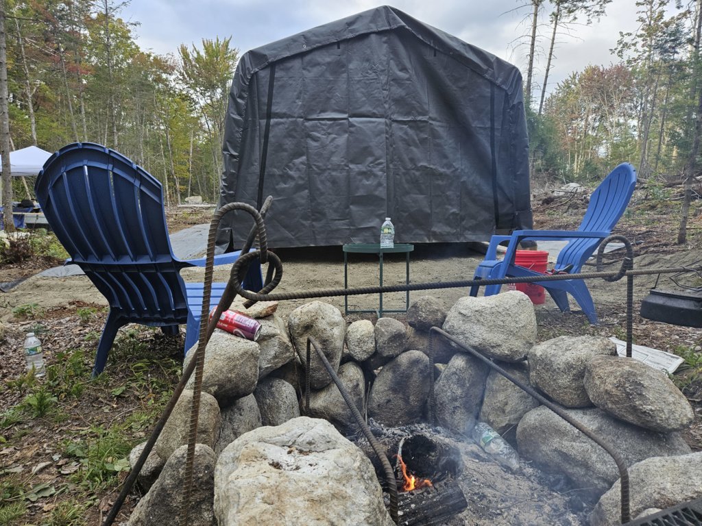

    Wheeeeeeewwwwwwww. It's slapped up for now - I need to let the cover warm up and tweak.it, and do some stuff to it beyond what the factory says, but damn it feels really nice.to have enclosed space at the spot. I'll faff with the cover when the conex arrives Tuesday and start stashing materials for the floor/flashing/etcetera, hopefully to have a 4 seasons shelter before it gets too too cold.
    I want to frame the end walls and put in pax doors, rather than screwing with the cargo zippers, among other things.

    Nice! Can you provide purchase details? The Amazon portable garages I used collapsed under a heavy snow load last winter and it is not looking like a garage will be in the future anytime soon. This looks more robust and I like the cross support pieces being slightly lower to hopefully allow the snow load to slide off instead of getting stuck.

    Hazard Fraud's "CoverPro" brand. There are a couple tricks to really strengthen these frames up for heavy snow loads - I'm waiting on a spool of aircraft cable and some hardware, I'll be fixing up the cover and doing those modifications this week once the stuff gets here, and with those in place, these will easily handle 2 feet of snow on top without bowing or sagging. Aside from the tension cables and changes to the way the factory cover straps are anchored, the other big thing with these is securing ALL of the feet to the ground. The frame as-is is pretty dang strong, I was doing chin-ups off the ridge to get a feel for it.
    The frame itself is at least as good as the $$$$$ pop-ups (appears to be medium wall 1 1/4" tubing, with a surprisingly alright powdercoat), the cover is decent enough, and in 3-4 years when the cover is toast just replace it with metal roof panels and self tappers. If you poke the tubes for "Coverpro Garage Modifications" you can get an idea of what you can do with these things if you (like a lot of HF stuff) treat it like a kit and not an out-of-the-box product.
