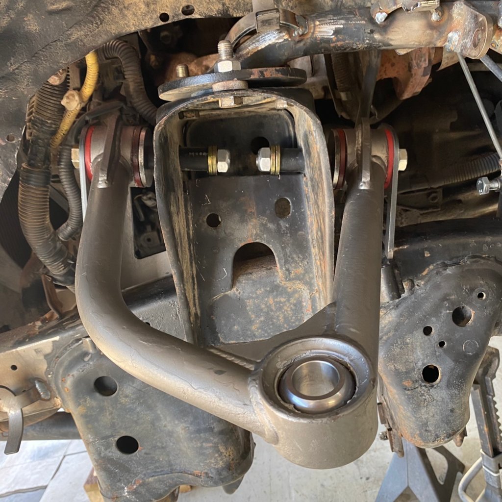

    Saw this this morning while poking around the interwebs. Would make bolt removal/installation easier. Not sure how it would work if the shock is installed. :confused:

    I like that! You’re right tho about the shock but totally worth it imo. I have to remove my grill to get one in… think it’s as strong as the oem 2 foot bolt???

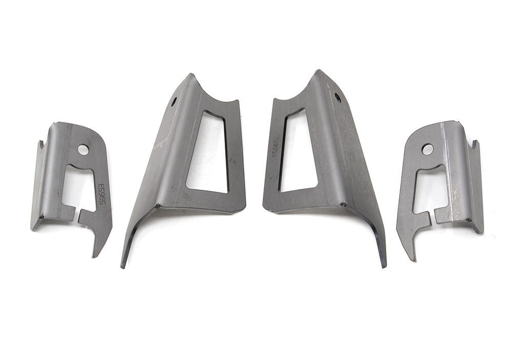

    I would say yes with these tower gussets welded on.

    Can do, Should be as strong but there are two things I notice.
    Your bushings probably arent going to be perfectly aligned with eachother, just the nature of this type of work. I do not think this will be a big deal at all.
    Double the failure points but Id definetly go with stover nuts and that shouldnt be an issue.

    Oh also, ive heard that some companies gussets dont even come close to fitting. One of us should do some research before buying @AllTacosFloat

    Will do… maybe just make our own?

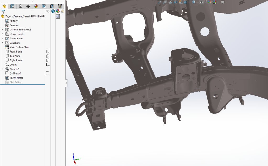

    ... I do have this, Id say we go that way if we cannot find a company can make them good.
    I dont think it makes sense for me to spend the design time cause of the price to buy them(if they fit) and theres only a few people around here that would actually want them

    Sounds good, if we need to make them Id much rather do that then grind/ have to fill gaps on other companies
