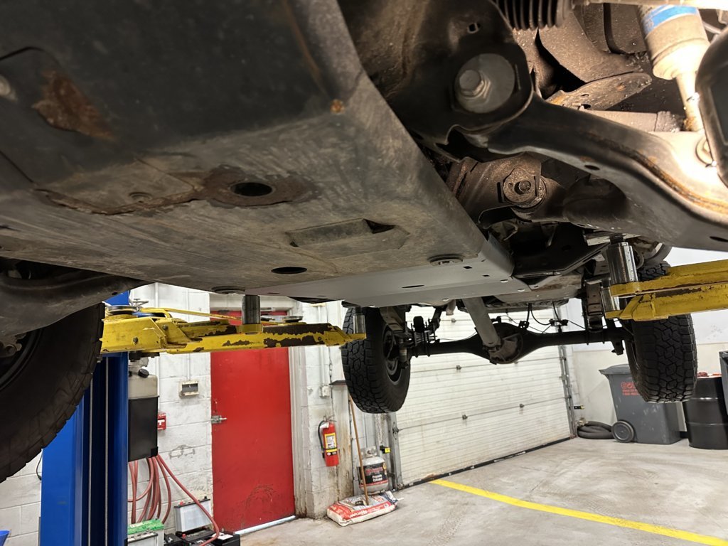

    Mocking up the skid plates. No welding required. All you have to do is drill two holes.

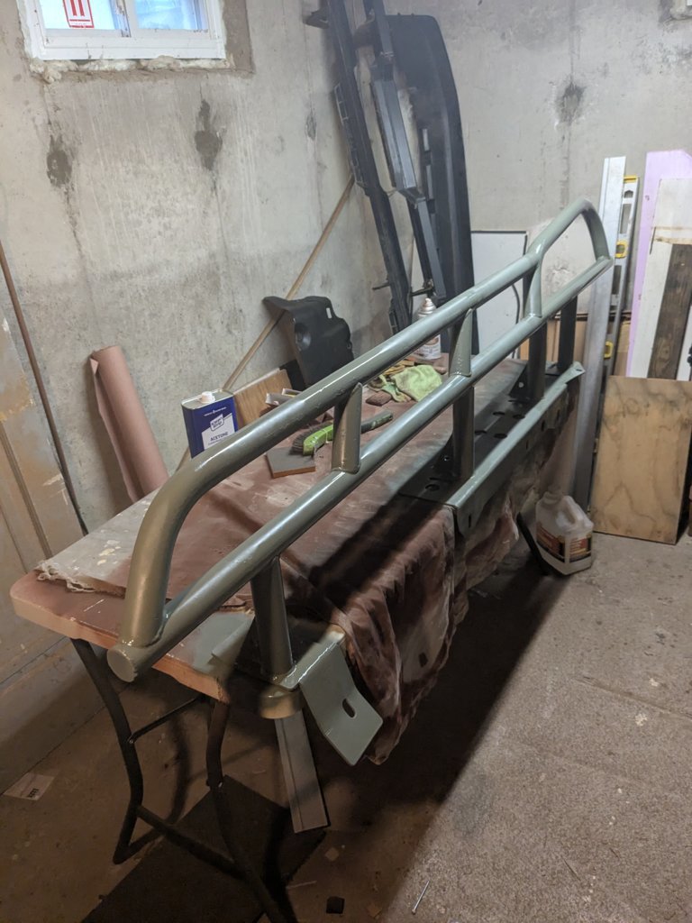

    Well I am not happy with the way the first one came out. The paint almost feels soft. I am going to let it sit for a couple of days and see how it is. In the meantime I got etching primer for the second one. It only has a first coat right now. Still need to flip it and finish the other side. Will see how this one turns out.PXL_20241228_161900800.MP.jpg

    Nice and flat. Now I need a good drill and some spacers/bolts/nuts.

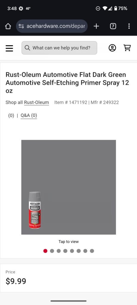

    I never had good luck with self etching primer. I like the Rustolem automotive primer much better. You can find it at Walmart in the automotive section.

    I used (2) different ones, it just seems the primer is soft. Can be scraped off easily. Will let them sit for a couple of days and see how they turn out. Still need to get bed liner to give it some grip, so I have time.
    This went on the first slider.
    This went on the second one

    That's not good. Make sure you do light coats and it's not too cold where you spray.

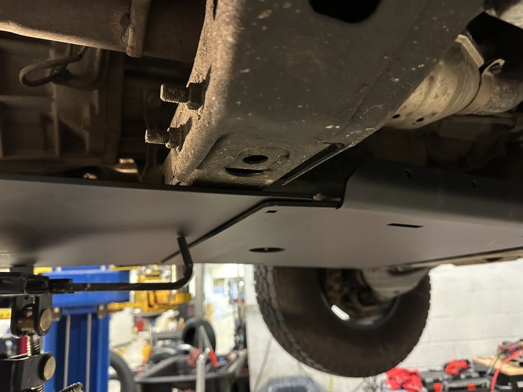

    or ...
    maybe drill the two holes for the transfer skid and weld the two skids together? :sawzall::welder: Would that be strong enough?
    Either way I'll have to drill two holes for the transfer skid and get two spacers about 3/8" thick, I'm thinking a thick washer.
    The transmission crossmember is about 1 3/8" too far to the rear.

    Yeah, I am most likely going to resand them and start over. I may wait till the spring though as painting them in my basement isn't great. "Fumes and space"

    I've used self etching primer a few times with good results. It's been a couple of years, but as I recall I used two very light coats and then two light coats of color. I don't remember exactly what it was, but it wasn't automotive. I did way more painting at the house then I ever wanted to while getting ready to put it on the market.

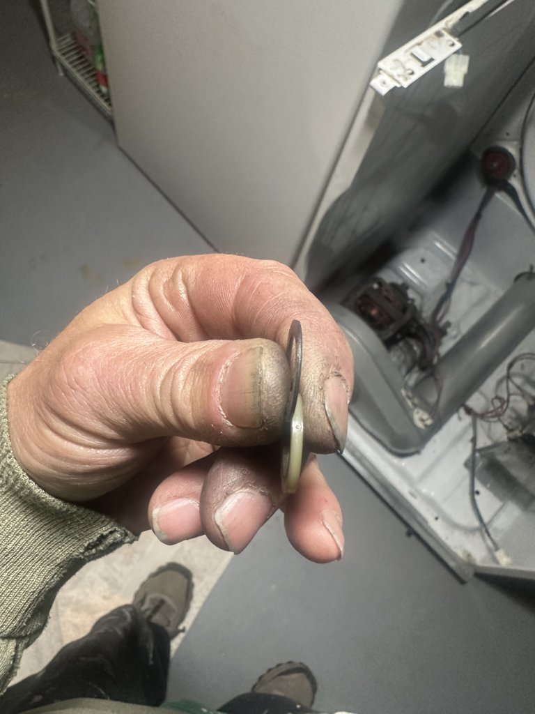

    Looking for an opinion on whether or not I should / could keep the old nylon washer for the idler pulley on my dryer,
    New OEM pulley came with the thin metal washer . Nylon washer looks great ( to me). Use complete kit that came with package or old nylon one?. I’m thinking old will be ok
  19. Dec 29, 2024 at 10:41 AM
    deanosaurus
    deanosaurus Caveman
    Jul 23, 2018
    #260241
    2,181
    Northeast Region
    09 TRD OR AC
    The metal one was cheaper to make then and now. The metal one might be "good enough" but the nylon one definitely is.
  20. Dec 29, 2024 at 10:50 AM
    Pibbles99
    Pibbles99 One more cast
    Nov 3, 2015
    #168608
    5,138
    Brian
    Southern NH
    21 OR dbl cab
    What i went with was the nylon . Thanks for your reply
