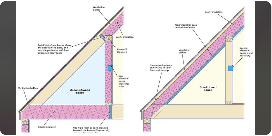

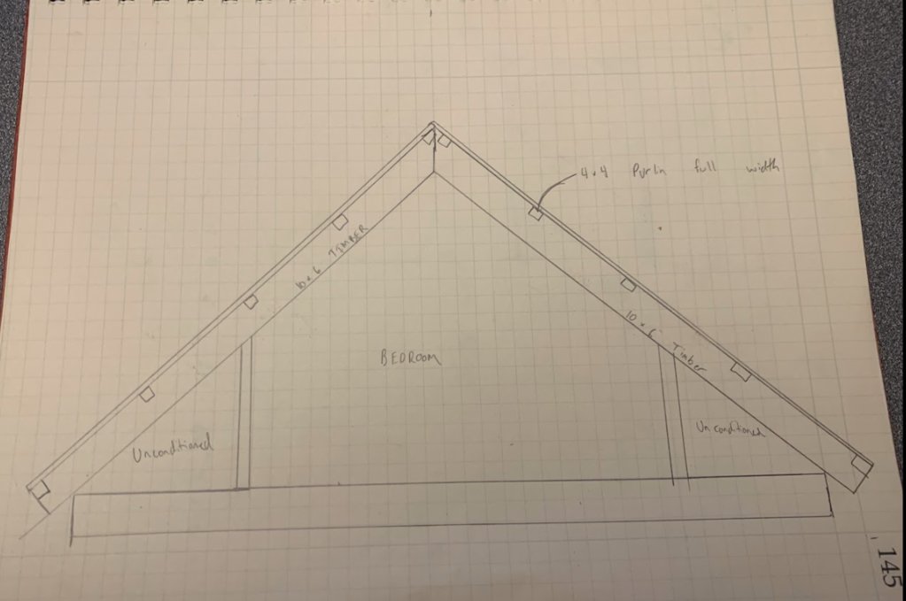

    Im kind of stumped with this one and need some insulation/ venting help.
    I am trying to insulate and properly vent the attic of my upstairs. House is a 1790 Cape that is not built like any sort of house today. The whole roof has 4 rafters per side (8-10 ft span between) that are either 8x6 or 10x6.
    I am basically sold on doing an unconditioned attic space behind the knee wall because I will never be able to get good air sealing on the corner.
    My main hangup now is how to vent the underside of the roof decking when have the ~4x4 perlins in the way to use typical rafter vents. It is my understanding with asphault shinges this must be done or they will fail prematurely. Roof must stay on as it is 3 years old but I am basically planning on gutting the interior.
    There is currently no insulation or intentional venting in this part of the house. (there is plenty of unintentional venting)
  9. Feb 19, 2025 at 9:17 AM

    Prematurely fail… you telling me your roof is going to be hotter than a vented roof in Arizona… they get the same warranty. Worry more about ice dams. That is more of a concern around here. Melting snow and ice could dam up on the insulated/ non insulated line and suck.
    Happy to help get it figured out for you. I’ll pm you a little later.

    I had a similar issue in my cape when we finished the second floor. We added a flat section at the peak of the ceiling to still allow air movement across to the end gable vents.

    right but the perlins in jacks house run the opposite direction of conventional roof rafters.
    his house is post and beam . altogether different type of construction.
    AllTacosFloat likes this.

    Yep this is the main issue, how to vent the sloped cielings so ice dams don’t happen. I have 2 different ideas right now but curious what other people come up with.

    jack whats the height of the knee wall?

    About 3-4 feet

    I would think the idea on the left would be more prone to ice dams.
