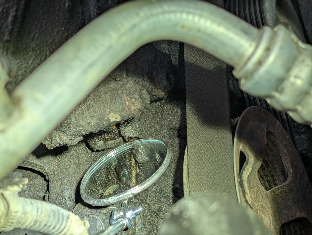

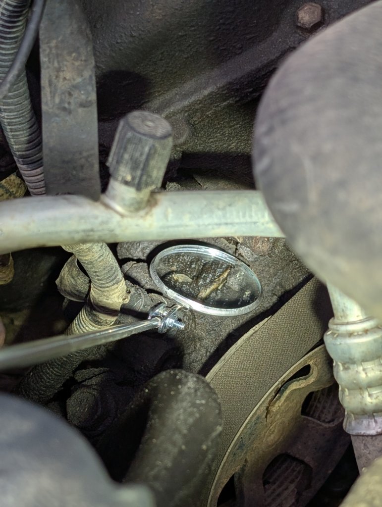

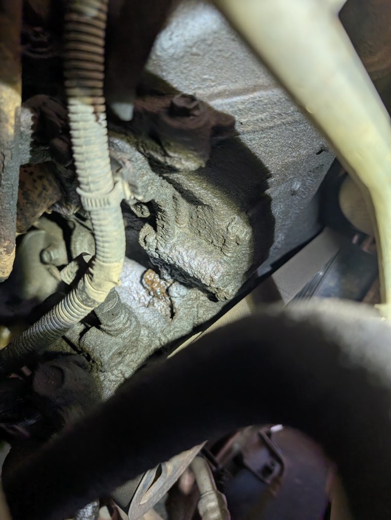

    Been a while - hope everyone is well here. I've been on/off travel non-stop for the last like year so wheeling time is basically null and all my spare time goes to expressing my 2nd amendment rights...
    To be honest I haven't done a whole lot to the truck besides general fluid changes however I noticed a pretty noticeable leak and my power steering leak is getting worse. I can't seem to gauge this leak other than I'm guessing it's a valve cover gasket leak that is seeping down. The issue is that whole side of the engine is thoroughly lubricated by a minor power steering leak that is helping rust prevention... I'm going to brake clean it this week and reassess the leak later.
    In the photos - you can barely see the wet spot, dead center of the photos. Don't mind the grime build-up... the power steering pump has been misting the whole area since I bought the truck 130k miles ago...

    Not sure on yours but that's the same area my 4 banger leaked oil and turned out was just the sending unit.

    I didn't see anything in that area besides the bottom of the valve cover - I'm gonna brake clean it now and take it for a drive and check.

    Took a look closer after cleaning it, definitely a leak from mating surface there. I'm not up to snuff on the Tacoma engines so I'll have to look at a diagram when I get home. Doesn't seem to be pissing out the side but definitely something to keep an eye on.

    Seeing your first pictures and now the ones with the mirror, it definitely seems like the timing cover is weeping on your truck. I see it alot on higher mileage Toyota's, they never leak, but just weep and make a big mess.
