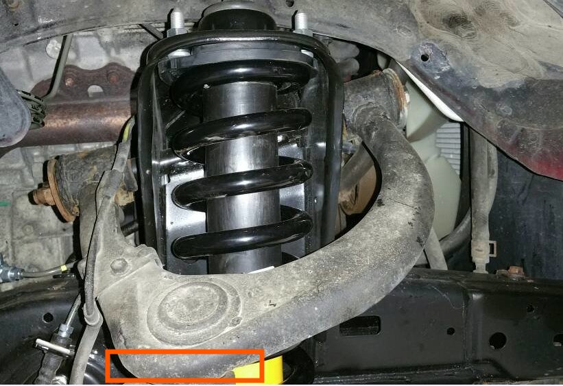

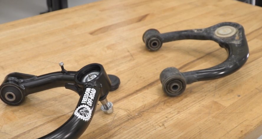

    I need some UCAs, primarily for tire clearance. When i stuff tires at full lock/reverse, the lugs are rubbing the factory UCA in the circled area. I want something for daily driving in the Northeast so I believe these are the important factors:
    Tubular design for tire clearance.
    OEM style sealed balljoint
    Standard style bushings
    No heim joints, uniballs, fancy bushings, etc.
    I want reliability and longevity. Ideally around the $500 of less for a pair.

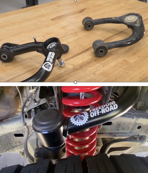

    I was looking at the following
    -Poly Performance: $450 https://www.polyperformance.com/pol...g3MtvUJWrNmPnOgrZIAQcKIiyCZUHqaxoCJZIQAvD_BwE
    -Freedom Offroad: $390 https://www.extremeterrain.com/free...XxoC63UQAvD_BwE&gclsrc=aw.ds#customer_reviews
    -ADS: $560 https://www.adsshocks.com/products/control_arms/parts/100ADS-10058
    -Rancho: $340 https://www.rockauto.com/en/moreinfo.php?pk=7611640&cc=3446952&pt=10401&jsn=562
    I haven't heard a bad thing about Freedom Offroad. Any other recommendations or things i am missing ?
  8. Jun 16, 2025 at 9:43 AM

    I don't necessarily know that swapping to a different uca will clear tire if you're rubbing there, you might need more offset/spacers

    Here's what i am seeing with the freedom offroad. It doesn't stick out past the knuckle.

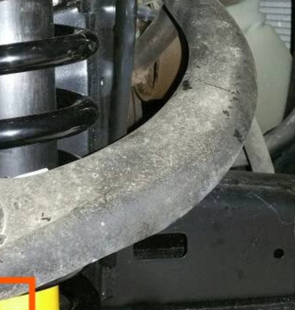

    Do you have witness/tire marks on the bump out right there? If you're rubbing at full lock and reverse its probably rubbing here
    Don't want you to spend the money on new arms just to have the same problem

    Correction,

    Yeah I'd think it'd be a toss up whether or not a new arm would give you enough clearance there to not rub, still think a tiny spacer is gonna be the move if you have the firewall clearance
