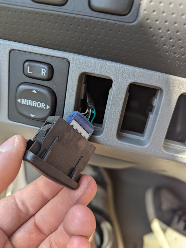

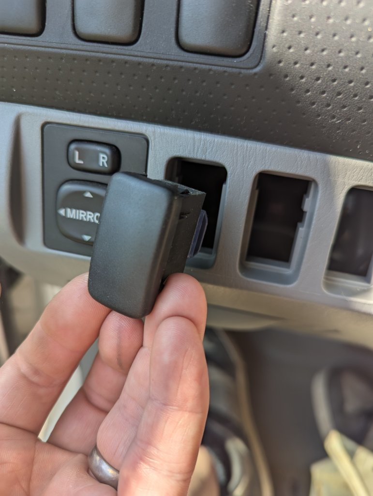

    Poking around at my poverty panel this afternoon and found that one of these button blanks has a wiring harness connected to it?
    No button, no light, but wiring harness? Wtf?

    If I remember correctly, it was either for Traction or DAC. Toyota uses the same wiring harness for multiple configurations. Even though your truck didn't come equipped with the option, the wiring is still there for it.

    Yeah, that's what I guessed. Was still hoping for something more interesting, lol.
    I was mostly struck by the fact that of the three panels I popped out, only one had a wiring harness.

    Think you're right, though which of the 3 spots would have the fog light wiring? Mine wasn't prewired but I think his would have been?

    Fog lights are the row above this, far left button. The only option this truck does have, lol

    I had an 08 Sport. Top row was fog lights, blank (with green harness behind it), Bed AC outlet. Bottom row was blank, clutch start cancel, blank.

    What colors are the wires? I could find what it's for.

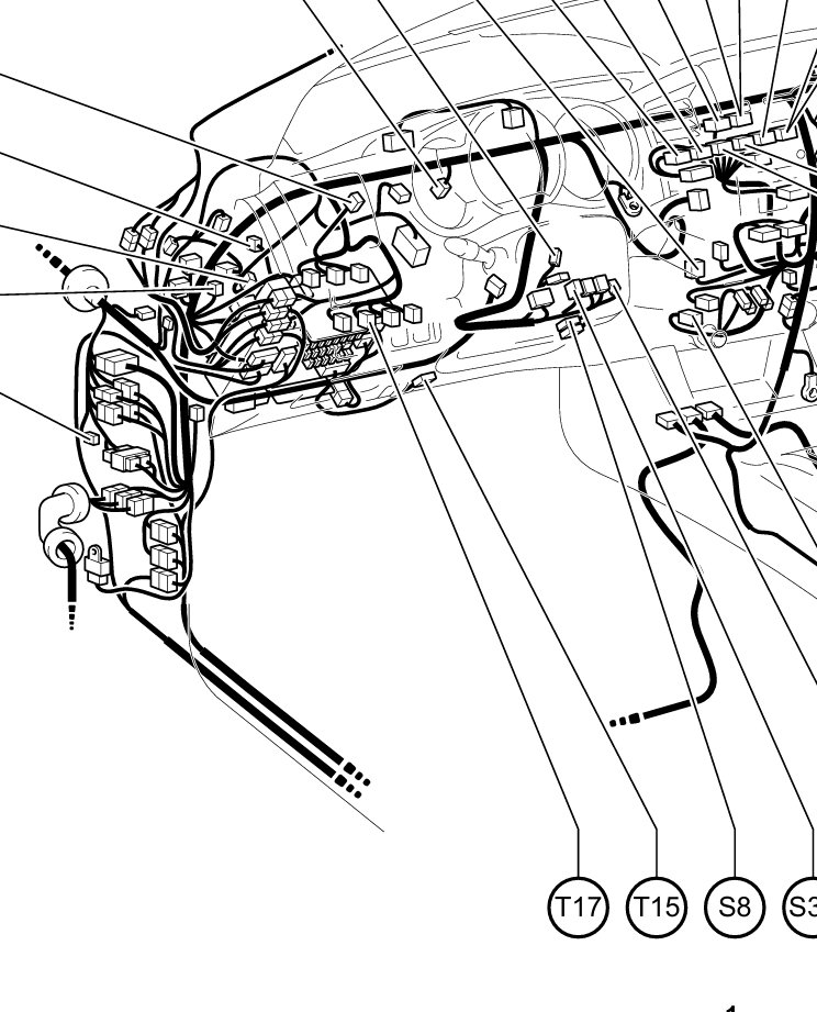

    Looking at this, it looks like "T17" traction control switch.

    The green and green/green white wires are for switch illumination.

    Green, green w/yellow, yellow w/black, orange?red? w/black

    DAC, downhill assist control
