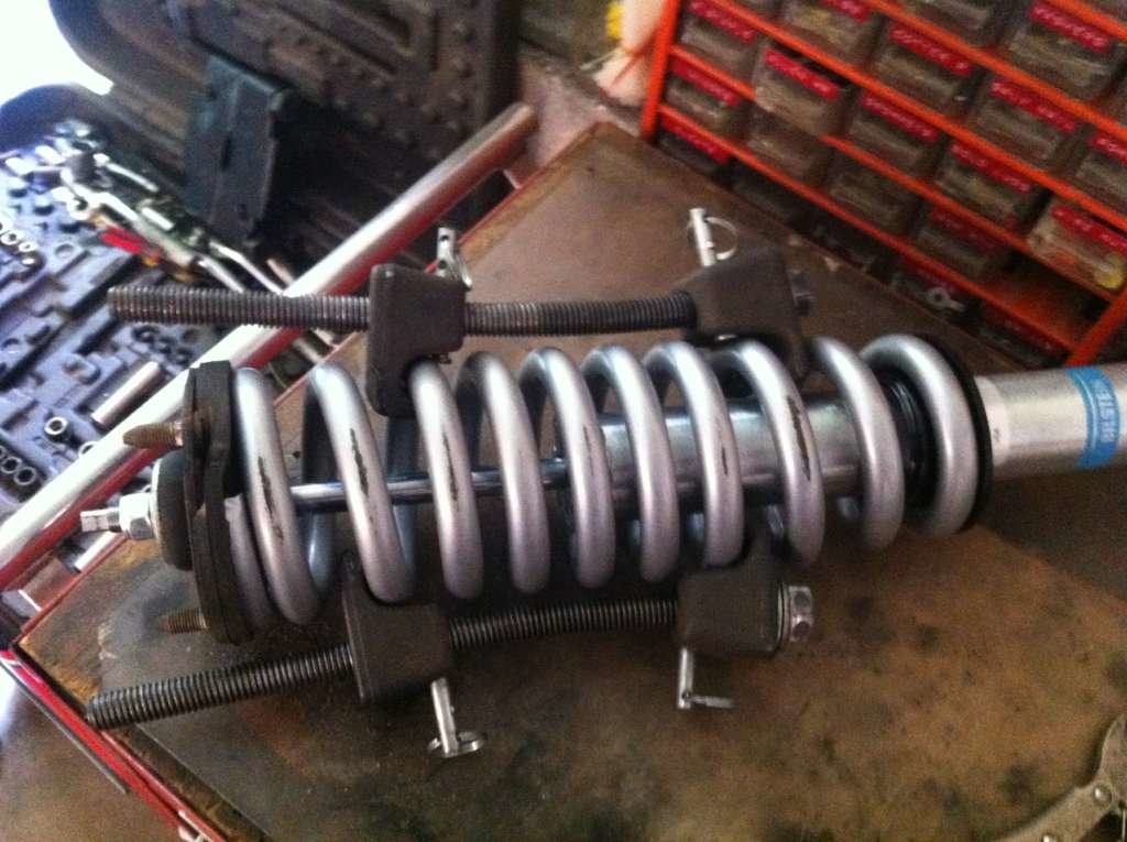

    Mike what does the LCA noise sound like

    I never had any noises. Mine were all rusted to hell so I couldn't get an alignment so I replaced them. The rubber in my bushings was still good when I replace them, everything just rusted together. If your LCA bushings are bad, you'll hear a clunk when you turn or hit a bump because the rubber isn't strong enough to hold. The same noise can happen if you don't tighten the LCA bolts to spec.

    If your LCA bushings are bad your truck will more than likely drift all over the road. Blew them apart on my 95 and driving was " interesting" to say the least.

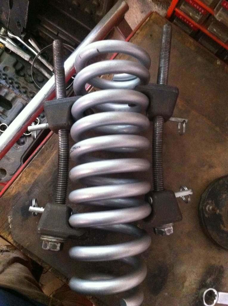

    I beg to differ. I dont think they are stiff at all. John said the same thing that they'd be stiff but they are not. I drive slow lol. should have seen the spring compressor omg both of us stopped and had miguel rent one.

    They are significantly stiffer than stock coils. I noticed a big reduction in brake induced nose dive and it feels a lot more planted in corners. On a washboard or pothole riddled road, they are miserable and feel like they'll rattle the truck apart. For the most part, they're a nice setup but they are stiff. I want to try them with a better shock, I think a shock with better compression dampening would smooth them out.
