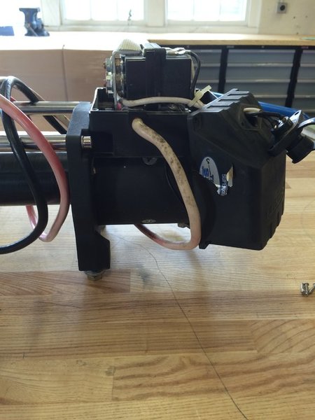

    Theres screws that hold the box and big copper bus bars that connect the solenoid to the winch motor.

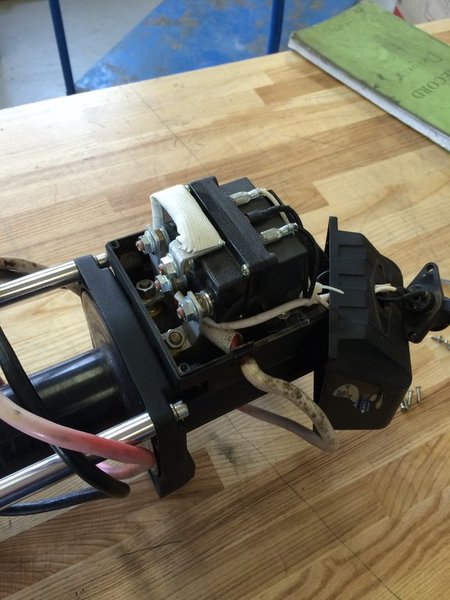

    It barely fit. But yeah now everything is exposed. I have to figure out where i can mount the plug so i can extend the wires to where i need them.

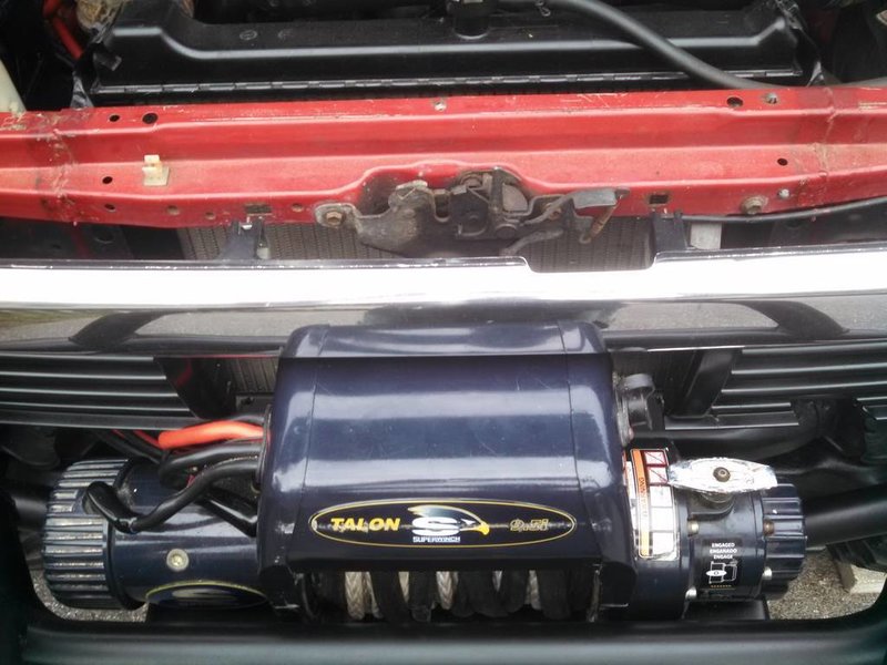

    Put the whole box on top of the bumper.
    Something like this

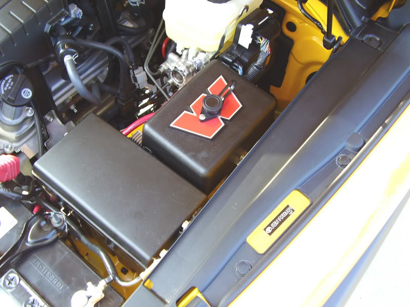

    See if you like the way it looks. If not mount it inside the engine compartment like this FJ

    Mine doesnt look like that. It has solid metal tabs connecting the box to the motor using studs and nuts. There are no wires coming out of the motor, just the box to the battery and to the plug.

    Those are the bars that Erik was talking about. Erik, John or Denis one of you want to explain this better

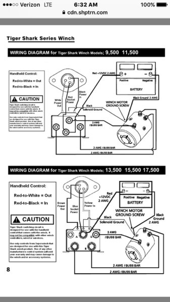

    image.jpg So here's the wiring diagram for your winch . You need to get some 2awg wire and replace the wires going from the inside of the control box to the winch . You can leave the plug on the box . And when you need to use the winch pop the hood ,plug it in close the hood . Or buy a in cab controls and use those .
