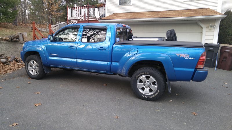

    I didn't mess with an AAL because I had a 3-year-old 3-leaf pack at the time. So I did General HD leafs and OME 884s with 5100s all around.
    I wish I had a bit more rake. It's too close to level, so when I put a 500 lb lawn tractor in the bed with the back wheels on the tailgate and it was enough to make it very slightly nose-high. I've thought about going with Dakars minus a leaf or Wheeler's 5-packs. I think those would get me another 1/2-3/4 of an inch in the back.
    This is an old picture, but shows the height well:
