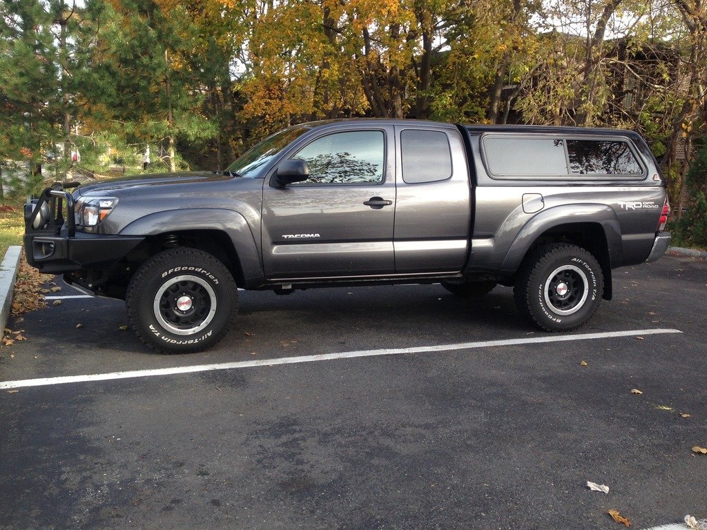

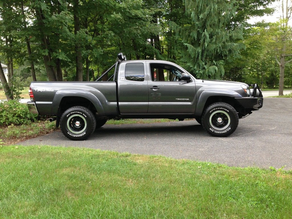

    Just look at my numbers then...you will have more height in the rear than those numbers if you keep the overload since you don't have any rear weight in the bed. Yes, the ARB dropped me down a bit in the front, but you might still end up with a rake depending on what happens.
    Updated with piktors.
    That's on a downhill slope.
    With the cap for some added weight. Sadly, this is the only photo I have of it with the cap on, surprisingly.

    My front numbers are low since that's with the ARB.
    I gained almost 3-3.5" of lift without the overload. The overload is probably 1/4" thick. Assuming you get the full 2.45" and added the 3/8 spacer, you're at what, 2.825"...the 3/4" is probably going to be right where you will be.

    Sounds good to me, hopefully it all works out. Also, sick looking truck. If I didn't use my truck bed to haul things from time to time, I would leave out the overload. The way your truck sat with the cap is my ideal look.
