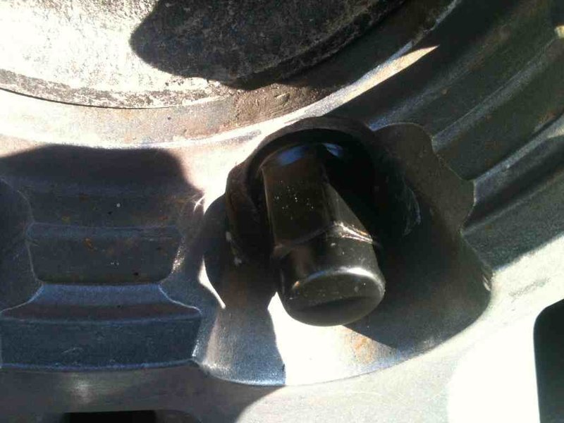

    Ive had a jeep and had the wheel fall off from a issue like this Im NUTS EVER SINCE

    you definitely need an acorn style lug nut, after seeing the wheels it's perfectly clear the ones with the washers will not work. the holes in the wheel are tapered. You need something like these-

    Dave do you have a pic up close of where the lug will go but without the lug in the shot to see the contact area. Is the contact area flat or beveled

    OK, experience talking here....Do they even come close with the washers ??? If you take a small wire brush attached to a drill and clean up each hole will it work ??
    When I mounted the '09 wheels it took more finesse because they are aligned by the lug nut more than my '02 wheels were....that is not your issue,correct???

    This is why I asked about the wheel to lug contact area does it need a beveled lug or does it need the flat washer with the lug protruding thru the wheel to center the wheel

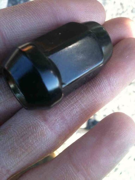

    Mike from worchester was right
    And they fit in the cone 60*

    Yup I went to Zekes custom wheels per many shops recommendations. And he saw the issue right away. Toyota doesn't sell the lug I need. Nor do many shops with packaged lugs in sets if 20 when I would need two packs and only need 4 from the pack lol. I paid $25. Now to get my money back.
