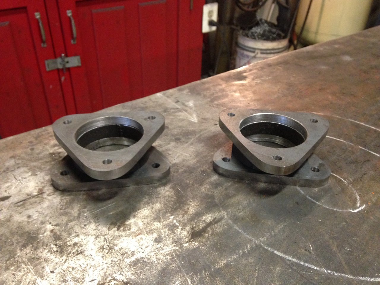

    I agree. If it's just cosmetic there's nothing wrong with the spacers. I put in spacers when I first got the truck because I had no intention on wheeling it. ( I'm saying "had" ). Now I'm trying to decide which way to go with a legit lift. The spacers worked fine. The truck lined up just fine. I only lost a little caster because I still have stock UCA's. Truck drives fine though. I actually fabricated my front spacers.
    It's definitely the quickest and cheapest way.

    Spacers were 1-1/4" tall, so about 2-1/2"~3" up front. Truck goes straight and true. I had it aligned right away. The tech got a little bit of caster back. It's was just on the "minimal" border of the spec. I get no wobble at all. I did notice though that if I'm a road with a high center crown, as I travel over the crown, say changing lanes, the truck does react a little more. You can feel it track to the side little more than it used to. But, def not bad at all. The new wheels with the greater offset don't help that either.
