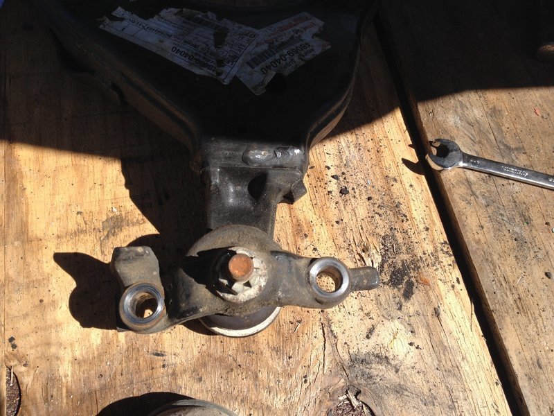

    I don’t see a cotter pin. Other than that idk unless the left end is the steering stop and it’s installed on the wrong side?
    Iv never touched a second gen so idk.
    Found this...

    I never noticed the cotter pin missing... Jesus.

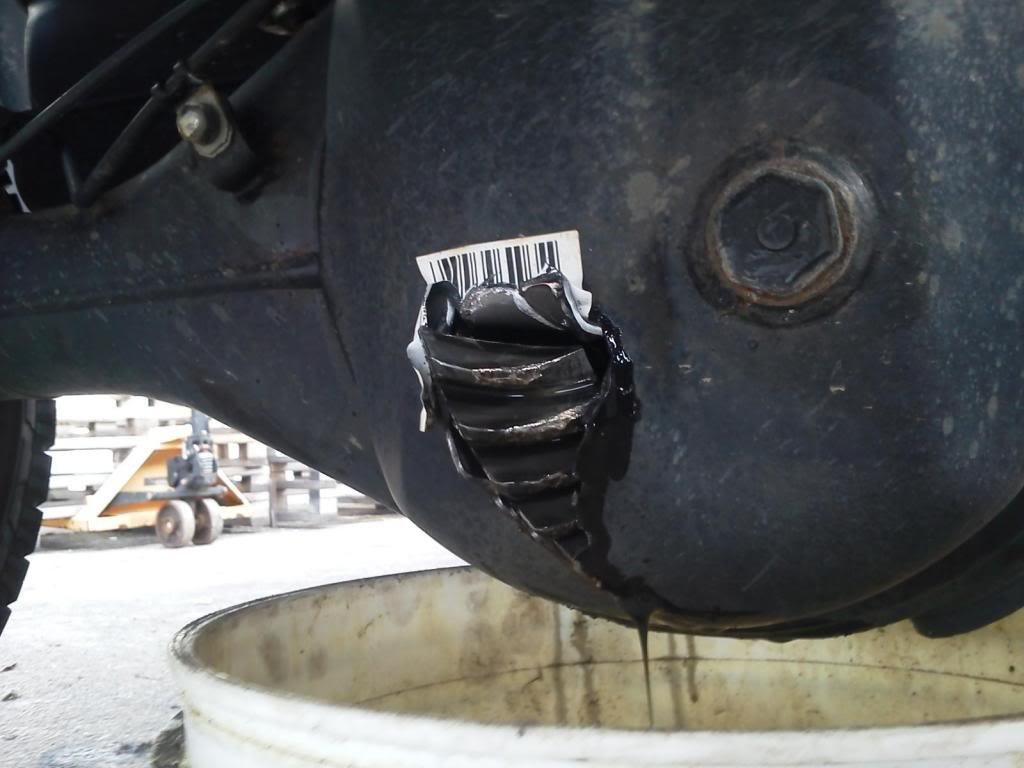

    You got it! They put the left steering stop on the right and the right on the left. Now my rack is jacked... They also half assed the routing of the front diff actuator breather tube so it was rubbing on the ac compressor. Put a hole in it which let a lot of water in and fried the motor. (Luckily Amazon sells the dc motor) I know it was them because of all the zip ties used to resecure it. Their service has taken a turn. I’d trust them to give me an alignment though. That’s about it however. Since the frame replacement I keep finding little hidden gems. Too much to list...
    There’s my diff!!! :rofl:

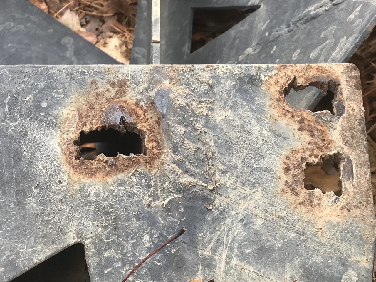

    Here are the holes on my bumper they “elongated” to get it to “fit”. Even though I can tell from measuring that they didn’t need to do that. They also stripped every mounting bolt in the process... now I have 4 of 6 bolts holding it on. Won’t be hard to plug and recut the holes. Just annoying that I have to fix it.
