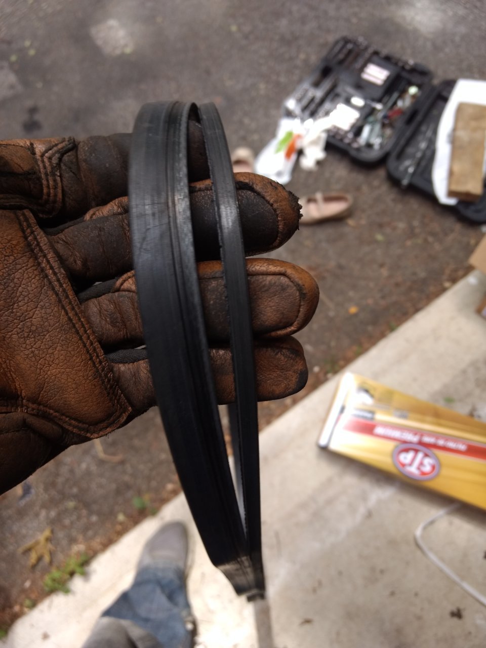

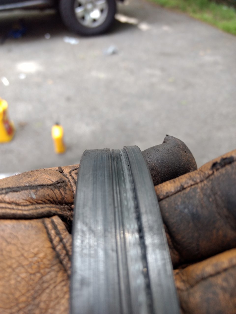

    Pro tip: if you ever do anything involving your serpentine belt double check you've routed it correctly.....
    About 1-2 months ago I replaced my alternator. Went to change my oil yesterday and noticed the belt looked weird. Looking closer it had a nice groove worn into the topside down to the steel wire. First thought was shit one of the pullys is messed up. Upon further inspection I didn't route the belt under the idler between the water pump and alt. It was over it completely bypassing the idler....smart. the belt had been rubbing on a casting for the water pump off the block for about 5k miles and was basically split into 2. Fortunately it didn't break while driving..
    Easy job to replace except I'm short and have to use a stool which makes it more akward to do. Then again pretty much anything besides changing oil requires me to use a stool to access the engine bay.IMG_20180610_142343220.jpg IMG_20180610_142350481.jpg

    Haha. I feel like I am completely capable of that. I mean literally the belt routing diagram is on a sticker in the engine bay, how much easier can they make it....
    That's what happens when you rush. I did paint pen the bolts on the alt so at least I know those are good.
