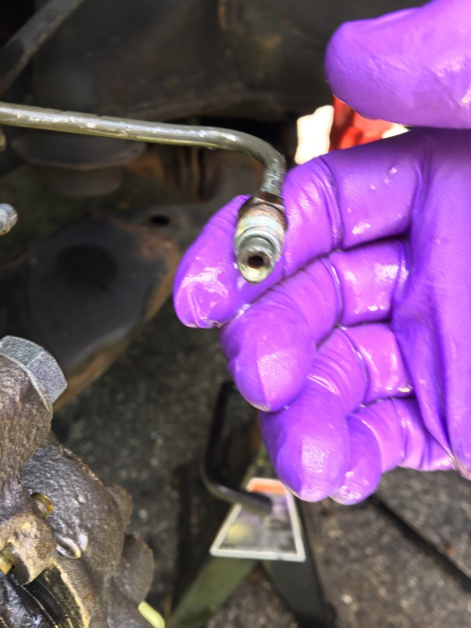

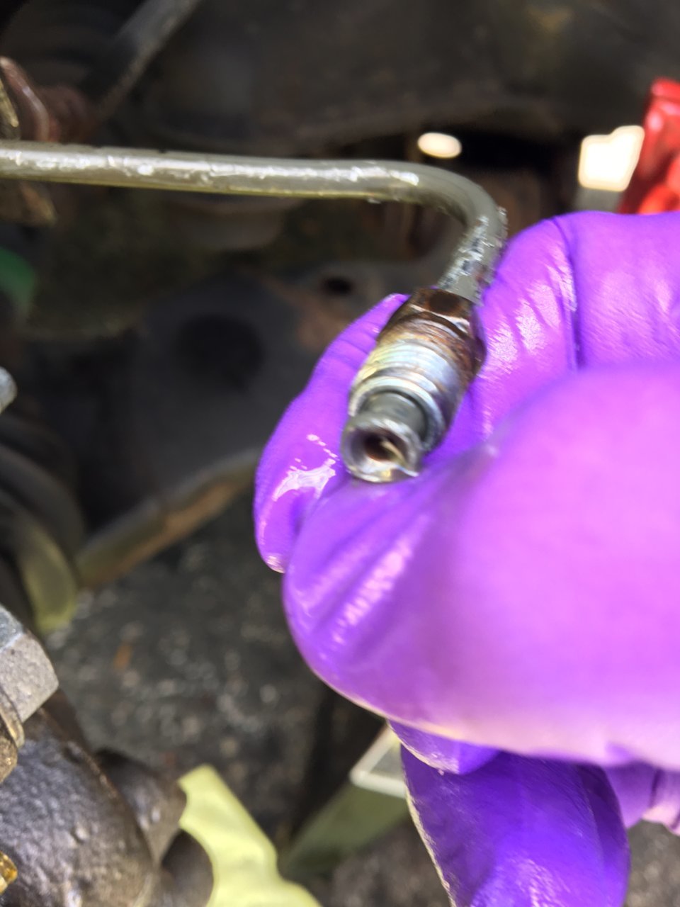

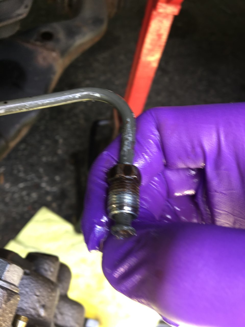

    It looks like it would go that way
    I think i see the domed end down in the caliper i removed...I am wonder what the heck this part number is...

    I think I'm a goober here I just looked in the other caliper and it looks like the piece is already in there so it must've just fallen out of the AUtozone caliper

    See if you pull the old one out of the caliber you replacing.

    Even better, that piece I had just fell out of the threaded hole on the new caliper. :) It's all together now and NO LEAKS YET :) :) :)

    It's all set that actually goes inside the threaded hole on the caliper where the stainless steel brake line connects. It's the mating piece for the flared break line end.
