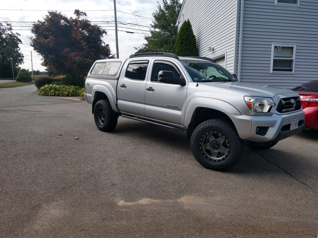

    Truck looks totally different. Love the new look. How was the ride with the new Falkens? Balanced out nice?

    Perfection! So you're buying a set right so we can match?

    Might as well.....lol. Just bought new tires to replace the new tires that are on the truck now. May as well get rims too. I mentioned it to the wife and one eyeball popped out of her head. “What?????” , “you’re playing, right? ..... RIGHT ?????” Haha, just kidding. I really like my Fuel Wheels. But I have to admit, I think the grey matches my truck better. It’s got me thinking to re-shoot the dark bronze portion with grey, maybe like gunmetal grey.

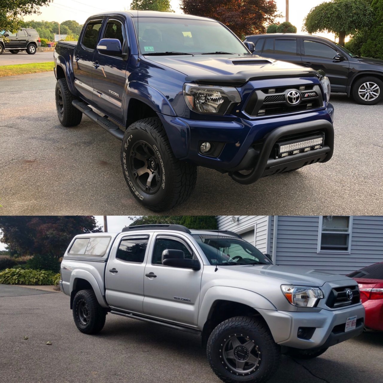

    And I thought we would be twins :(

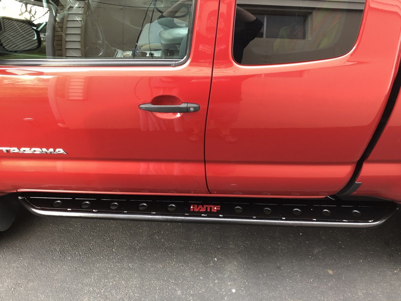

    I love the looks of those sliders!

    Can barely tell them apart :notsure:
