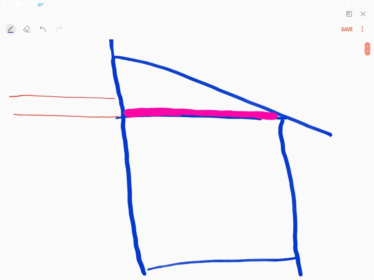

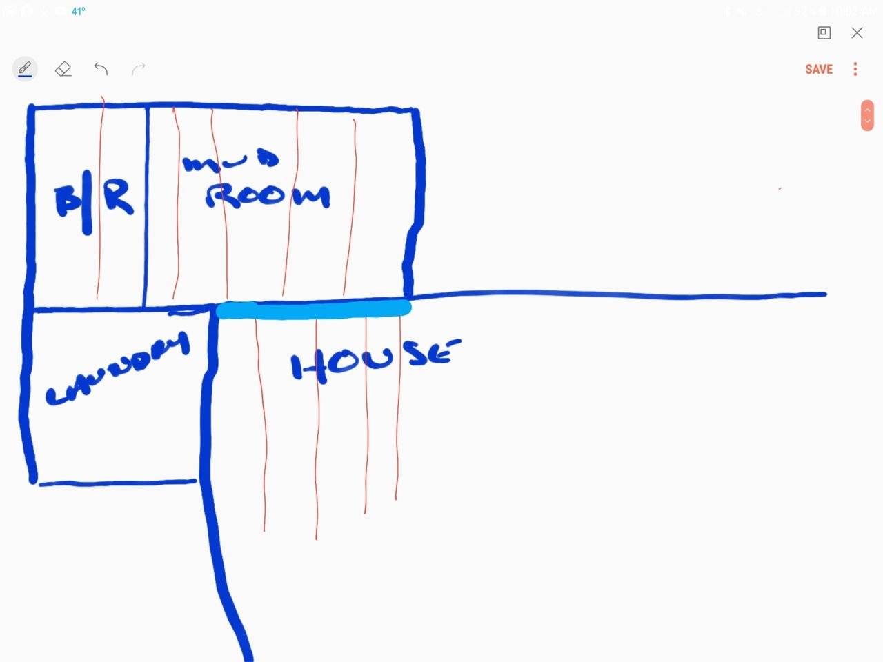

    Since I am sitting here, being useless....
    @Pugga
    To kind of give you an idea...
    So the area im looking to spray next, is about 200 sqft.
    Its a low pitch, multi angle roof, and no way to insulate it well, and allow it to breath, other than foam. Thus, i dropped the ceilings to 8ft, and added r15 batts above. Better than nothing....
    However, being an old balloon frame, the floor joists under my room in particular, have uncoditioned air in them, as theyre above the insulation.
    It took 2 years to get here, as i did a BOATLOAD of research insulating. Old drafty houses in particular.
    In this case, insulating the bottom of the roof deck, allows me to insulate ABOVE as well.
    But, it creates that air seal, and will definitely provide much better r value than my crappy batt job.
    Excuse my crappy rendering....
    But, the pitch in my drawing is more aggressive than it really is.....
    None of this is final. Its first pieces of a puzzle, to get the most out of the house, and not create headaches.
    I am not a GC. I dont do residential work(except my own).
    And I am learning a lot of this as I go. So, I stop, research, etc.

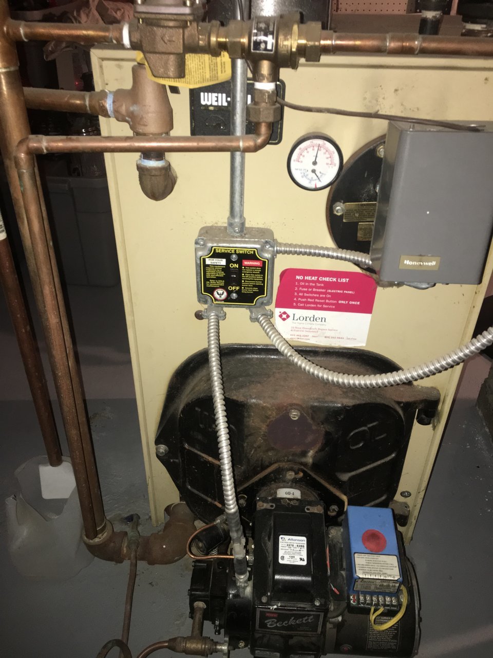

    Do me a favor, take a picture of the business side of your boiler.
    In particular, the gauge.
    Bet you have a triple, and, it will never let the boiler get below a certain temp
    Oh, I can do much worse....:D:D

    Boiler

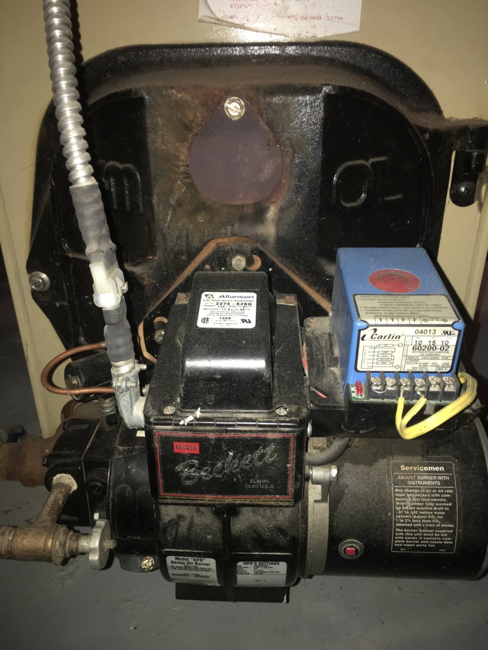

    On your burner, you have 2 resets. 1 on the burner motor, and the other, is the red button on the primary control(blue box).
    Never hit it more than one time. Period.
    Second, if it is firing, dont hit it.
    Looks like a honeywell triple acting aquastat. It will maintain a minimum boiler temp. If you open it, it should have 3 dials.
    As long as the boiler is getting hot, that is working, as is you burner.
    So, your issue could be either the stat, or the circ pump. Or the relay in the aquastat...
