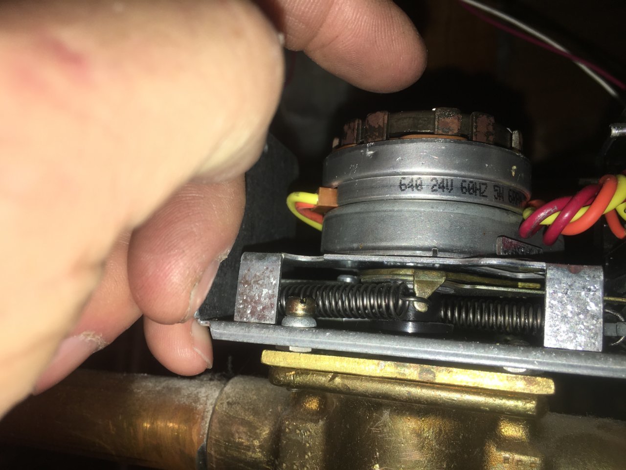

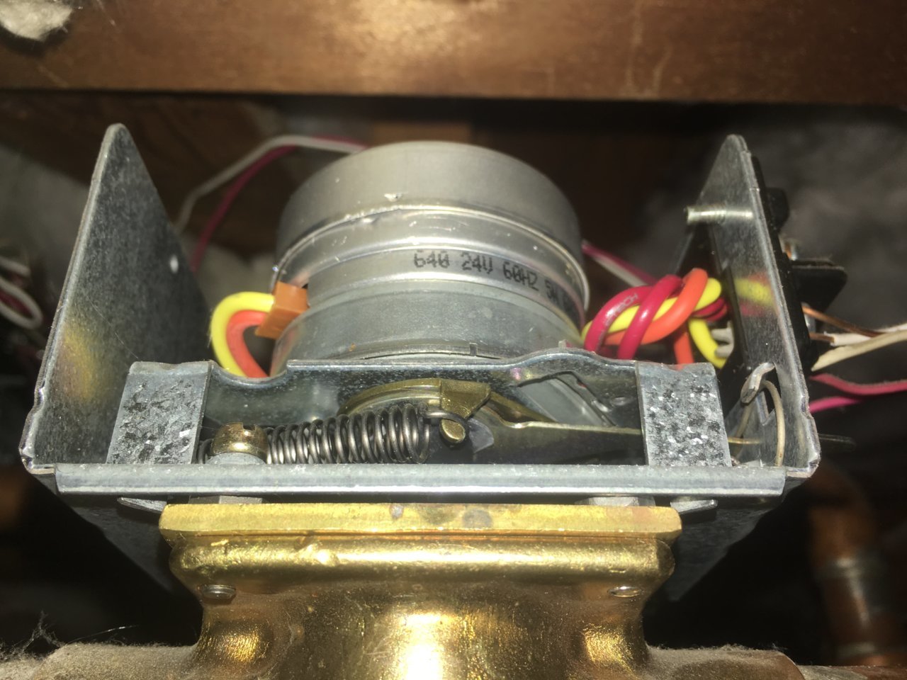

    The leaking valve is working ( but yes it leaks) thanks
    So Pugga and chase,

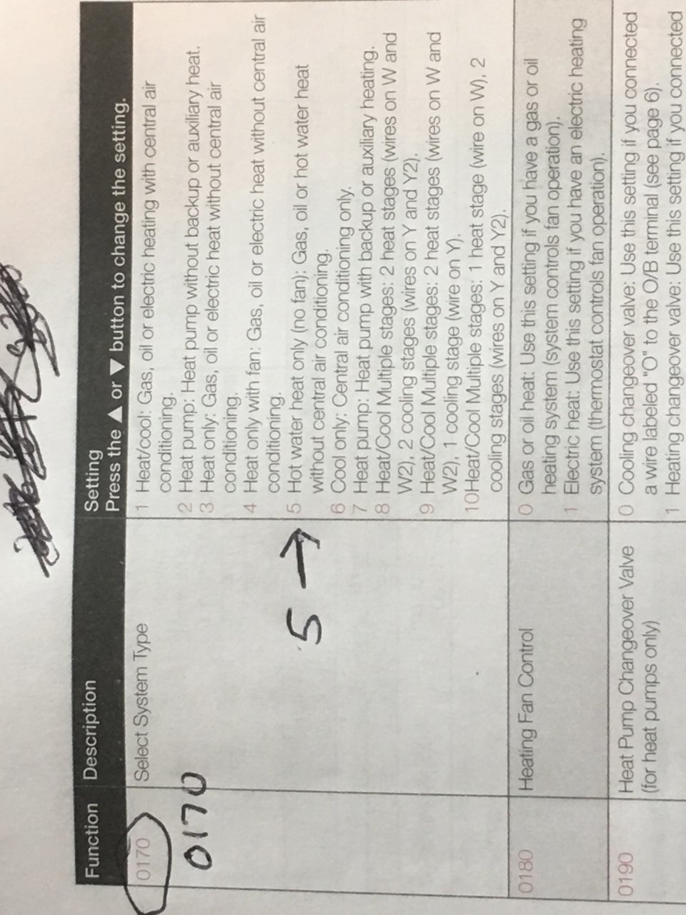

    I think I figure out my issues or issues with heat. I stepped back and really thought my install out. Turns out I didn’t set system program out at all correctly.
    I had it set for Hot water heater, gas or oil with fan and high-efficiency above 90%.
    My system runs at about 86% with no fan.
    So I carefully reread programming chart and was very much upset at myself for being little careless. I uploaded three pictures for my examples ( valve and program chart).
    I then went downstairs to check on valve not working. As I think I mentioned, I manually moved it and it seemed to work, but not for long. I then removed cover to valve for a look. I checked for anything broken ,springs etc ., nothing. I then removed the round cap to look even further. I nudged the wheel or whatever it is on top and moved freely by itself ( sounded like gears), and when it stopped furnace kicked on an hot water moved right on through the lines. I turned temp up to see reaction and it turned right on again and steadily increased temp by running about five minutes at a time till satisfied.
    I think while I was trying to move that switch I was gripping that cover and ended up pushing the cap too tight onto the gear making it unable to move freely.
    Aside from keeping an eye on it ( I dropped the set temperature and it reacted and then I raised it again and it reacted so seems really good )
    Do you have any suggestions?

    Oh the pictures
    Suggestions on valves?
    Keep an eye on the leaker or replace( gonna buy part to have it handy)
    And the valve I have just made work?
    I DO NOT want to assume that I corrected that one , but having at least one replacement will be handy

    Sounds like you got it sorted out, good job!

    The valve that's leaking, just keep an eye on it. If it's just a very slow weep, I'd leave it be. That valve will not be fun to replace, you'd have to drain down the entire system and go through the refill and bleeding process (not terrible, but time consuming and will require you to sweat on a new valve).
