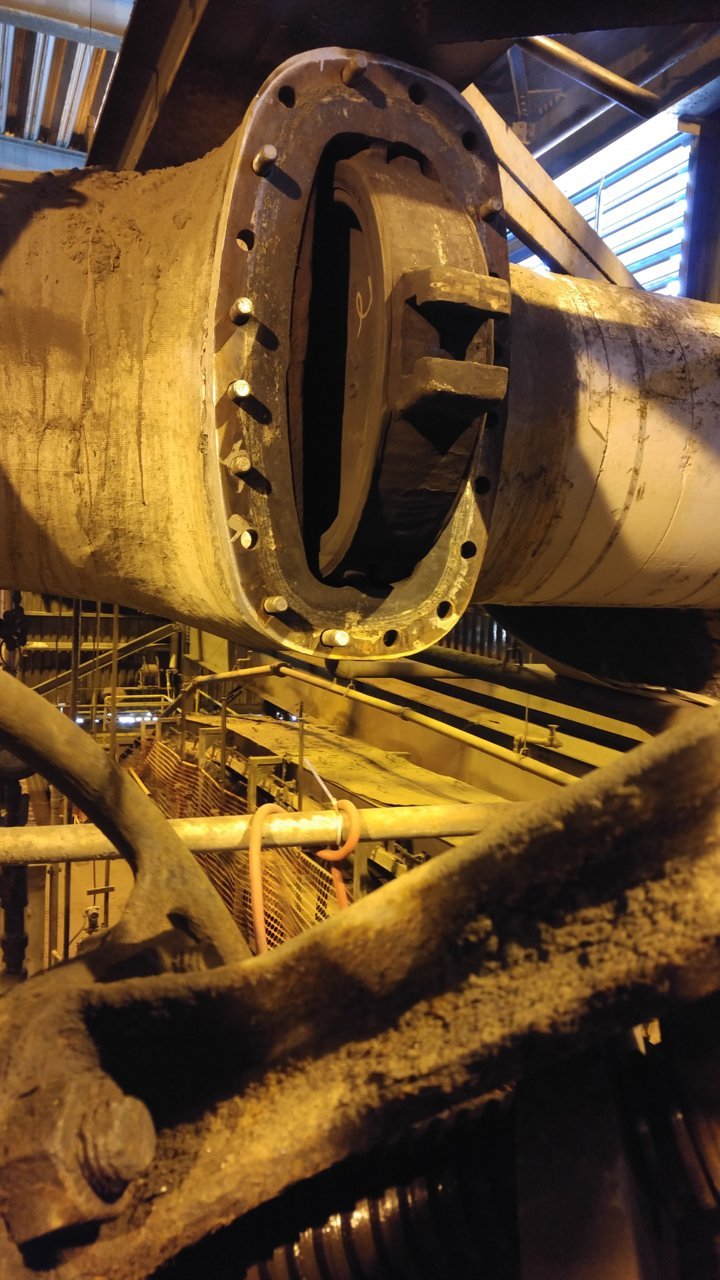

    Valve work, good stuff. I use to fix them for power plants

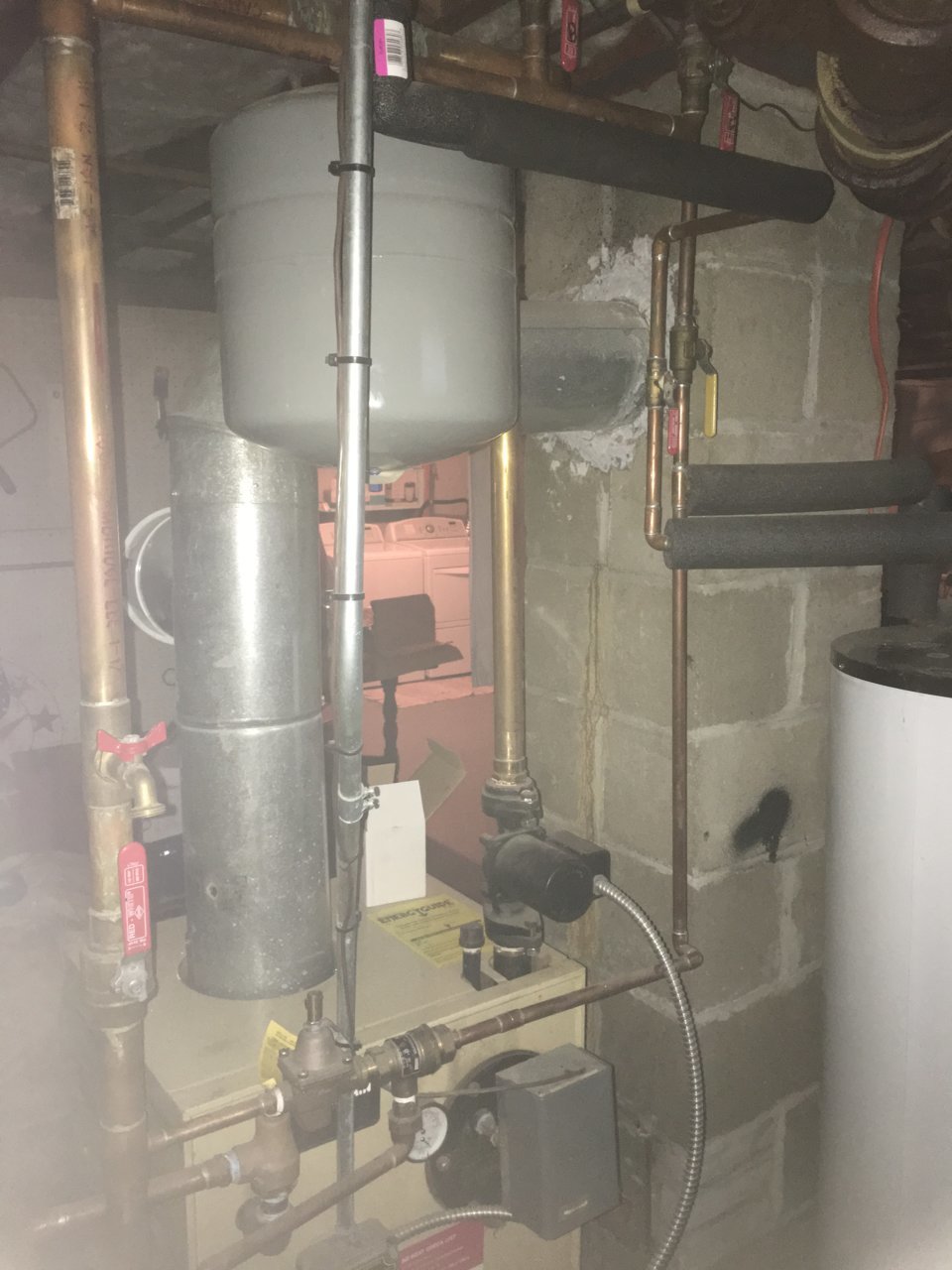

    Valves are close to boiler and overhead
    First floor has two sections on that zone( front and back of house) upstairs zone is all by itself.
    Motor is easily removed and four screws underneath remove guts. Will get water if I open that up.
    Second pic not that great but the valves are behind and to the left of expansion tank and overhead like I mentioned
    Two shutoff valves for first are to the right
