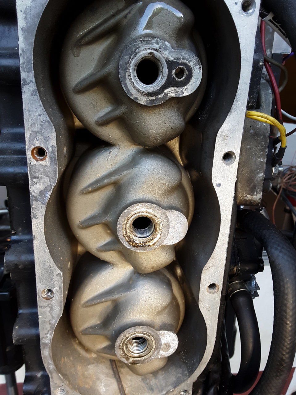

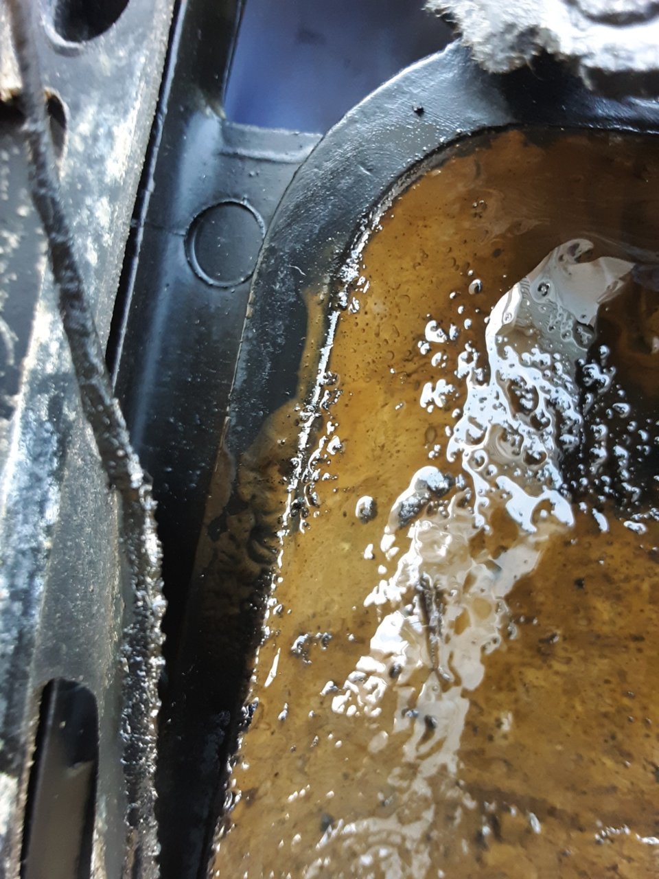

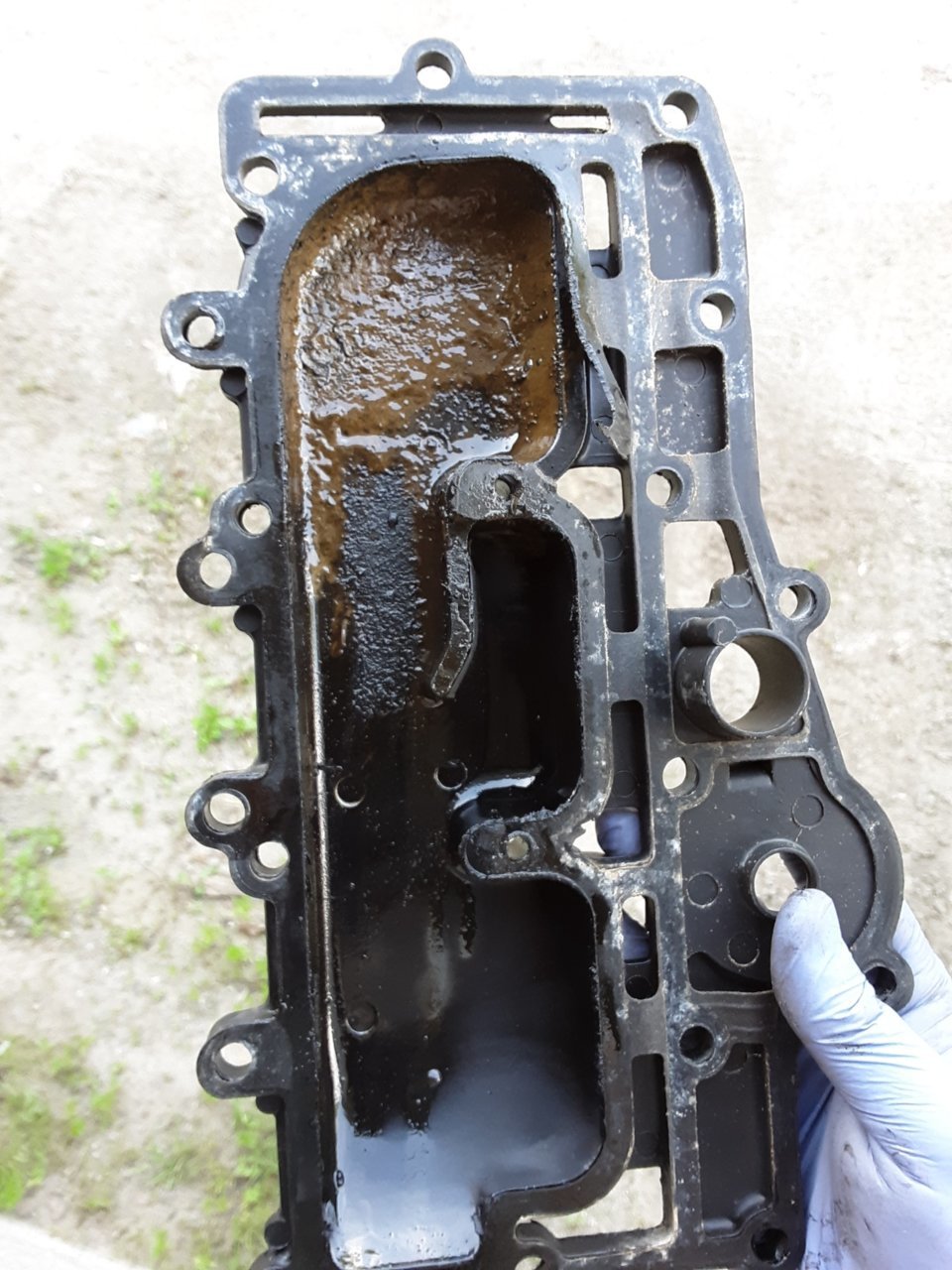

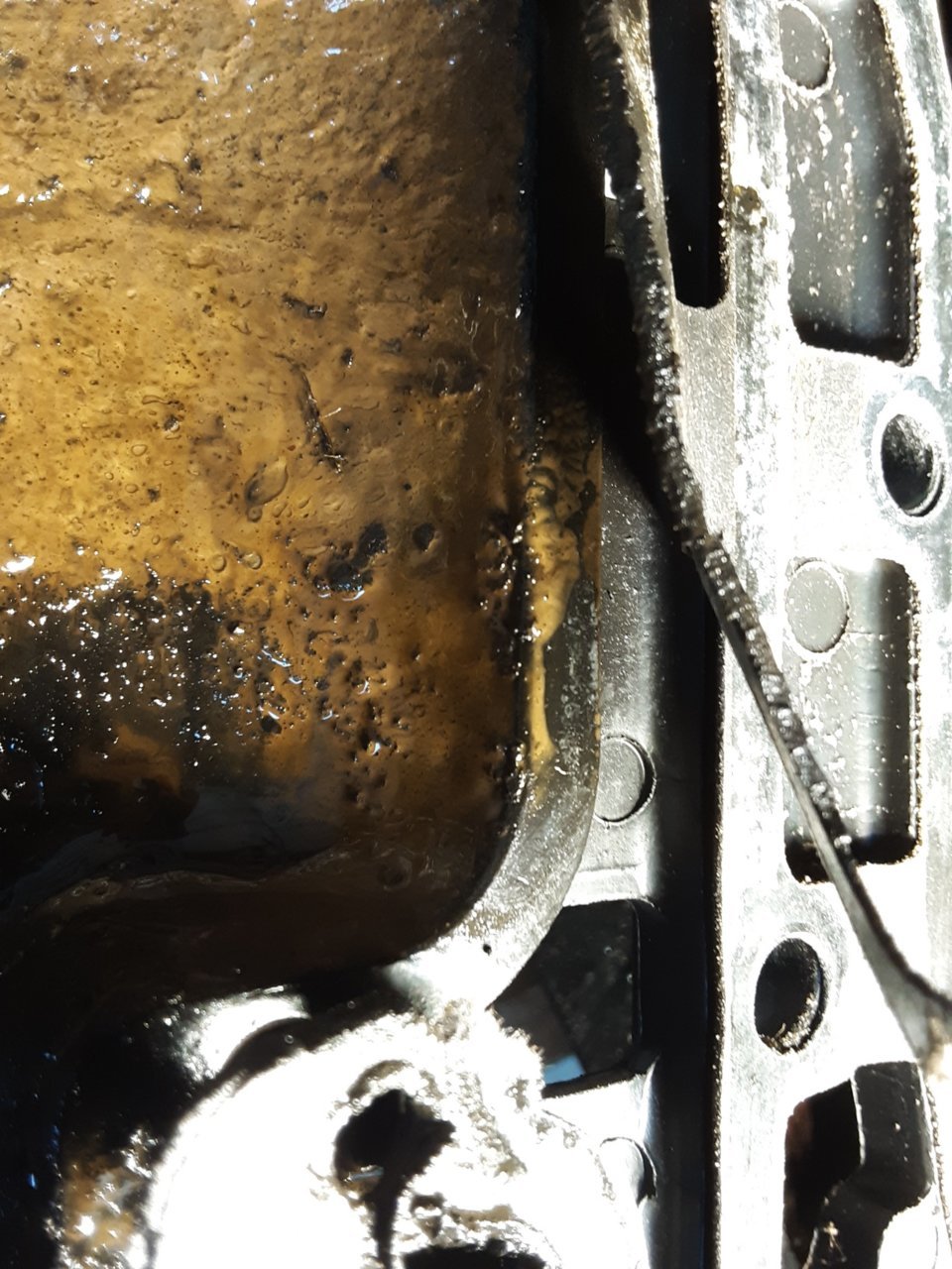

    So I think I found the source of that misfire on the outboard that I was talking about, @jethro
    Pulled the plugs this weekend and the top one was covered with the grey sludge of doom. Did some research online and apparently the exhaust gaskets are prone to failure on these motors. The other alternative is a cracked cylinder, but I've got good compression and I pulled the rear water jacket cover off the motor, went over it with bright light and inspection mirror and can't find any cracks in the jug.
    I did, however, find this when I pulled the exhaust plates:
    I cleaned the plate up with some carb cleaner and a brush, and can't find any defects in the plate itself, so hopefully it was just this bad spot on the gasket letting water in and boogering the plug.

    I'll bet that's exactly what it was. New gasket time and you may be good! Compression test would tell you if you had a cracked jug for sure.
