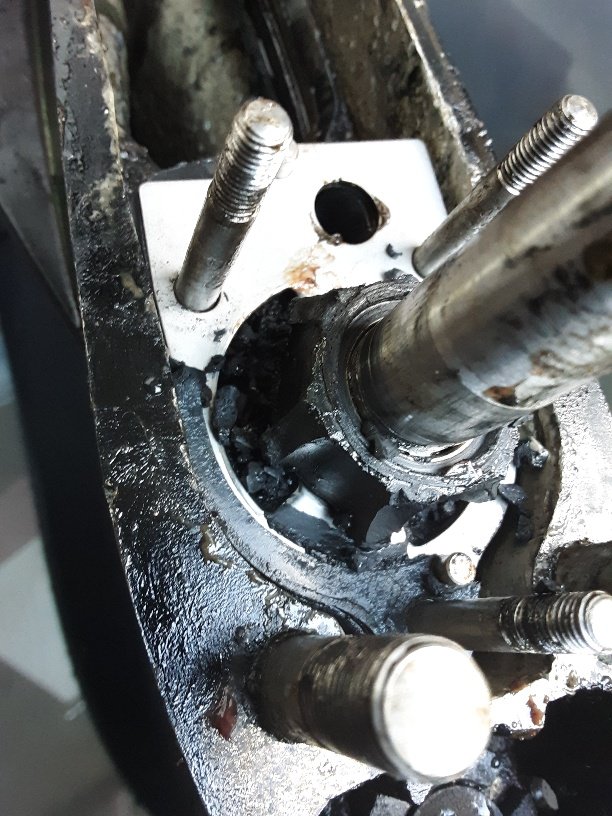

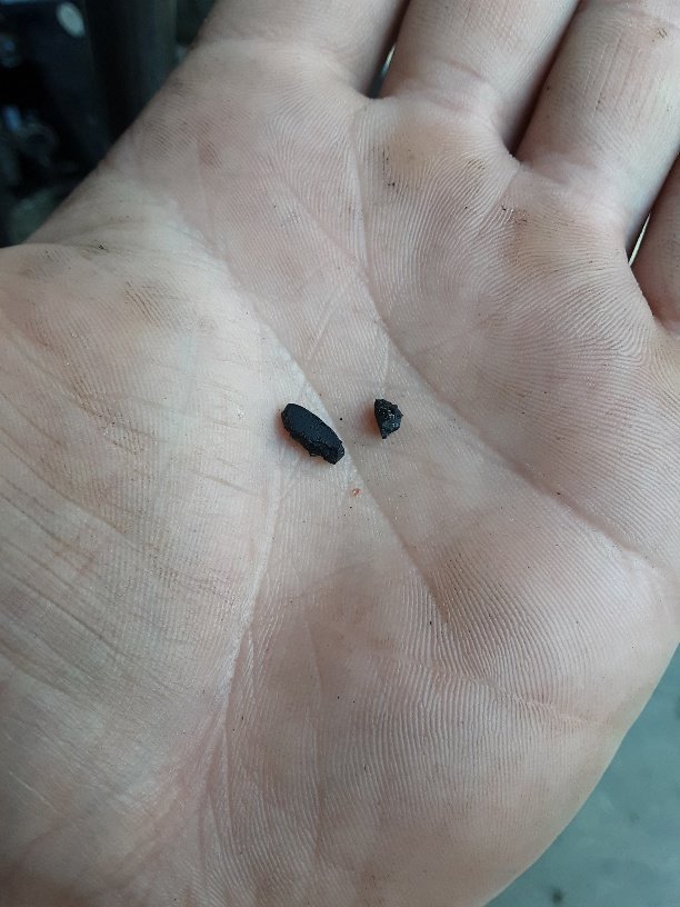

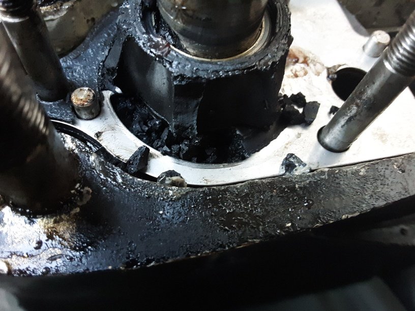

    @jethro, how normal is this?
    Took the boat out on the lake over the weekend, just putzing along fishing, when the overheat alarm went off. Switched it off, let it cool down, and when I started it up I noticed that the tell-tale wasn't peeing. Dropped the lower unit last night and was greeted by an impeller that apparently ate itself, and the pump channels stuffed completely full of rubber. Backflushed the motor and got a few small pieces, but it looks like nearly everything got jammed up in the pump itself.
    I just replaced the damn thing this spring, when I had the motor apart looking for that water leak. I made sure to arrange the vanes correctly when I installed it, and gave it a dose of dish soap before I reassembled everything, and it's worked fine ever since the install (until last night). I wonder if I picked up some sand at some point and didn't realize it? The water around our dock is fairly shallow, but I didn't think it was that shallow :laugh:

    Wow, that seriously sucks. I'd be really concerned about rubber still stuck in the water jacket and I might even take it apart. Did you grease the impeller before install? You should coat the bottom of the impeller with marine grease like Mercury 2-4-C where it contacts the wear plate and inside the water pump housing as well. Lots of the highest quality marine grease you can get. I'd never use anything other than OMC or the 2-4-C.
    What does the inside of the pump housing look like? Is it a new one that came with your impeller? (It should be).
    Also, did you replace the thermostat(s)? That should be done every time you do the impeller, and if you run the salt, that should be done every year. They are usually cheap but they get severely corroded in salt water even if you flush regularly.

    What is your outboard again?
