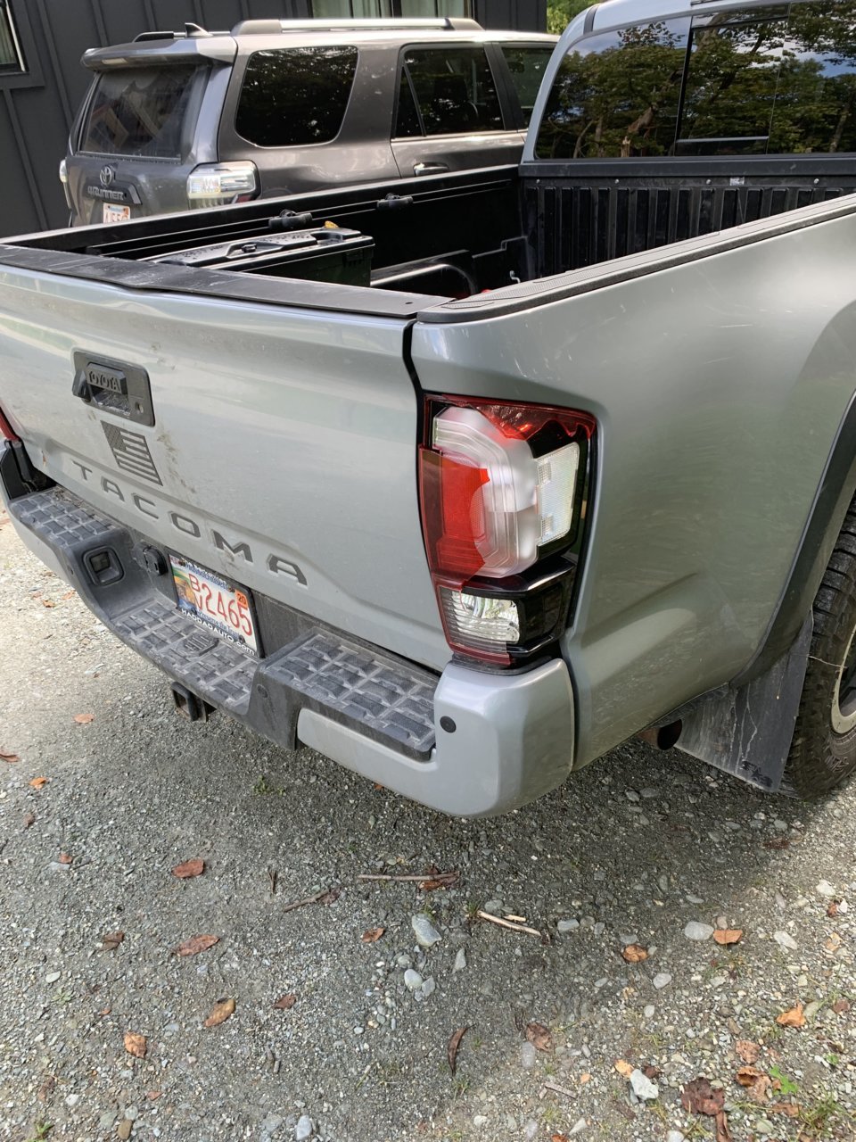

    So did this two days ago when bringing supplies to make steps into woods. Mirrors were folded and my back up sensors didn’t work, neither did my eyes :rofl:

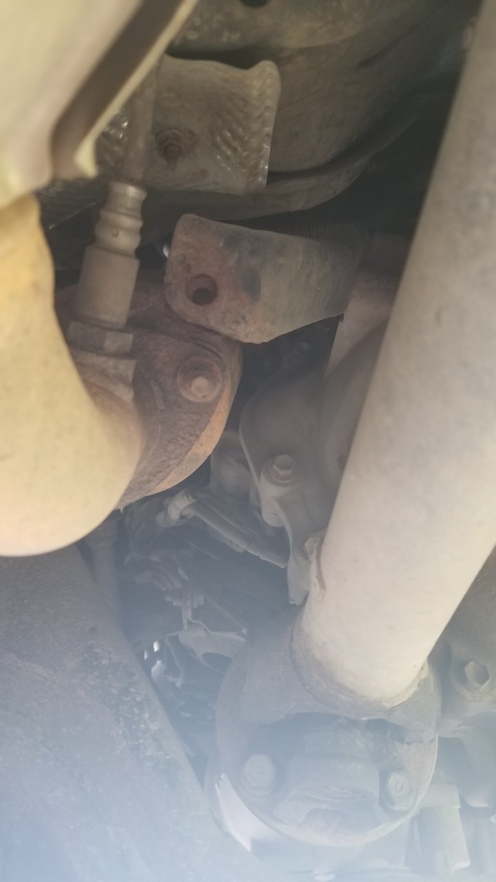

    Anyone happen to know the size of the bolt that secures the back of the driver side exhaust manifold to this bracket? I noticed that I was missing it last night when I took my skid plates off and I think it could be the source of a rattle I have that sounds like a loose heat shield.

    It's probably a 14mm head, as far as thread size goes I'm not sure, maybe m10 or m8?

    That'll help me with a place to start trying, Thanks, Drew.

    If I had to take a guess, M8x1.25 or M10x1.25. It looks like a bolt hasn't been in there awhile, you might want to clean out the threads with a tap.

    That's step 1. I might try to yank the bolt out of the passenger side and match it, but I'm afraid it might be rusted solid in there. I have what I think is the right P/N (90119A0145) if anyone has a way to find out what size it is from that, none of the online parts departments have yielded anything useful that I've found.

    I just went to google and eBay, and I couldn't find a size for that bolt from the part number (it does fit a Sienna exhaust, for whatever that's worth). But if you have both of those tap sizes I mentioned, one of them should thread right in, and then you will know what bolt you need.
    If not, taking the bolt out from the other side shouldn't be too difficult, as I was able to take out the header bolts on my '05, and they looked like they were on the Titanic!

    Thanks, I'm pretty sure I have both taps and bolts are cheap at HD or Fastenal
