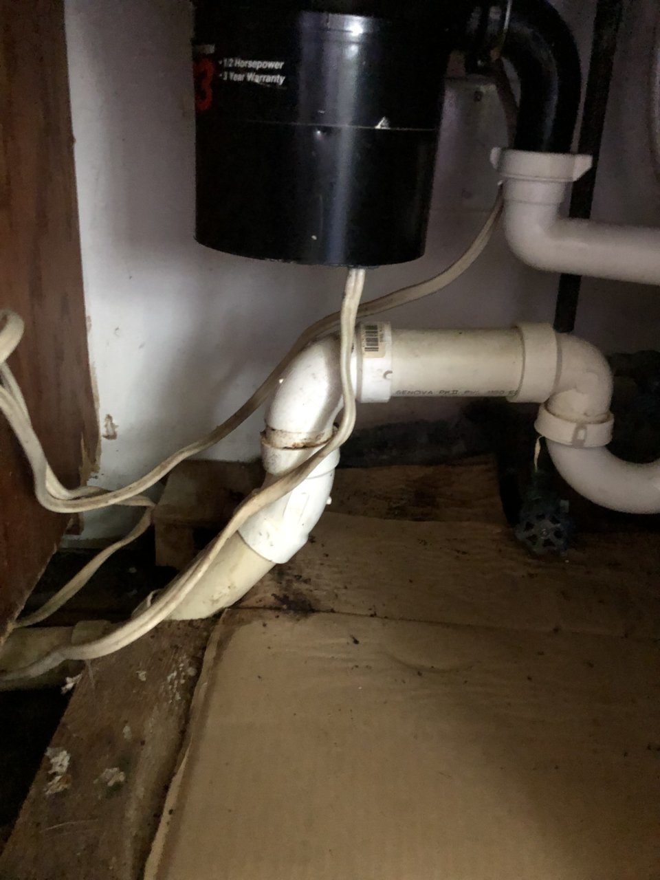

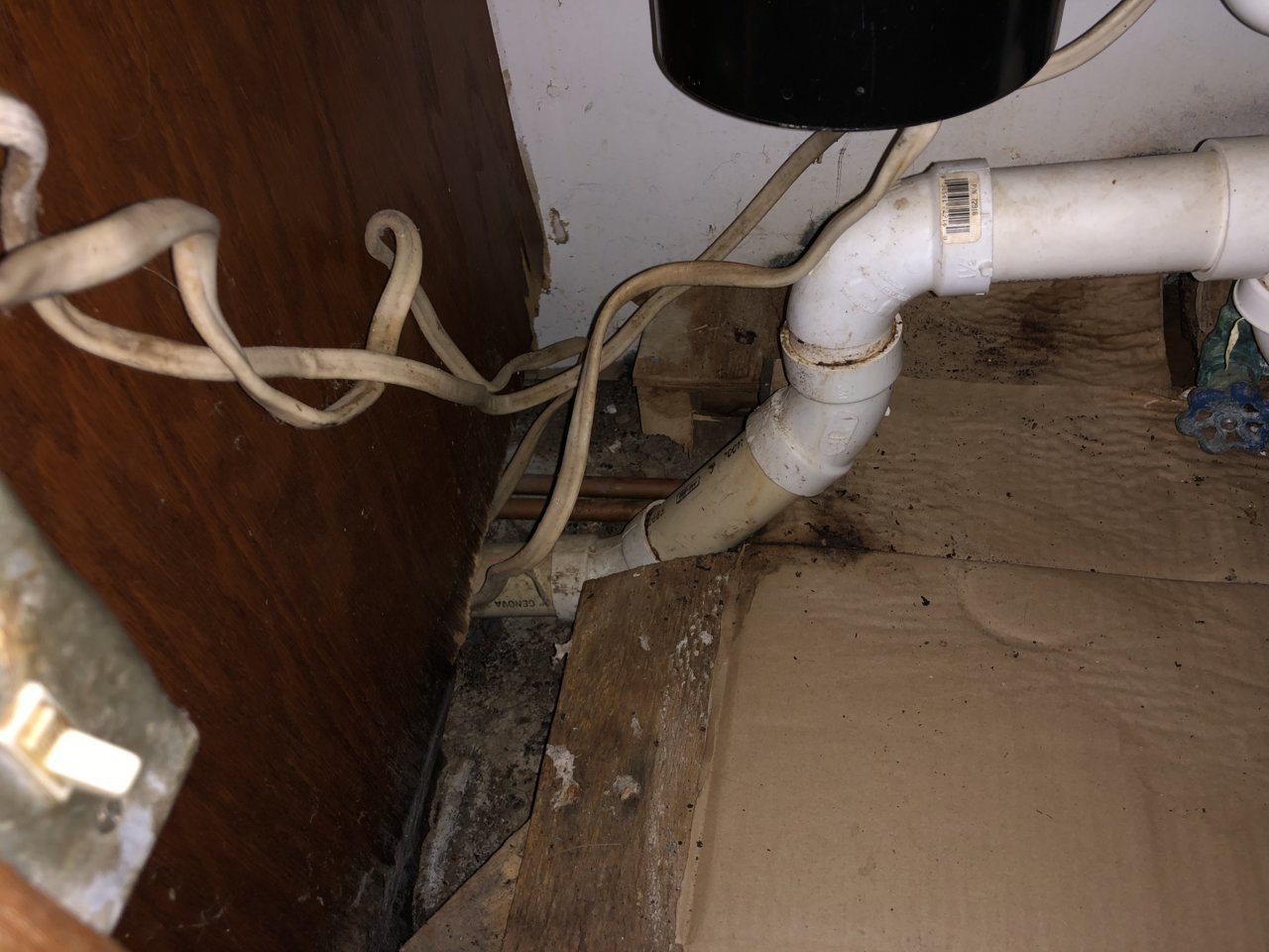

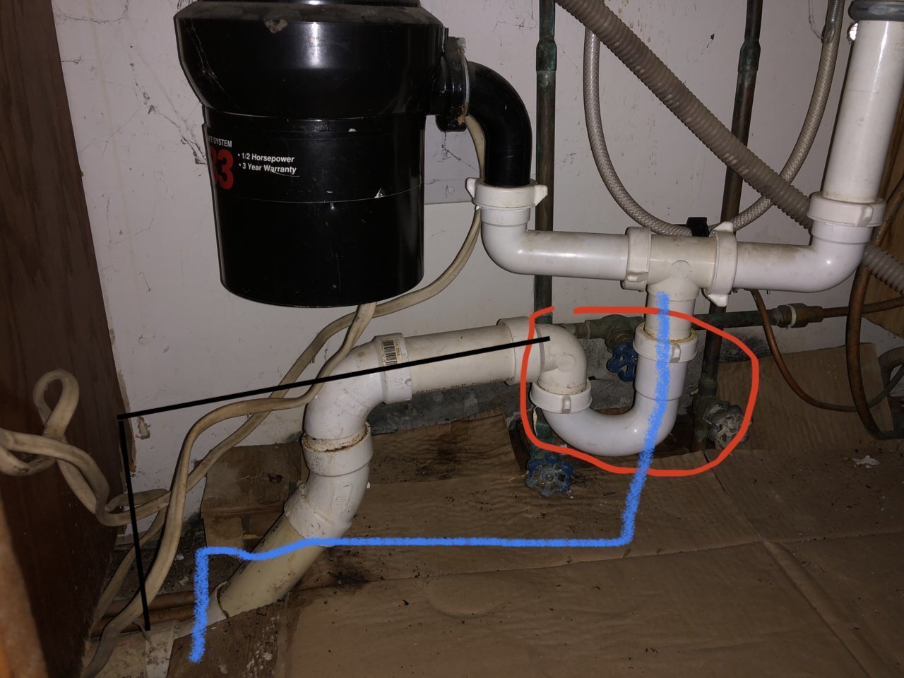

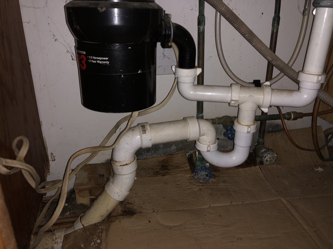

    Black line

    So you're trying to turn the S into a P trap. That pipe connection in the floor looks like it will be a hard joint to make up.

    so you think, keeping the same lay out, just solve the "F"ed up part

    I see what your saying, I had it in my head, the loop down was the s trap, nope its only part of it.

    The reason S traps were phased out was that they could cause siphoning in the trap and allowing gases to come out the drain or made gurgling noises. If you haven't had either problem then that short horizontal run might be enough to keep the water seal in place. If it ain't broke...

    drain does gurgle. And in this house, well lets just say it was creatively built.

    Well if you can get to it then it might be worth replacing

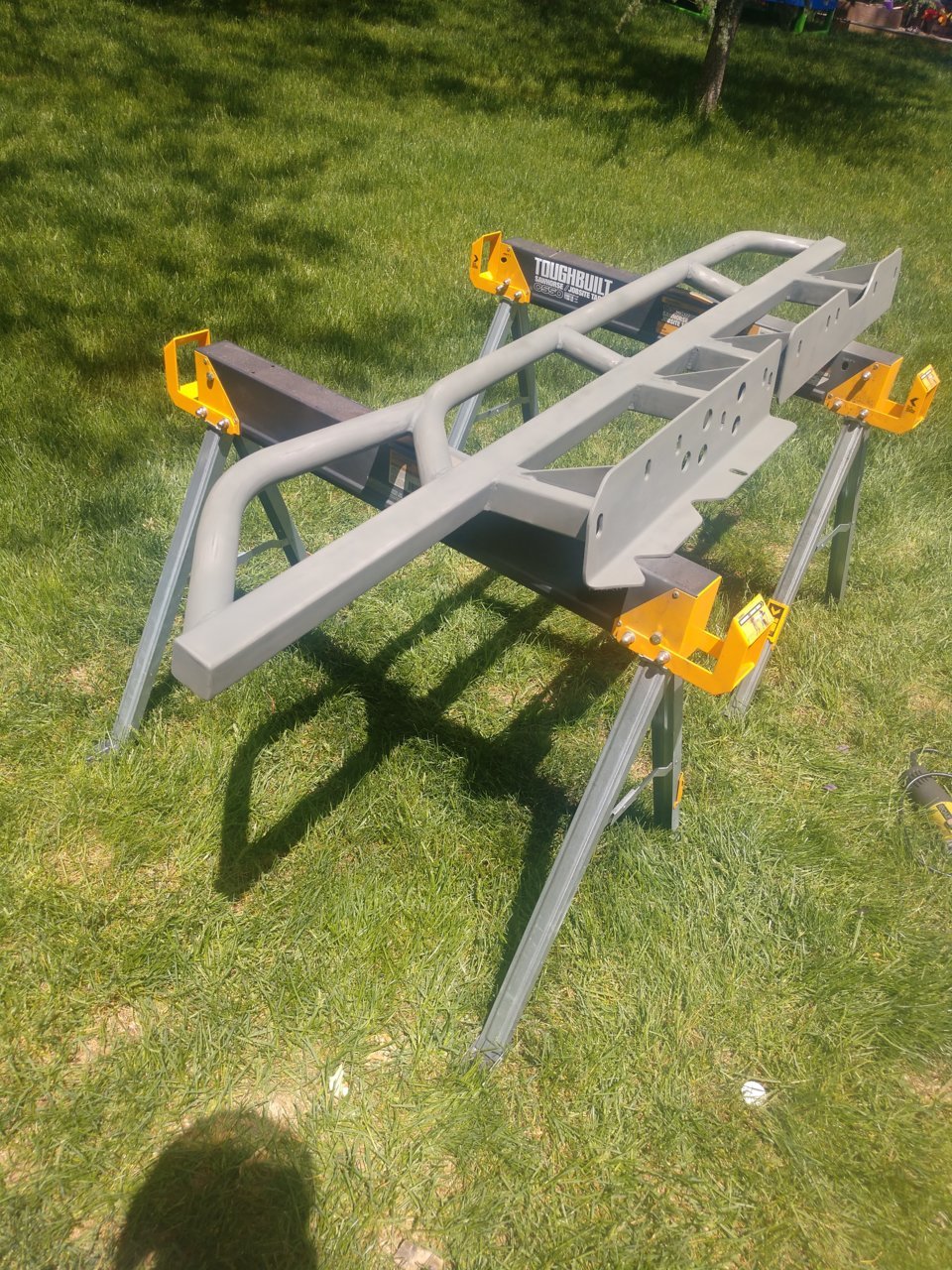

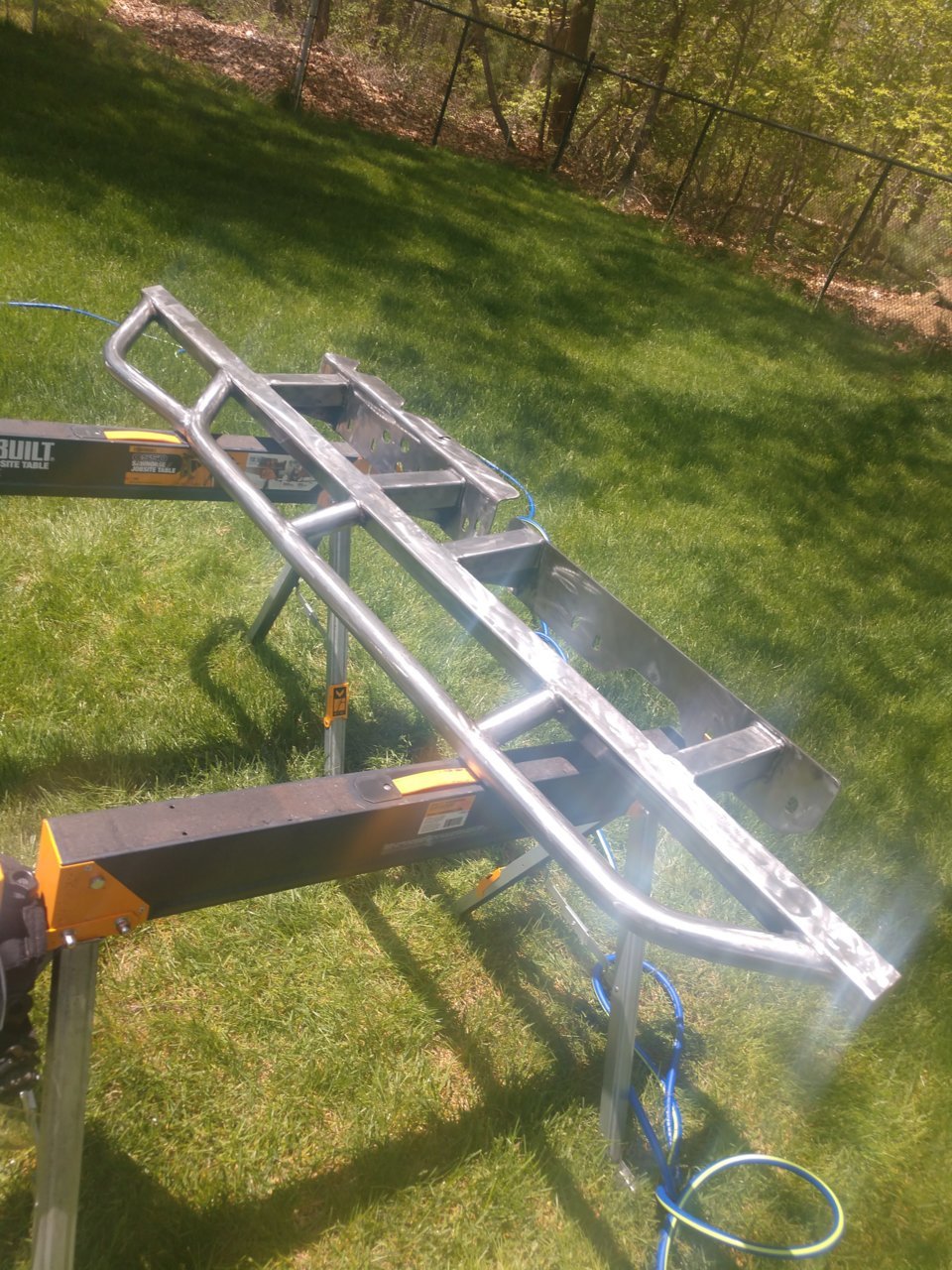

    Back to work on the sliders. Paint one today then finish cleaning and paint the other tomorrow. Then bed liner both the same day. Still might decide to try and sell them after I'm done lol

    This looks like the disaster we found in my kitchen when we moved in and wanted to upgrade...We did a full gutting and replaced everything...

    That’s were the conversation has headed.
    But I’m not ready for that overhaul yet.
