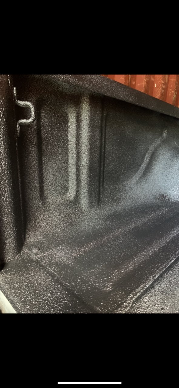

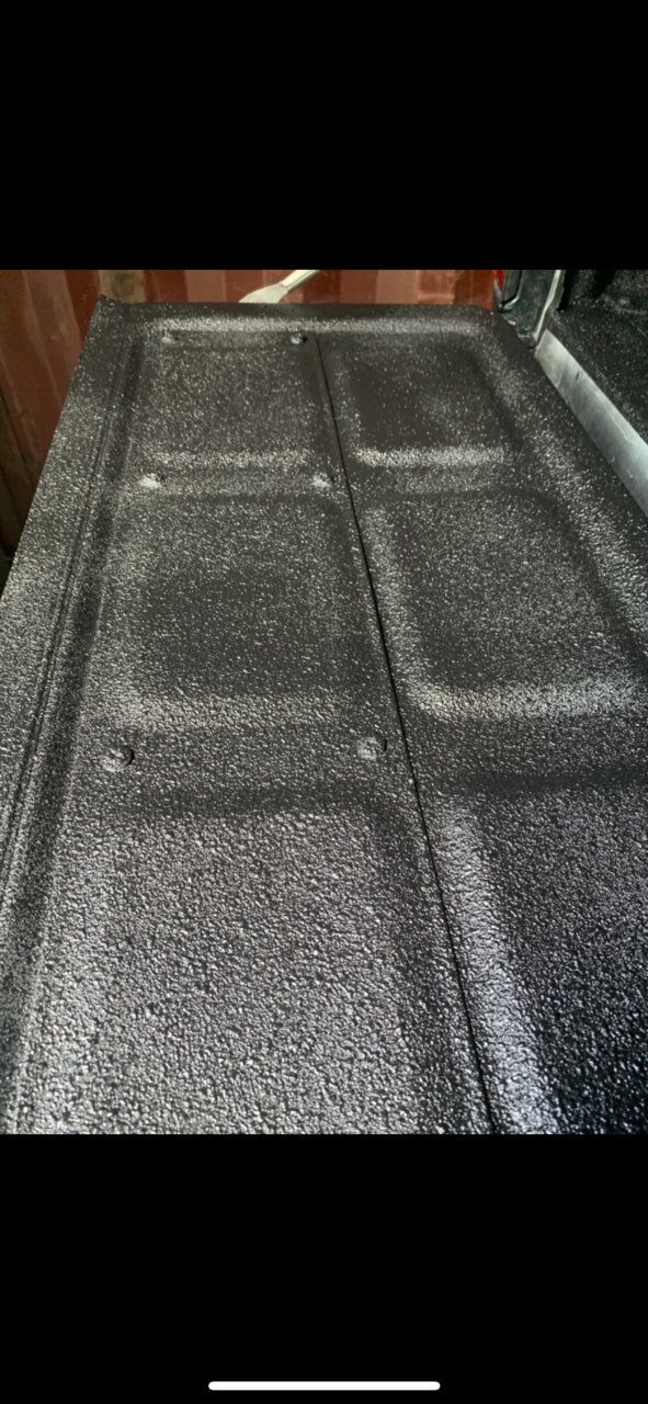

    Do you have any close up pics showing the texture? I’ve been wanting to linex my 1st gen but the raptor lining looks pretty close

    Yeah here are two.
    I applied it at 50-55psi and my compressor claims about 6-6.5 cfm at that rate.
    It was also my first time spraying with a gun like that, so take it for what it’s worth.
    Had to use screen grab because files were too big for my slow ass internet to load
    it should be worth noting the silver sorta look some photos have. The paint I got to tint the tintable version had metallic flakes so I’d not be like me and order it right the first time

    Wow, thank you. It looks great. I think you just helped me decide. I’m going to try the Raptor lining. I’ll be sure to get the black. I know they have a lot that comes with the gun. I don’t think the adhesion promoter is included though. Did you buy it separately?

    Yeah. I cleaned it out roughly, then sanded it down with a palm sander and some by hand. Then degreased and cleaned everything left. Then I did a coating of acid etching primer just to cover any bare spots or bolts. Then I did two quick coats of adhesion promoter before finally spraying it.
    I used 3 bottles but went light on first coat. 4 bottles would allow for 2 nice heavy coats or 3 medium. I have more bottles but felt it was good with 3L worth.
    It sounds like a ton of work but our beds are small so it’s really like 1/2-1 day of work with all the dry time added in.
    skinny painters tape helps do better straight lines. And if you tip the gun too far it will leak out of a side hole in the cap of the gun they provide. I did use the one that comes with their kit and it was fine. Have nothing to compare it too.

    Thank you for the tips. It looks good with the 3 liters. That’s one thing I was wondering about. The basic kit comes with the 4. I may not do the tailgate. I’m thinking of leaving the liner cover on there because I put stuff on the tailgate top edge really often. So I’m thinking the 4 will be more than enough.
