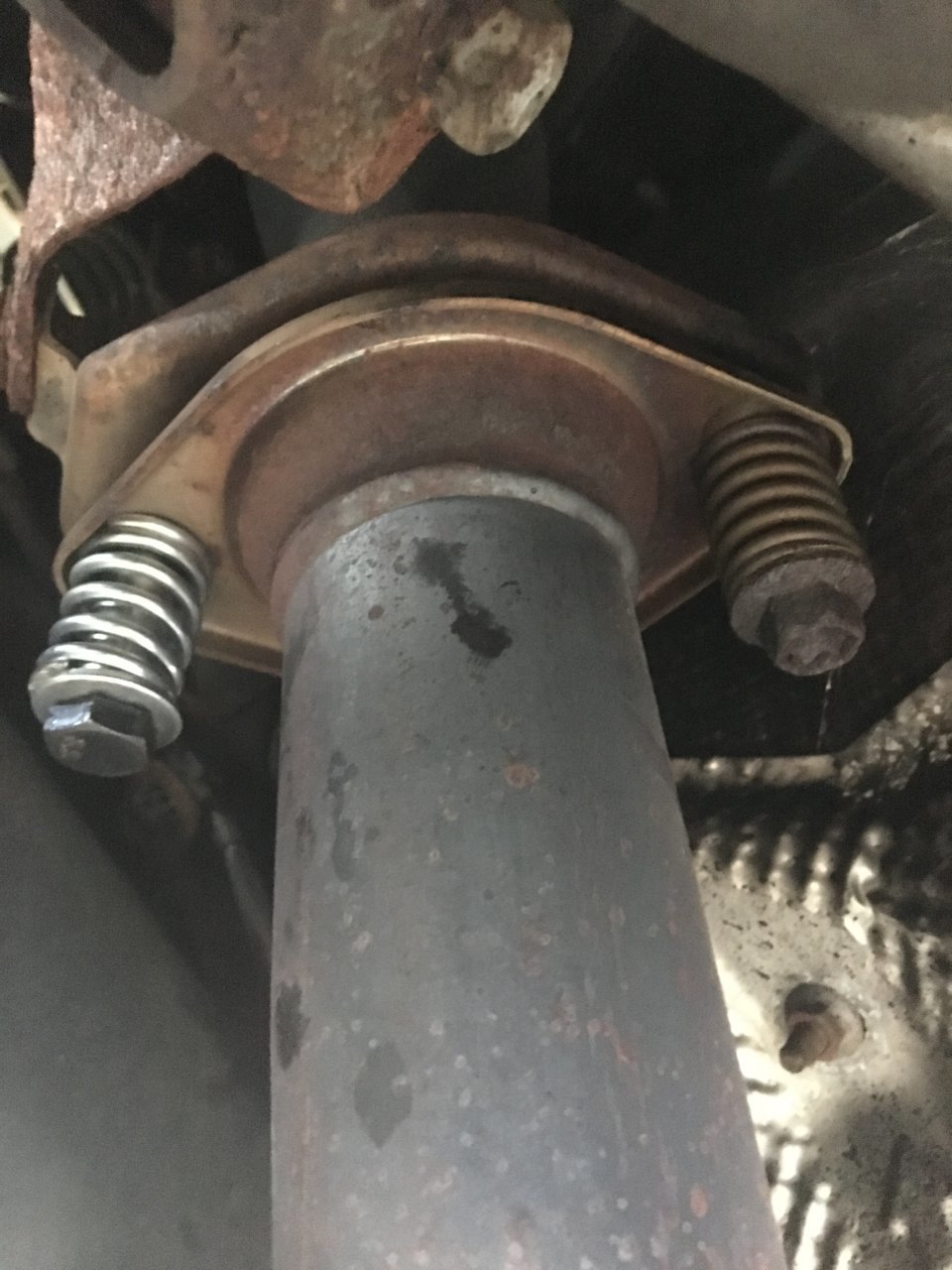

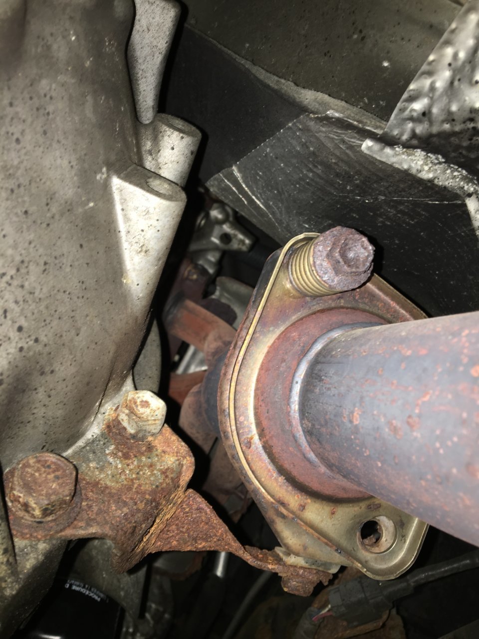

    Are you missing one of the spring bolts on the exhaust off the manifold? Or a crack in the manifold? I have/had both. It was very loud until it warmed up..I found out the welded nut of the spring bolt rotted out and the bolt fell off...
    $8.99 at aut0zone and a $.60 M10 1.25 nut from HD.
    It's a bitch to get the socket over the nut up top...everything is in the way...A ratcheting 17mm box wrench helps BIGLY!
    If it's not that it's probably a rotted out gasket on a pipe joint...
