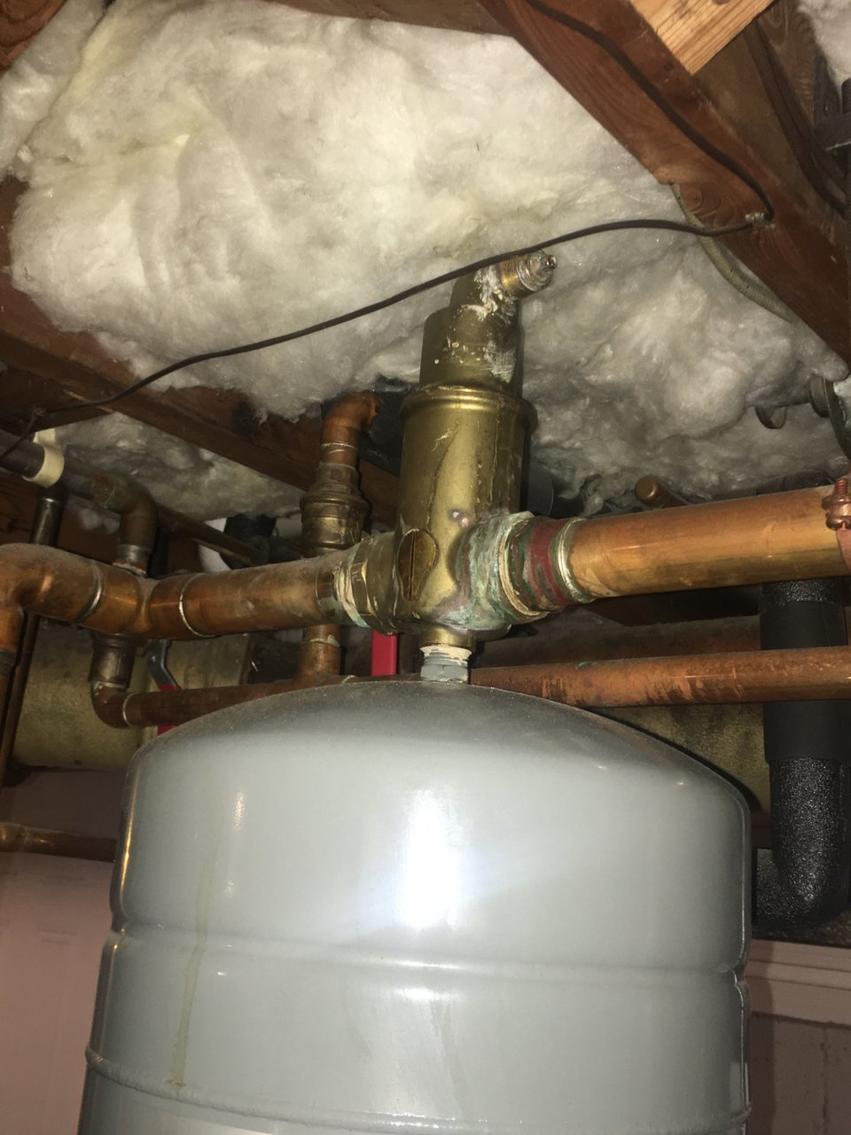

    what’s this vent called for my furnace? I’m wondering if I should replace it before I start using my furnace regularly this winter. I’ve bleed the air out a couple times over last two years and it still seems like I get noisy pipes. Thoughts? It looks like it comes off pretty easily-ish with a couple large crescent wrenches and some heat. Pretty sure I’ll need to drain the system before I begin

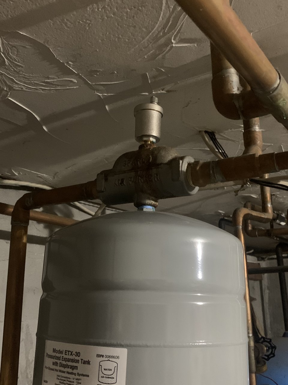

    That’s the pressure relief for the expansion tank. Looks messy.
    We just got a new furnace and they replaced the tank and valve on top of the fitting.

    thats an air separator. Gotta watch those cause if you continually bleed the system there’s a chance the float will stick open and you’ll leak water. You only need to replace it if the float (Internally it’s wire mesh) is all messed up and it won’t bleed the air out.
    so depending how you have the heating runs done. I’m assuming you have a two story home, the returns from the second floor should have a bleeder 90 on them. Crack the bleeder screw and it’ll help purge the air.
    Everyone has a slightly different heating system. Mine used zone valves for the feed and I have drain tees on the returns. My second floor has a drain 90 and I one had to purge it once during the initial install.
    I did have to replace my hot water tank so had to re bleed that and the air separator ended up sticking open. Couple taps with a ball pen hammer got it to settle back down

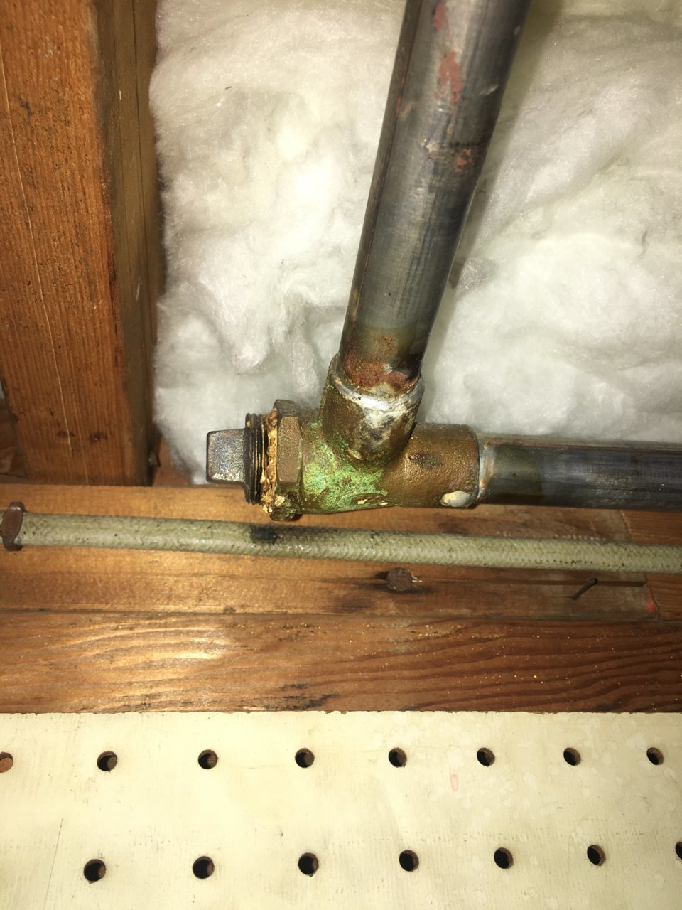

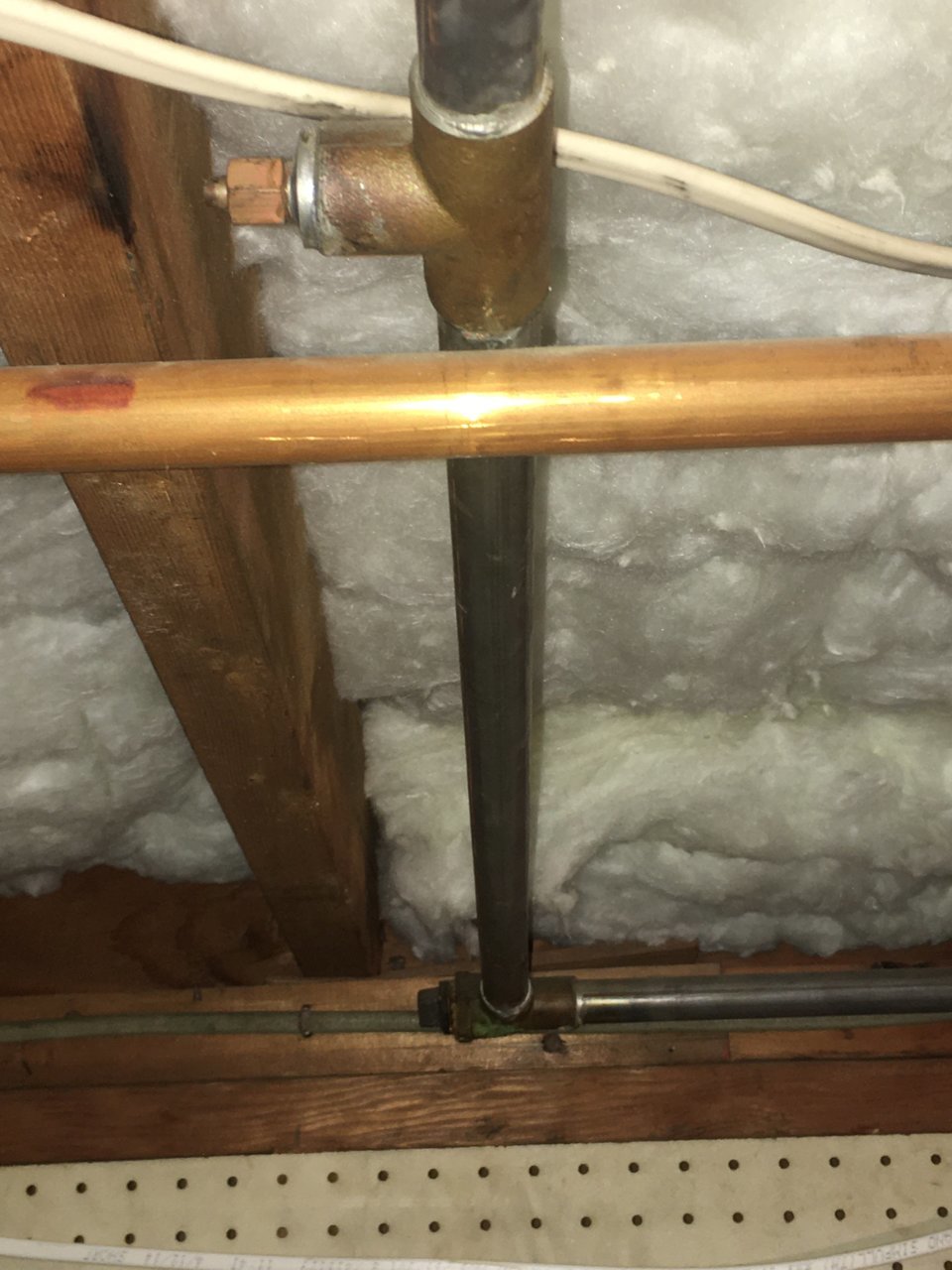

    I have zone valves for each floor and I also have a drain tee ( I think) . Zone valves are Honeywell and they (motors) were both replaced in last two Years.
    these two are in the same run that belong to the first floor. This is where I hear the noises with pipes . That looks like a bleeder tee ( I think) . Is this easy to do? Furnace running or no?

    Mine is even better. My boiler guy added a ball valve directly on top of the expansion tank when he replaced it this year. He said that isolates it so it can be replaced without possibly needing to bleed the system in the future.

    yeah so those are bleeder tees. So the way to do it is while the zone is running crack open the bleeder screw. You leave them open until water starts coming out.
    If you open them while the zone valve is closed you won’t actually bleed the loop but make it worse by putting an air pocket into it

    That's a Spirotherm vent. How often you should replace them depends a lot on your water quality. Fortunately, they're also serviceable, so if your valve is sticking open or closed a lot of times you can just disassemble and clean it.
    The whole top piece unscrews, so you can depressurize your system and take that apart with a pair of pipe wrenches to see what sort of condition it's in. Mine was sticking open a couple of years ago and dribbling water down onto my pressure tank, so I took it apart. The insides were still in good shape, so I soaked in white vinegar for a couple of days to get the lime scale out (I have to do the same thing with our shower head about once a year) and then reassembled it and it's been working fine ever since.
    But if you take it apart and it looks like this...just get a new one.
    https://www.youtube.com/watch?v=ptEKP23nXSk
    Edit-
    You can buy individual parts for them online, as well. If you have to replace it, just replace the top unit. No point in paying the extra $50-60 for the base, since it's literally just a brass pipe fitting.
