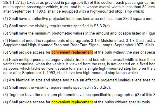

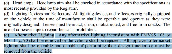

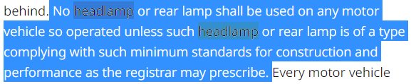

    Was curious about this, because I did dig into this in the lighting thread for 3rd gens. The inspectors will typically say "Not stock lights, FAIL" in a lot of states, when the reality of it is that there are no restrictions about the bulbs themselves. The typical laws are the light height/width to center/ground, and typically the housings/lenses (cannot smoke out lights).
    Obviously it's an uphill battle if you do end up with a fixit ticket. But. I had to google Mass to get an idea of it. I'd have to look at
    https://www.govinfo.gov/content/pkg/CFR-2004-title49-vol5/xml/CFR-2004-title49-vol5-sec571-108.xml
    (PS a fun bit found below!)
    I can't really tell but I think this is where Mass is failing aftermarket lights, plus a bunch of aiming stuff maybe?
    https://www.mass.gov/info-details/mass-general-laws-c90-ss-7
    Long of the short, when they say "NO AFTERMARKET!"
    1. If it complies to FMVSS 108, you're good.
    2. Aim is checked, so they can fail for aiming
    3. Don't be a dink. The effort you'd have getting the shop to go with it wouldn't be worth it. When I go for an inspection I'm just going to put in my stock headlights I didn't trash the bulbs :rofl: ain't worth the time to fight this kind of thing, they won't pull you over for (a normal) aftermarket light.
    Here's my fun bit: high mount brake lamps must be set up to provide ease of access per this regulation. Nothing in there about this for headlamps, so they can continue the shenanigans, BUT apparently the 3rd brake light has to be easy to access. :rofl:
