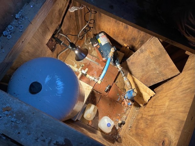

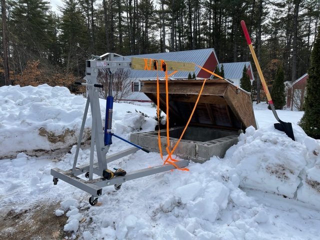

    MY GOD have we had a shitty last two days! We came home Sunday evening, and I went to wash some dishes. The water ran for about 10 seconds then stopped, like someone had turned off the faucet... I had to dig out the pump house cover, drag my very heavy engine hoist through snow, and rig up a way to lift that like 200lb cover. I checked this over with OSHA, and they were cool with it. They said that having two of the 6 wheels of the lift on the ground was totally fine, and having the rear of the lift approximately 2' off the ground actually aided in the mechanical strength of the lift rig.
    Finding a company to come help with this issue was annoying as well! Most of the ones I called and left messages with never called me back. Some that answered didn't work on point wells. Another told me the soonest they could be there was the 9th or 10th... Finally we found one who said he'd be there in 45 minutes!
    It turns out that the pipes down there froze, causing the jet pump to bind up and burn itself out. Very unfortunately, it cost me about $1,900 to get the pump replaced. The kicker is that pump goes for $450 online :angrygirl: :pout:

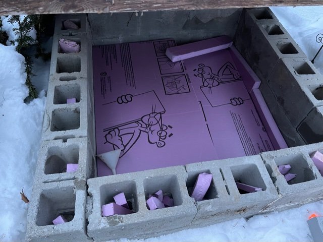

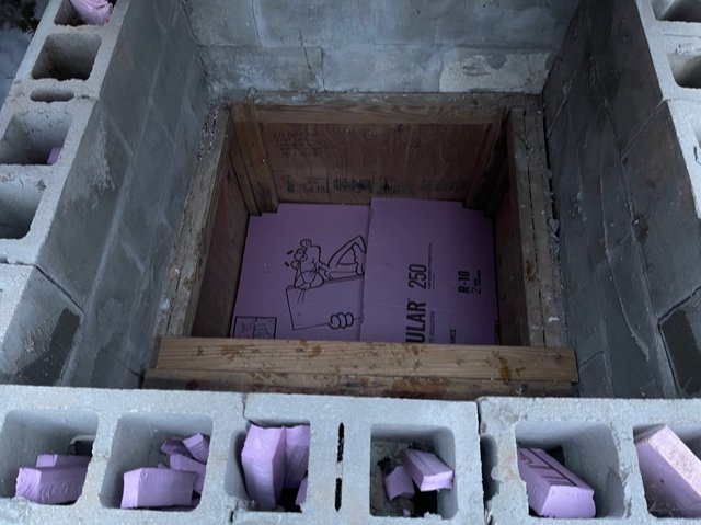

    While he was running to get the parts, I ran to Home Depot and grabbed two 2" sheets of 4x8 foam to provide some extra insulation once the replacement was done.
    I made two layers of foam. I also had the dude put the light down there to keep things warm.
    After all is said and done, I've spent $17,000 in the last two months. If something else goes wrong, I'm going to live in my Crosstrek down by the river.

    Well, at least you got a closed-cell foam so you don't have to worry about it holding moisture. :notsure:

    There was no bulb or insulation down there at all. And no mortar between the bricks, so without our typical snow blanket, wind got down there.
    I spray foamed between the bricks and added all that foam, as well as the lightbulb.
    Next year I am going to get a temperature sensing switch to turn a heating element on and off. It's a royal bitch to get that cover off.

    Yeah, unless it waterlogs the foam and gives it a zero R-value. Not a problem with closed-cell XPS.
