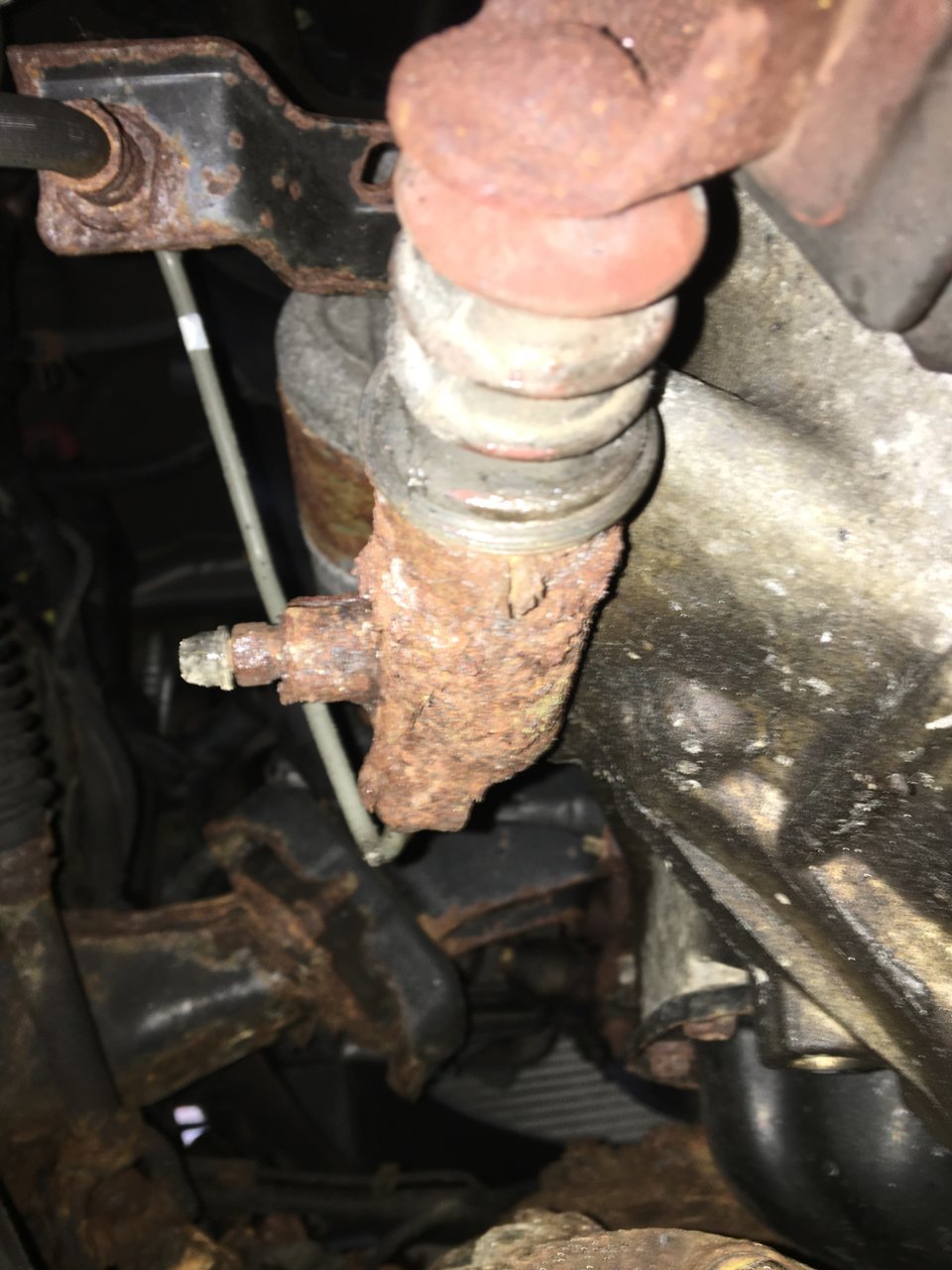

    OK so I’m getting gas with my 2010 manual transmission. I push the clutch to start and the truck turns over and then the clutch doesn’t return to it’s normal position when I take my foot off it stays down. The clutch is stuck engaged. I can’t move The pedal back to the floor now that I’ve raised it. I turned my truck off I can use the clutch start override button to start it but I can’t shift gears any ideas

    That's what's weird. It's the opposite. The pedal is stuck in it's normal resting position and cannot be pushed to the floor. No matter how hard you push it feels like you'll snap the pedal before it will move. I believe the clutch is still physically engaged because I could shift the gears without any grinding...
    I'm sure it's a master/slave issue..

    Sounds like a bad slave cylinder. Get an Aisin one off rock auto

    Uh oh! Either your slave went, or your throwout bearing died

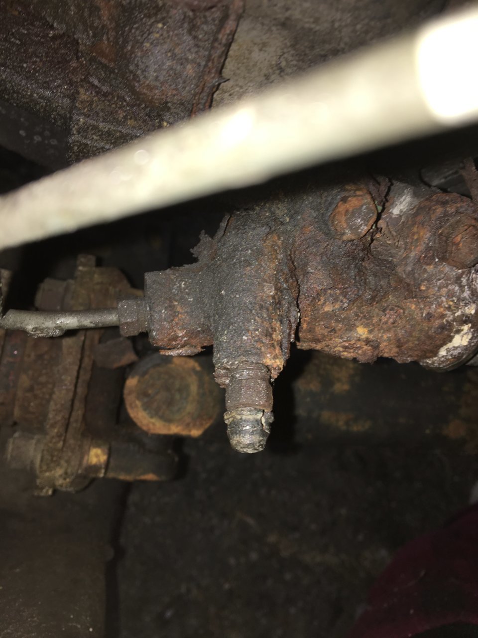

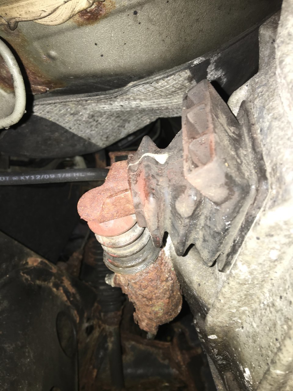

    Well I had it towed because it's february and I'm not dealing with 200,000 miles of rust on the original clutch...
    This is fine right :)
    He calls me "Ah, yeah, your slave is stuck. I hit it with a hammer and it didn't move...also your master is not in good shape either so if I'm in here..."
    I said go ahead, and it's an old truck so let me know if you see any other weird stuff...
    He laughed and said "There's get it driving, and there's get it fixed..."
    I said "Definitely driving, let me know if you see anything else that needs fixing..."
    Over the phone quote $400. Master and Slave replacement, flush and refill...I'll pay that fair price any New England winter...
    I'm sure the dealer would have been 3x that.

    That looks slightly crusty...

    Looks crusty, but I personally wouldnt pay $400 for a job that is less than $100 in parts
