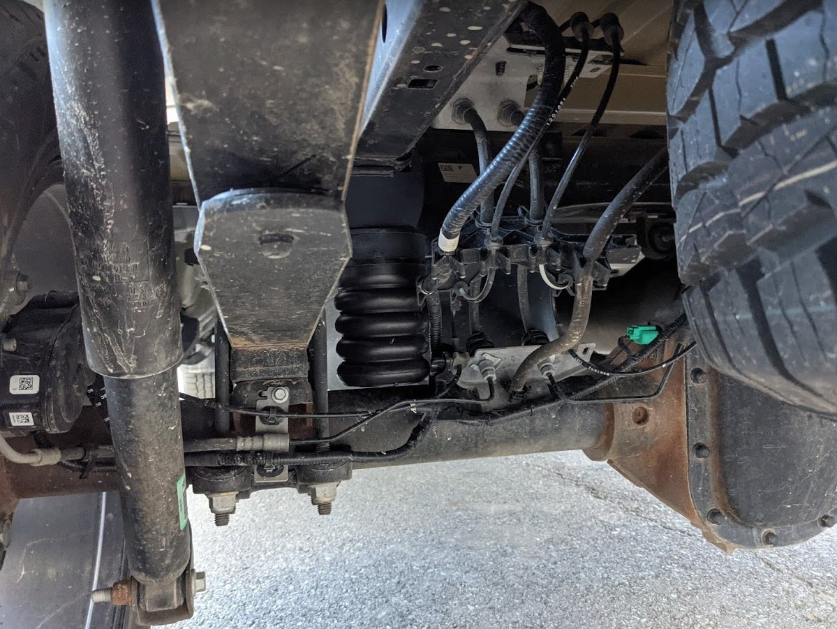

    Sumo springs are in!
    They sit really close to the axle unloaded so it doesn't take much suspension travel for them to work but it didn't mess with the ride much. It did stiffen it up slightly, mainly just less body roll into corners and a little less floaty over bumps. I'm not sure I would have noticed if I didn't drive the truck for a few days and came back to it with them installed.
    The driver's side one is a little close to a wire bundle my comfort - looks like it's for the e-locker, speed sensor, and electronic parking brake the way it splits. I don't think it will be a problem, but I may put a zip tie on that one just to try to keep it another millimeter or so away.

    Mine are the same way (I installed them on the front, though). Not quite touching but doesn't really affect the ride. I installed them because with the plow on the nose of the truck the suspension kept bottoming on the sh*tty road to my house. The Sumo's do a great job of stabilizing the ride with the plow on, but of course right after I installed them the town paved the road :rolleyes:
