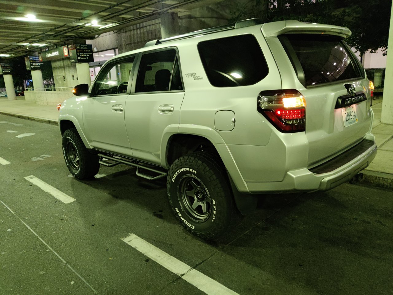

    It's nice to drop people off at the airport when there's no traffic!

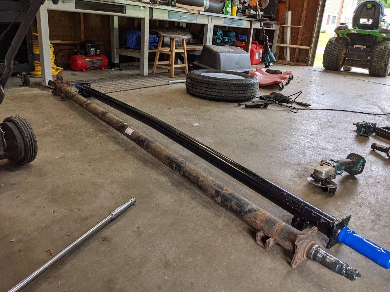

    Replacing my trailer axle was a success.
    Here's the old versus the new. You can see where the arc is mostly gone on the old one and it's bent on both sides:
    jTZPcOMzkvEdC8xIEV5UpgupgmNjNUV0ktrlBbU4_e008d5020297f28eb39e2c2e0dc7dcaaaccdd0de.jpg

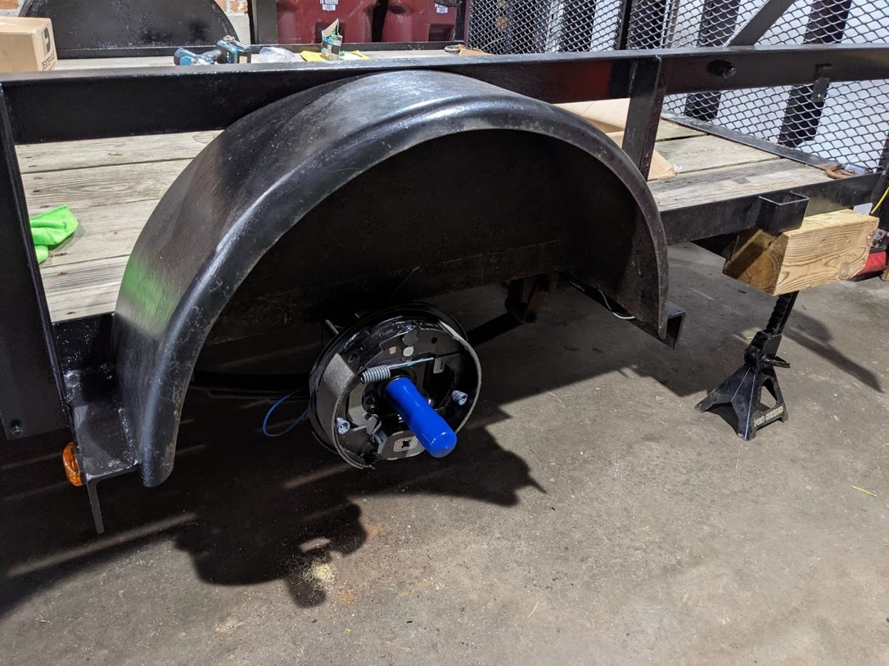

    Halfway through the brake install:
    MPFoKFkUFwaRdduQKYc1jDtlNSJp_dwNxcMbxzP4_1c6ce788a9c7443d18bb48ed46b5f1a25c636257.jpg

    Wheel/tire/lift looks great Jason!
