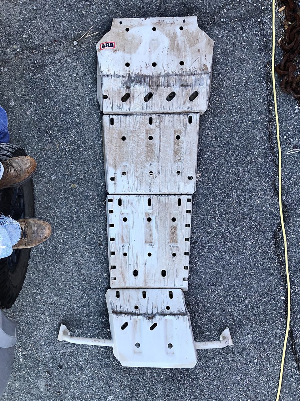

    Quick update on what has turned into the rust proofing saga.
    today i dropped my 4 skids and cleaned those newly exposed areas with a garden hose and sponge. Tomorrow hopefully i can acetone the frame and apply the cosmoline
