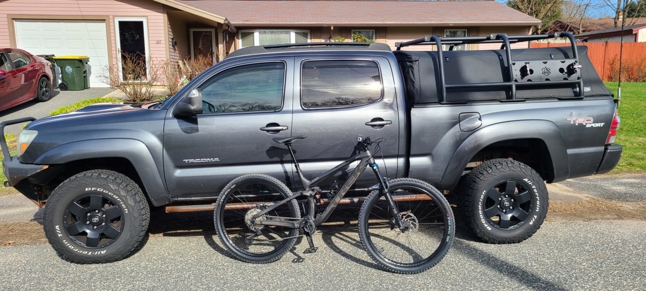

    mach1man001
    mach1man001 [OP] eh whatever
    Nov 4, 2009
    #25415
    22,389
    Rob
    Bellingham, MA
    2024 Tundra Limited
    I love my new truck but miss my Tacoma
    2 new acquisitions in one picture!
  10. Apr 11, 2022 at 3:47 PM
    AllTacosFloat
    AllTacosFloat If yours sank you’re entitled to compensation
    Nov 26, 2019
    #311742
    7,002
    John
    Boston ish
    Has lockers, a skewp and a bit of droop.
