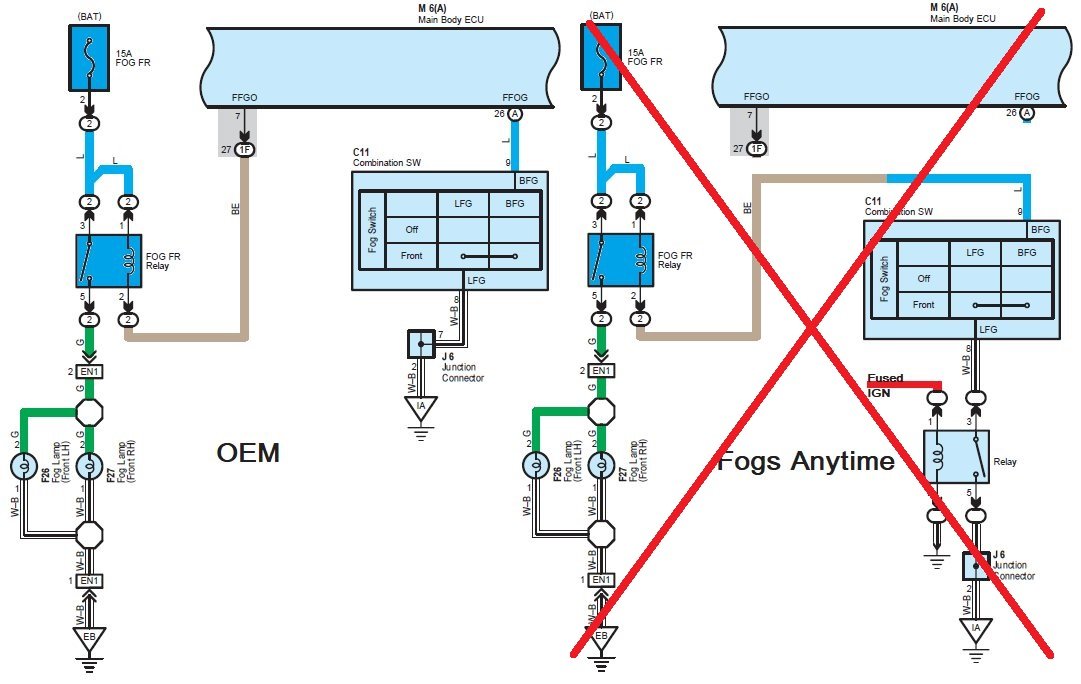

    If this is what he has (the diagram) then he will just need to add a switched ground as the fog light switch sends a ground to the BCM (body control module) and that in turn sends a signal to the relay.
    GarlicFarts[QUOTED] likes this.

    Wire 2 Switches to 1 set of lights? Can It be done?
    This seems like a good idea, just gotta find where to pull the stalk wire from.
