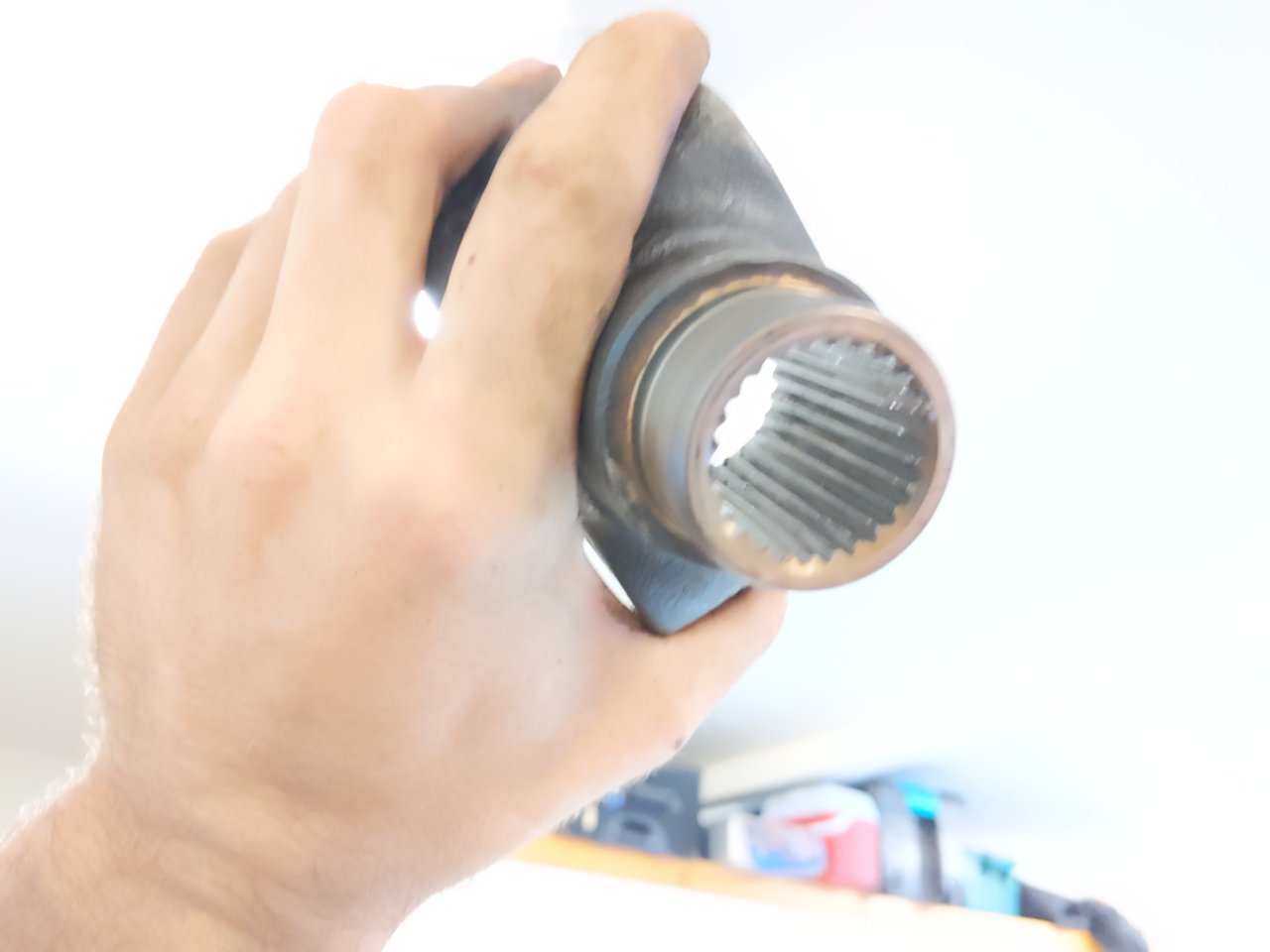

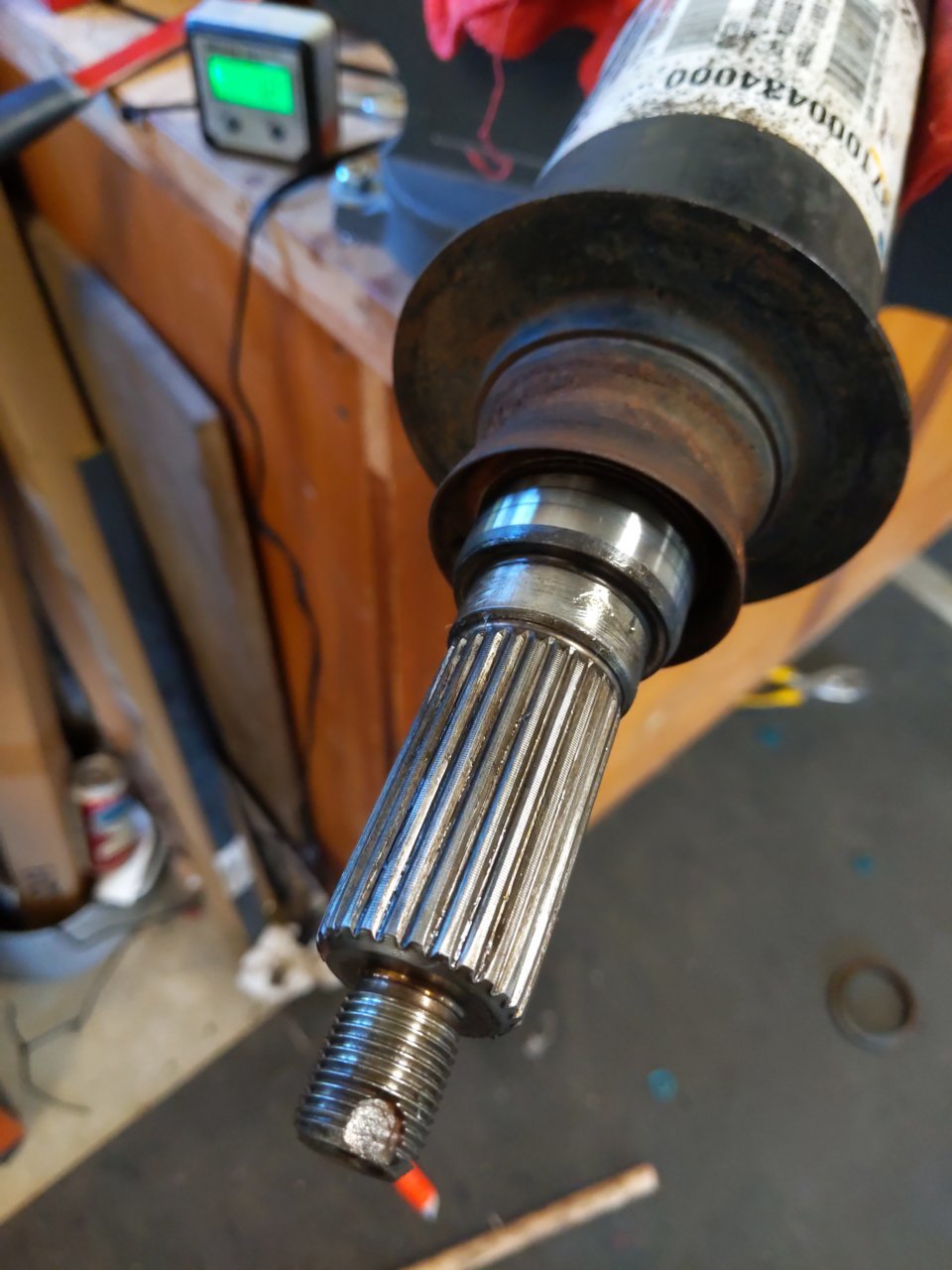

    I got out my asking hammer and slammed a couple beers.
    It came off.
    I don't see any corrosion or damage to speak of. That second shot looks dark in the grooves but it's just shadow. I guess they were just having one of those days at the factory where the hi-los met up on the tolerances.

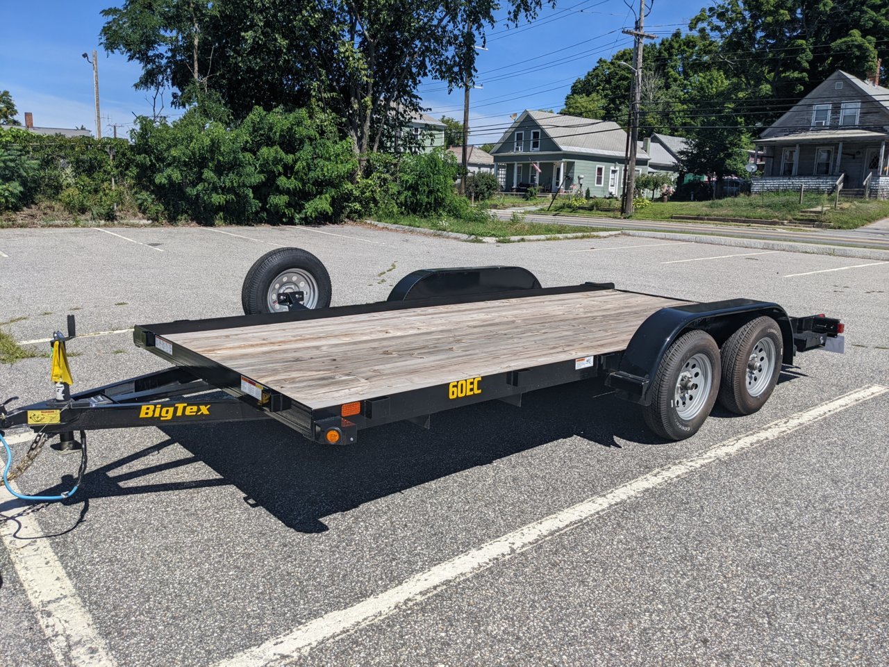

    Replacement trailer - 6000 lb gvwr, 16 ft car hauler. Brakes on both axles, really nice ramps, weighs about 1760 as it sits, so figure 4200 lb payload once I add a small toolbox for tie downs.
    I am considering adding a few D rings to the deck for more tie down locations, particularly near the fenders where there aren't any stake pockets.

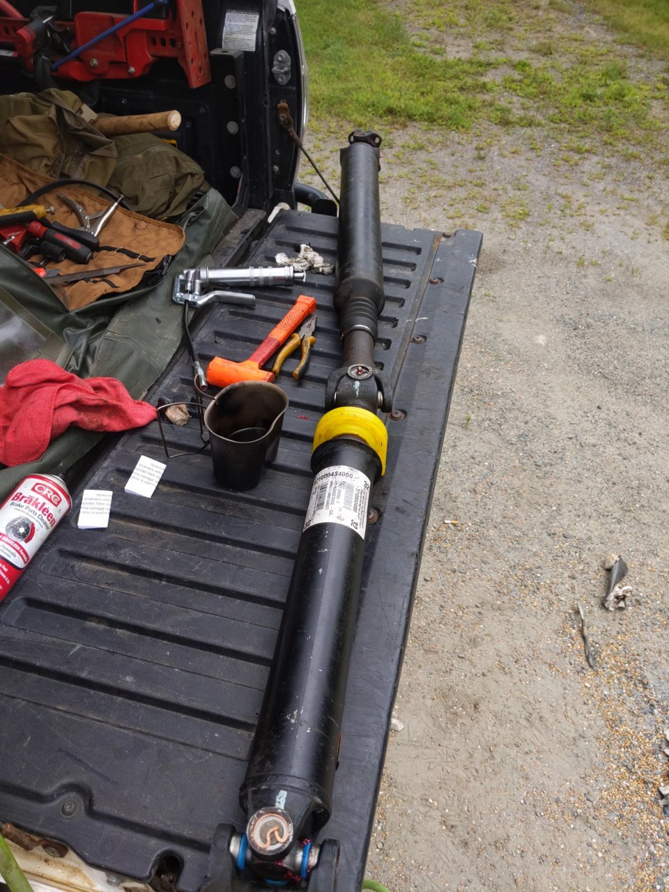

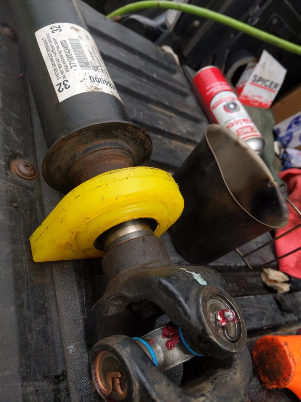

    Picking up bright and early...
    Now to get it back in and go to breakfast.

    Thanks! I actually got it kind of up in your direction - Lucky's in South Royalton. It's their "economy" car hauler, but it's hard to tell where they cut corners. In comparing it to the next one up, it looks like it sacrifices the dovetail, radial tires, and LED lighting (though this definitely has at least some LEDs, so maybe that is standard now). They did order this with optional stuff like the second brake axle and spare tire mount.
    I ordered a new toolbox for the front since I gave mine away with my old trailer and wanted something smaller. I went with a $60 weatherproof/impact proof poly box from Granger that I figure I'll just bolt to the A-frame instead of a proper trailer toolbox. It was a lot cheaper to go that route and I think it'll work fine.

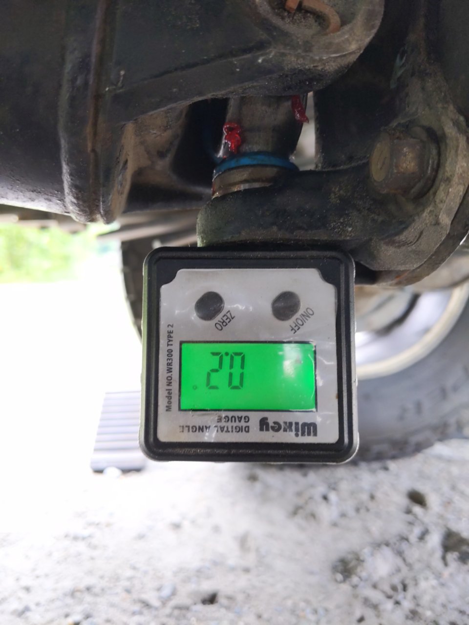

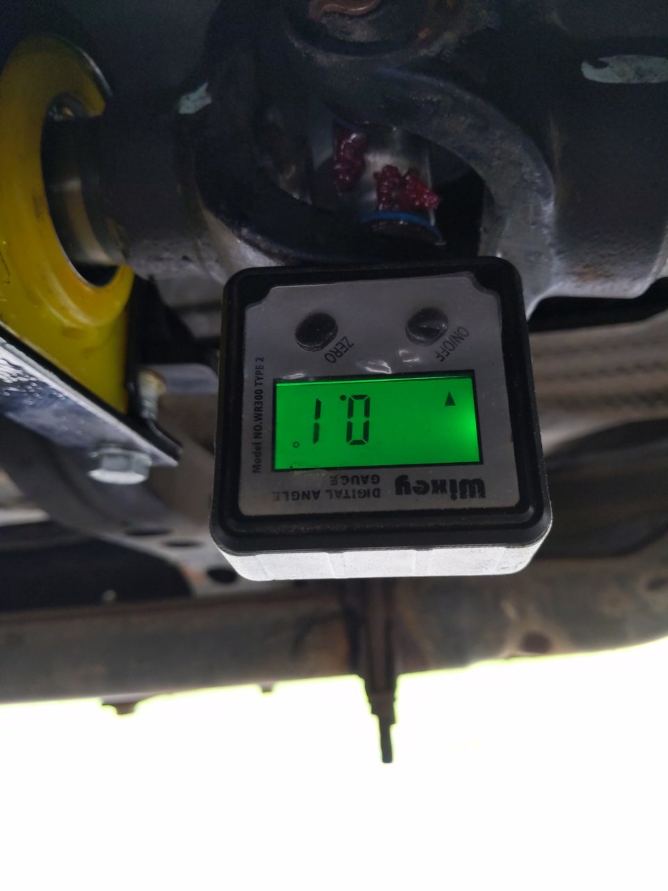

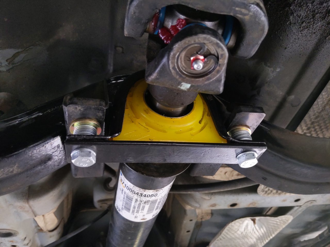

    Torqued and porked. POR'd the carrier brackets and touched up some minor rust on the cross member while everything was out.
    I would say my driveline angles are pretty spot on. These angles are referenced from the frontmost yoke on the shaft as installed:
    I have some stainless tube on order to replace the washer stacks I used to dial everything in.
    A test drive revealed that I should have done this a loooooong time ago.
