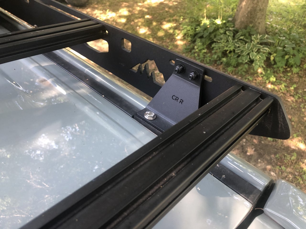

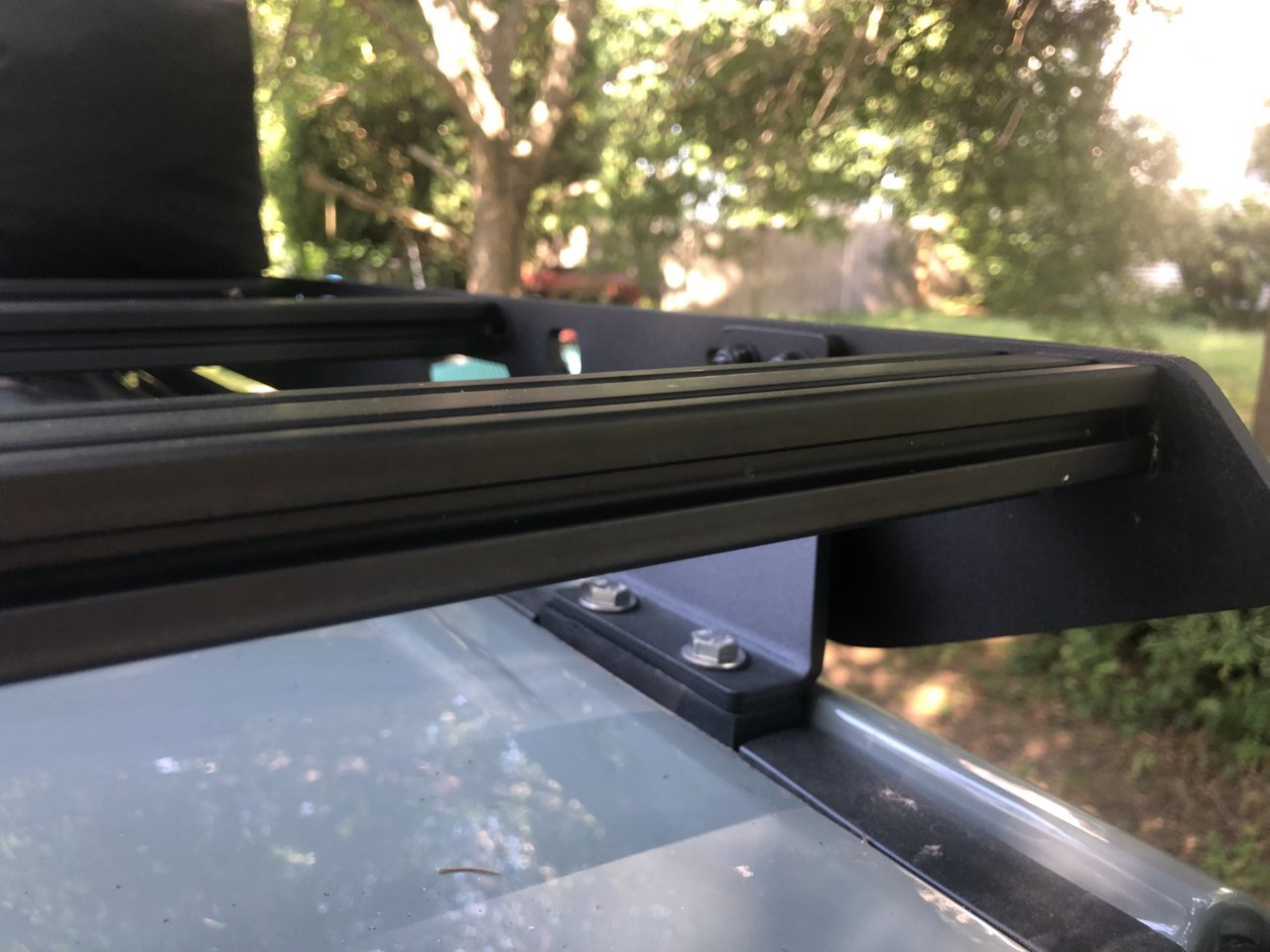

    Yes, they are called t-nuts. You want to make sure that you get the right "series" of tnut though. Usually roof racks, if it came from the manufacturer, are made with 10 series extruded aluminum so you want to make sure that you get 10 series t nuts. I get all of my stuff from www.tnutz.com . They are awesome and usually the cheapest.
    You can get these which are drop in stainless steel and you can get them in 3 different bikt thread in patterns. I usually use M6
    https://www.tnutz.com/product/db-010-ss/
    Or you can get these so the bolt is coming right out instead of bolt in, and it comes with the nut and washer as well also in stainless
    https://www.tnutz.com/product/qtb-010-kl/

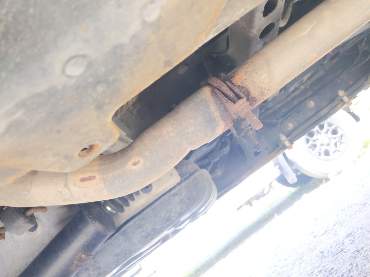

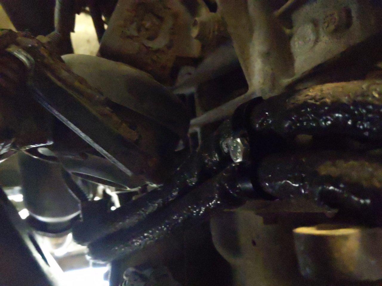

    Putting a new muffler/tailpipe assy on a friend's 2nd gen 4.0L - does anyone have a P/N for the slip gasket and maybe even the clamp?
    Edit - the ones that go here:IMG_20220821_140328.jpg
    Thanks.

    That is not a factory part. That is a cheap aftermarket clamp that you can buy at any part store.

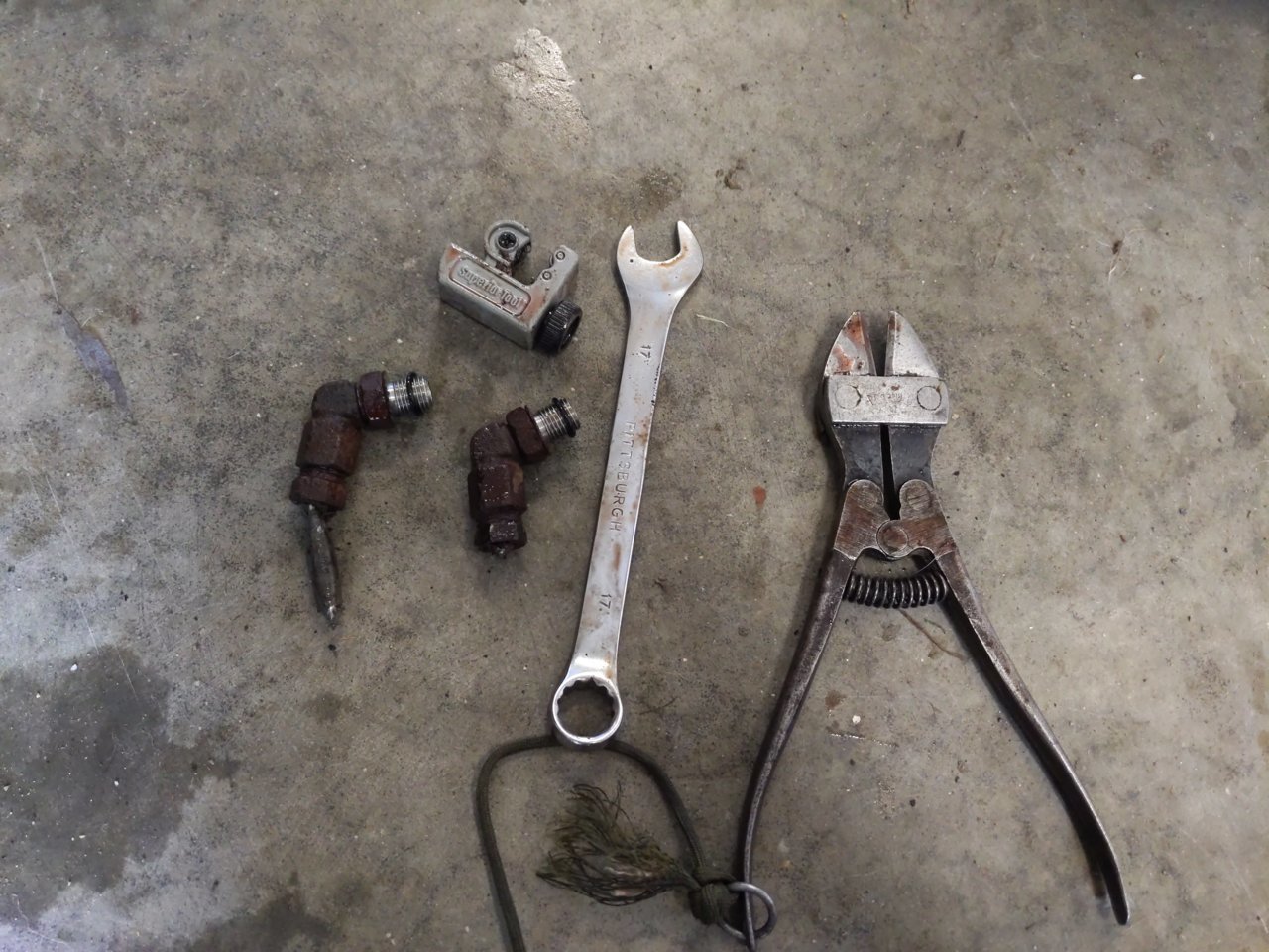

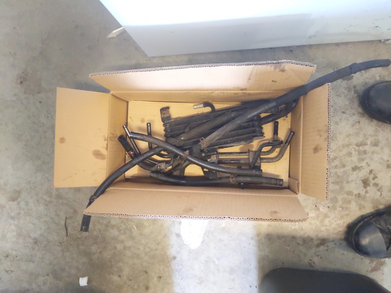

    Anyone want a factory trans cooler? Every single piece of hardware, bracket, and hose came off in good shape. I have NIB tcase elbow fittings and hardlines.
    Free for the picking up.
    Edit: progress so far....
    For future reference, it is M14x1.5 into the transmission housing.

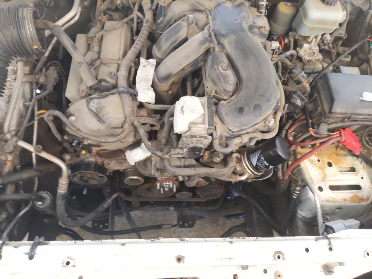

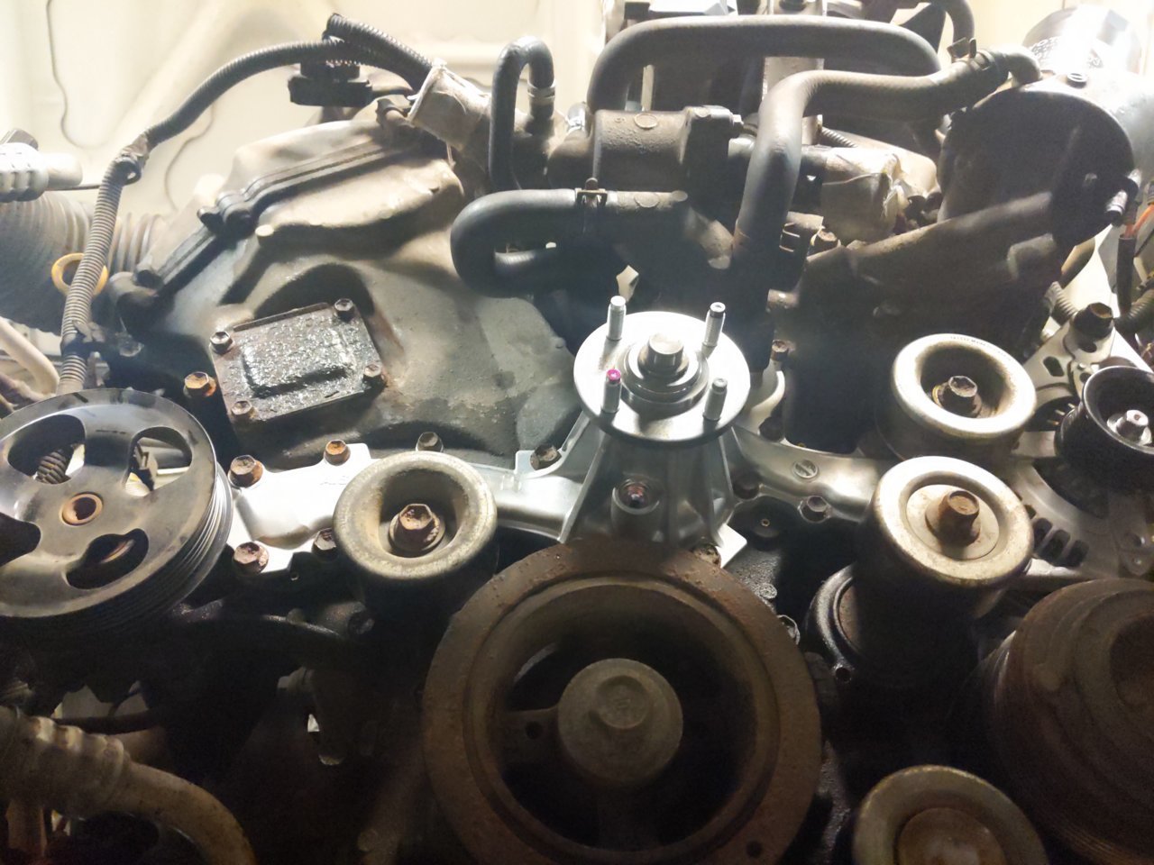

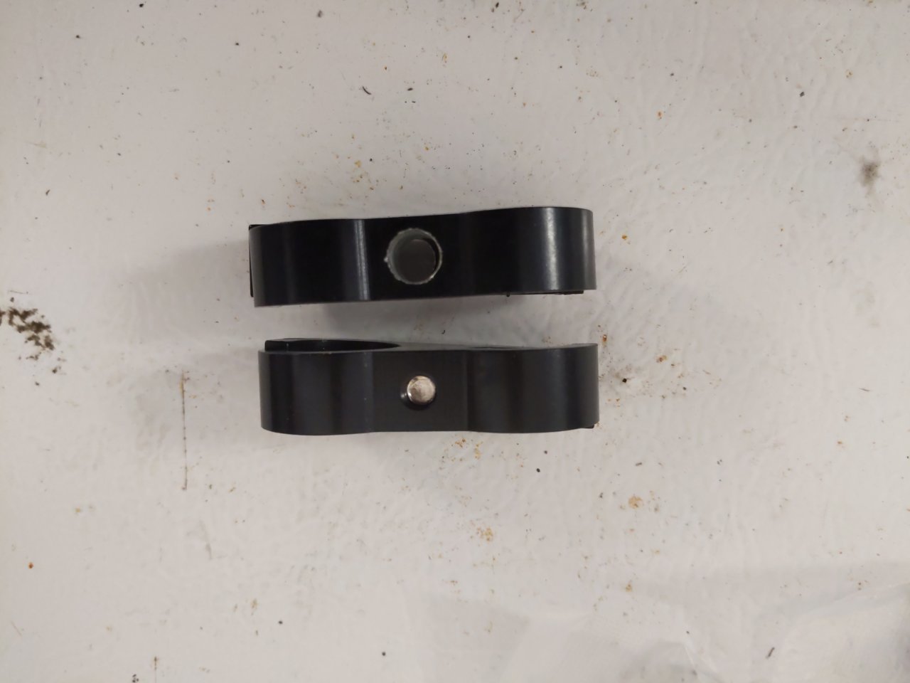

    Quitting time. New water pump (as well as upper ass'y/throttle body water lines and all new clamps for water lines), new alt, and new trans cooler lines are in, pulleys back on. Tomorrow is CSF rad and figure out a mounting bracket for the trans cooler with some aluminum and stainless self tappers.
    The new trans cooler lines are held in the factory hardline bracket points with some modified 2-line clamps. Just had to drill them out to take the right size bolt:
    My timing chain inspection cover is pretty thrashed. I thought I had one here, but no, just the gasket????? I hit it with a wire wheel and some rust converter... Something to fuck with another time I guess.
    One of the 12mm bolts on the water pump really wanted to round off, so I sent the neighbor kid down to the getting spot to pick me up a full metric set of 6 point wrenches. Less than a hundo and it really is about time I graduated from the Hazard Fraud 12 point set I've been using for years.

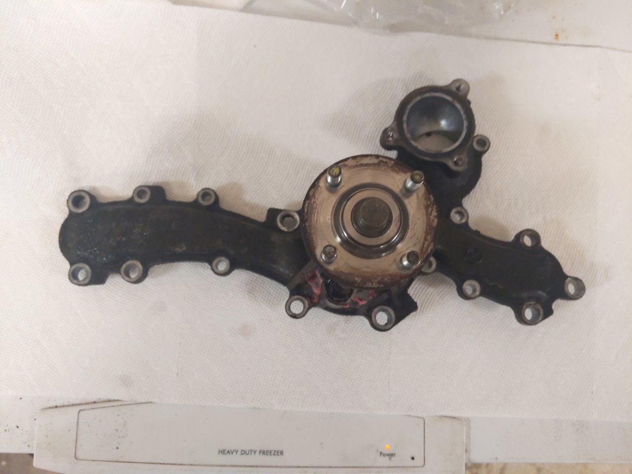

    Here's the old pump and alt:
    The pump went from a little weeping to a noticeable slow leak, thus the replacement. On inspection once it was out it seems the bearing is also starting to go. Whatever. 250k miles. The alt was getting a little chewy too.
    I'll probably put the alt on the rebuild bench with the PS pump and steering rack. Winter projects.

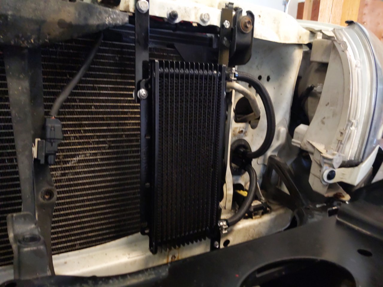

    All done. No leaks, first try. This is beyond the power of science.

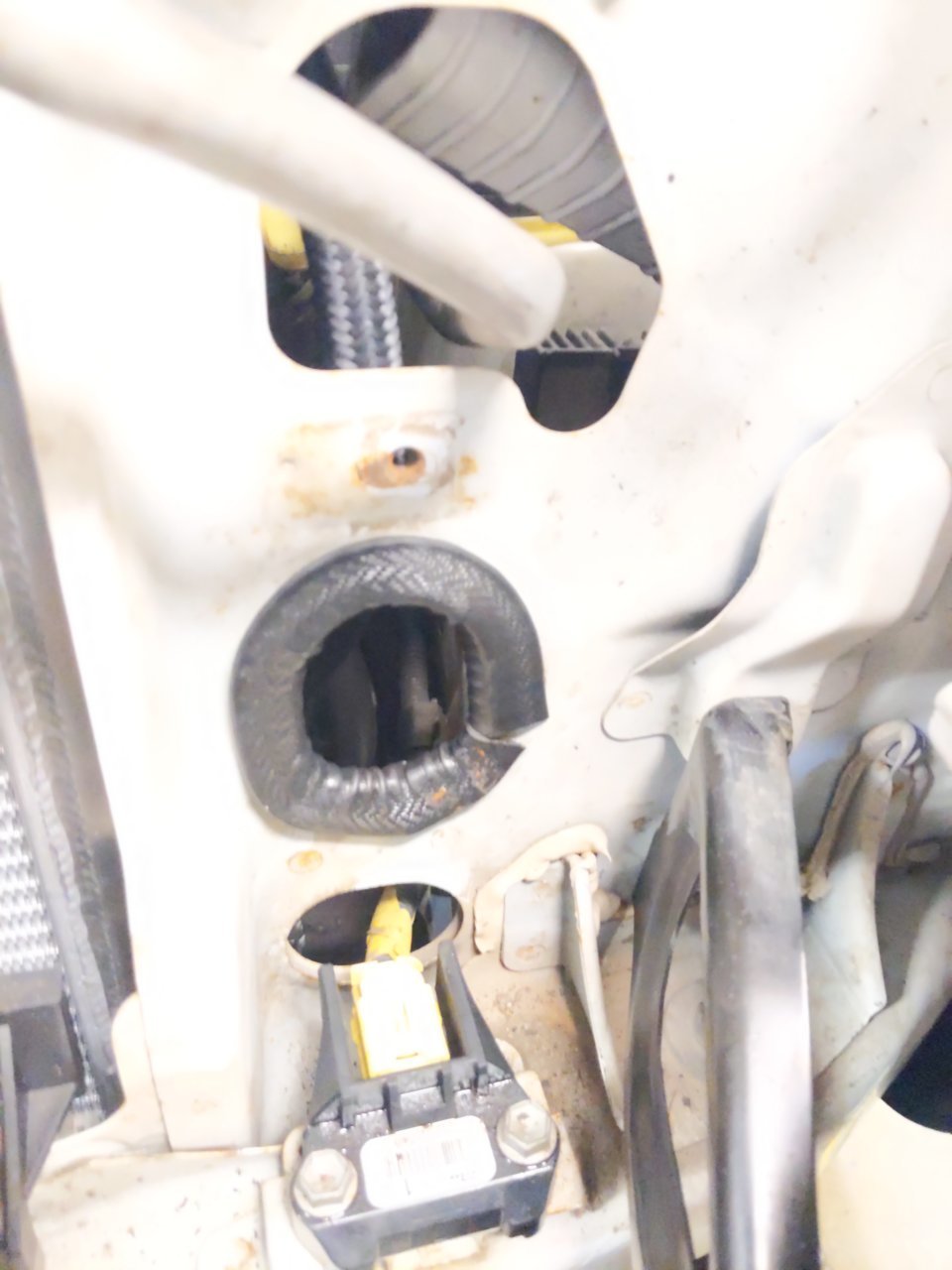

    Made some brackets for the new cooler (Hayden 696). Aluminum is tough to bend much without cracking - thin stock only, targeted heat, and go sloooooow.
    Did a donut of edge trim where the lines pass through:
    And here it is installed:
    I lost way less than a quart of trans fluid thru the entire surgery. I'll top it up and check the level tomorrow. I lost almost 2 gallons of coolant all up.
