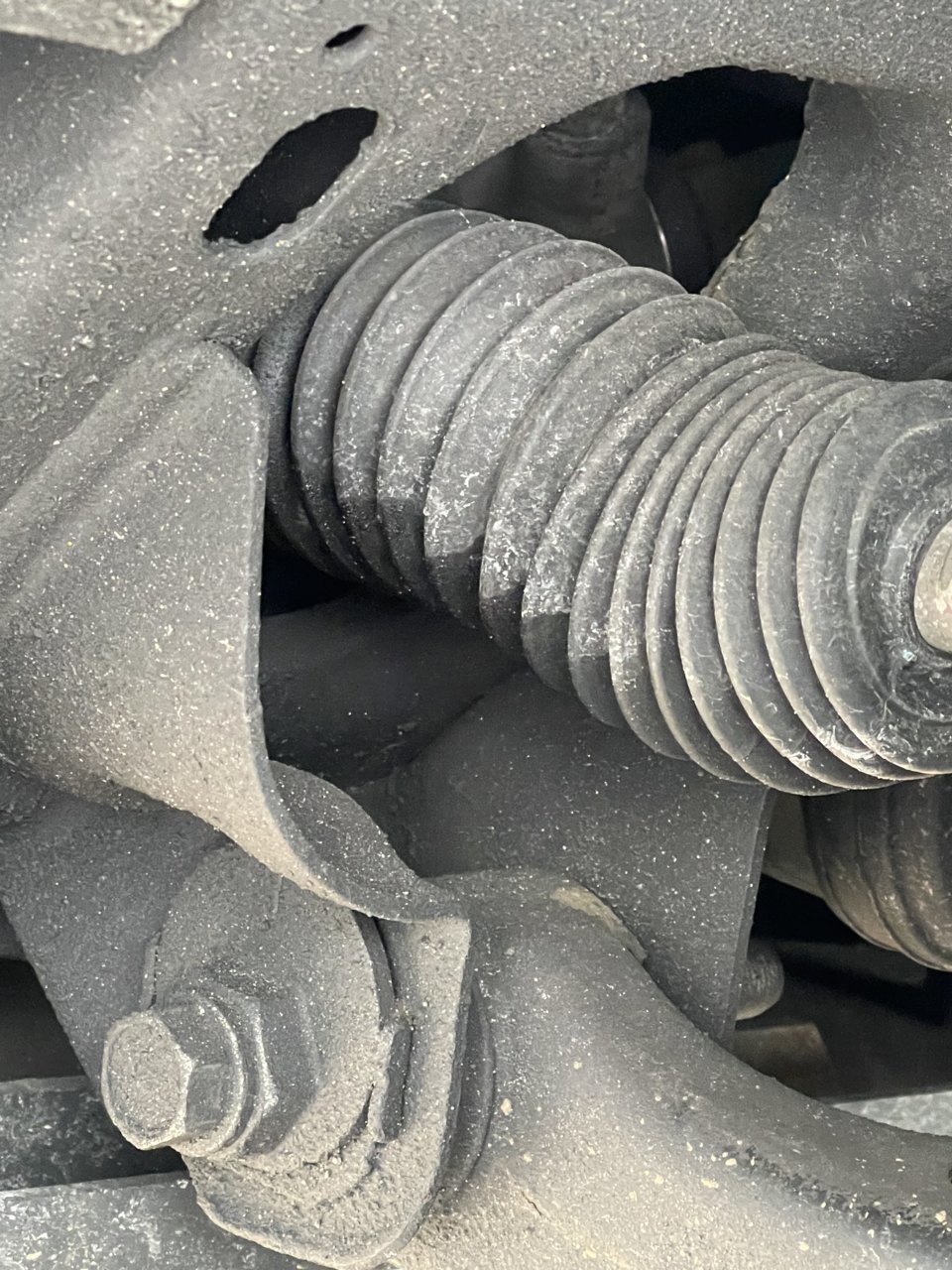

    On the note of mod day stuff, anyone have a leaking steering rack issue on the 3rd gens? I’ve got some kind of fluid on the bottom side of the boots.

    Has lockers, a skewp and a bit of droop.
    Get the new one.

    Rack needs to be rebuilt, new seals blah blah, or time for a new one. National back order so start looking now!

    Oh man that’s annoying. That was one of the last parts I wanted to ever replace… well, what’s the worst that could happen?

    You look for 2 months buying over and over only to have to settle on BBB brand or a rebuild because the rack leaves a puddle of paint remover everywhere you go:anonymous:
    Wasn't terrible but not fun either :oops:

    What's it look like? My TR boots would be moist underneath some days and completely dry most others. Can't explain, definitely not leaking anything either so :notsure: if mine ever goes out I'm just going tundra rack at that point, hopefully not for a good long while

    Tell tail would be to move the clamp and pull the boot back. If you have ATF (what toyota uses for power steering fluid) in the boot then you're rack is leaking

    looks like this. I’m not gonna pull the boot for now, since I have a feeling I won’t be able to get it back on…

    My rack leaks a little bit. Not enough to puddle but enough to show on the boots. I just keep it topped off. I've been doing it for years now.
