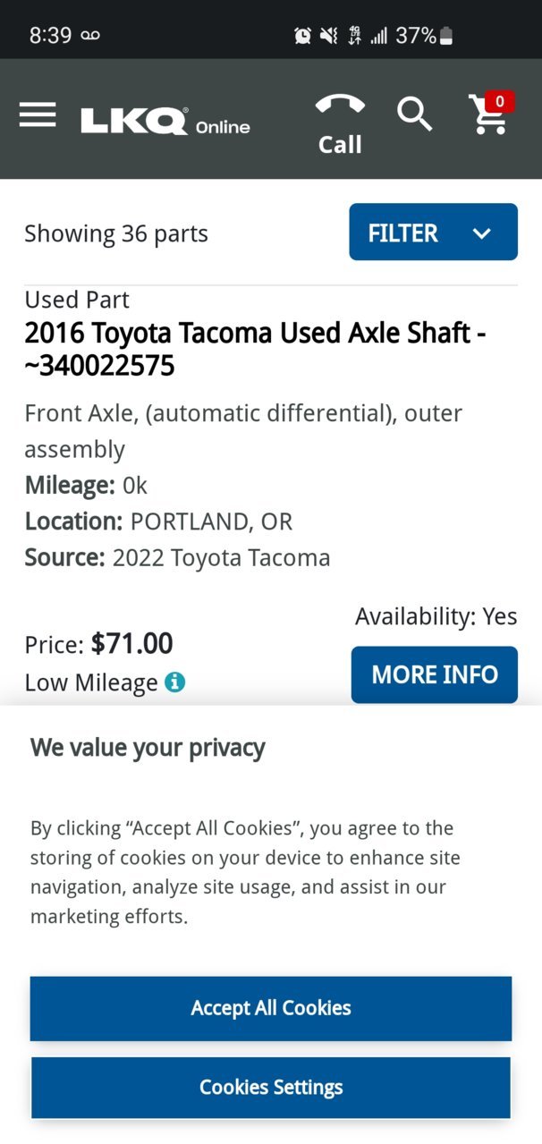

    How many miles are people typically getting out of their Tacoma CV axles?

    Varies a lot. Axles from LKQ are normally from totalled trucks. I tend to have to replace an axle every 2 years, but I'm on 35s, locked front and rear and wheel the piss out of my truck when possible

    When you're looking up cv's do they call them outer assemblys?

    I would assume so, I normally call the local store to order but that looks like the what you would want

    Awesome, definitely feeling like I should have a spare (or 3) on hand after the latest round of mods lol

    Yea, I normally go through one every 2 years. My boots get torn and just wheel until the joint starts to fail and then replace. I think I have 2 or 3 left of the 5 I had

    Wow, that's cheap! I wonder how much shipping world be to get it over to the east coast? I bought a couple CV axles from LKQ off of eBay and the last one I bought came from a 2022 Tacoma from California, so it was nice to have no rust! The first one came from a New York LKQ, and had a hole in the outer boot, so it was sent back.
