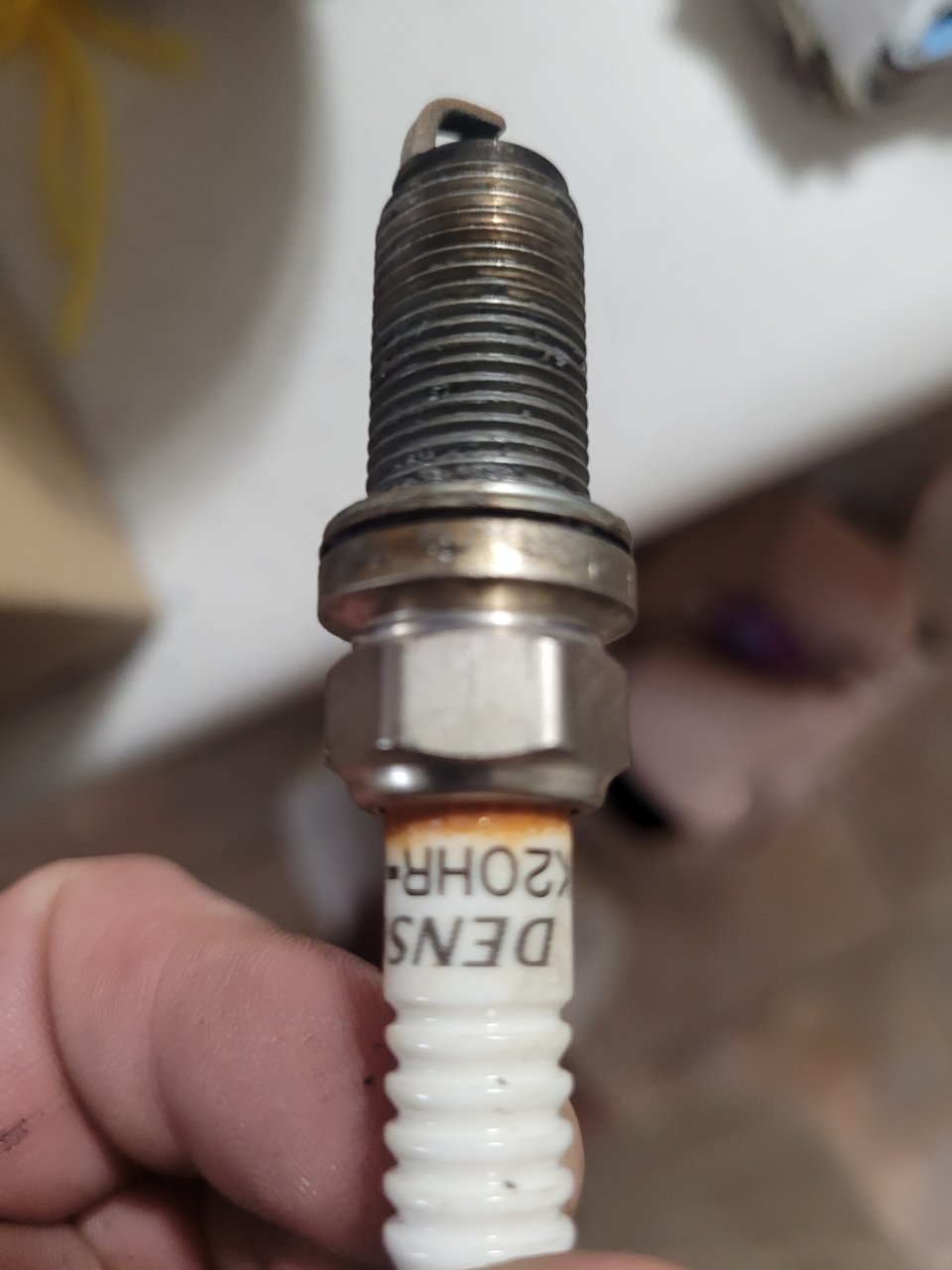

    By all means I did them with fingers first, then Lightly ratchet, then torque to spec

    Looks fine, 1-2 of mine had the same staining at 107K when I replaced em
    jpereira2[QUOTED] likes this.

    I start by reversing them until you feel the threads drop then thread then in. Finger tight then torque down as needed. I know some stuff is "1/4 turn after X ftlbs" or whatever too. I think plugs have a torque spec to them. One of the things I will absolutely torque to an OEM spec.

    Yeah. Mostly the X torque spec plus 1/4 or 1/2 a turn things are referred to as 'torque to yield'. Any fasteners that follow this need to be replaced every time they are taken off.
    In olden days, when I was a kid, it was very common for spark plugs to be 'hand tight' plus some amount of turn. I feel like most manufacturers have switched to publishing a torque spec for plugs.

    I think it was less necessary to torque spark plugs when heads were cast iron. Aluminum is generally softer and thus it's a lot easier to damage the threads and so it's more important not to over crank on them.

    the bigger question or argument is ant seize or not. Im an engineer, i understand all the coefficient stuff. Some mfr's state they have a special coating. I still cant bring myself to not put any, so i apply a light coat and torque 80% or so. Havent had a problem, but has anyone had a stuck plug not applying anything and torqueing normal?

    I've never had an issue so far (knock on wood), if you're concerned you can get the engine nice and toasty and then do plugs. It's not ideal, but it's actually a trick for doing Ford 5.4L 3valve triton motors

    I don't add anything to the spark plugs, the torque spec is usually pretty low, I use my bicycle torque wrench for it.
