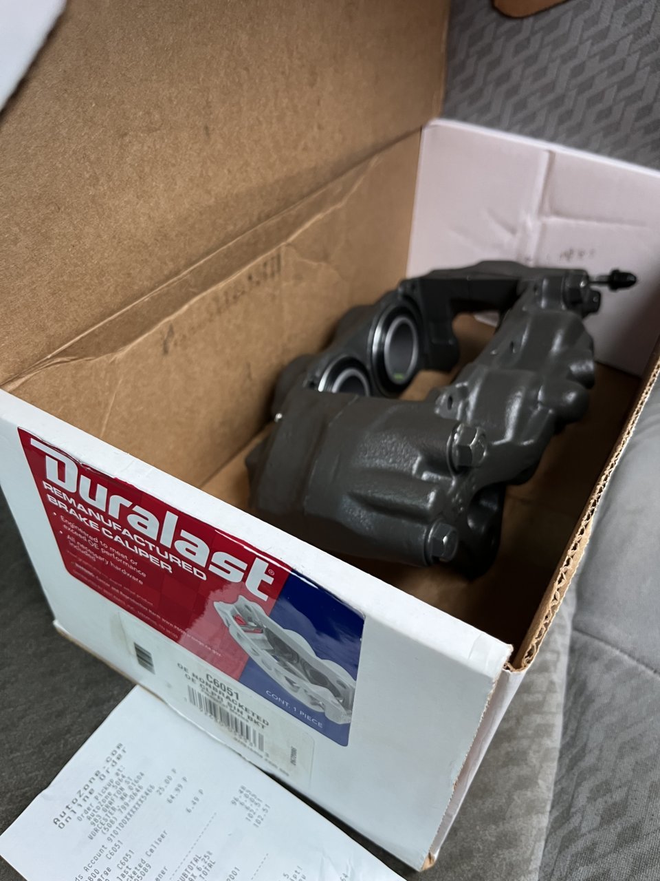

    Right side caliper from 2018 was the AutoZone Duralast remand left side caliper was OEM Toyota… Guess which one failed? Here's my new left side remand.

    I would have guessed the right side.

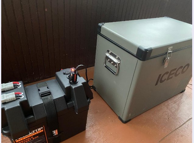

    I'm not 100% confident so i need someone to double check my calculation.
    Next week i'm taking a trip to OBX and will be off grid for several days on Cape Lookout. I am trying to figure out how long my fridge will run on my battery box setup. i am currently testing it this week leaving it on as well. Obviously 85 degree heat on the beach and opening/closing will affect it too.
    Iceco states the fridge will average draw .347 kw/hr / 24hrs.
    I have a group 31 100amp hr AGM deep cycle battery.
    If i'm correct, the math is .347 X 1000 / 12v = 28.9 amps/24hrs= i should get roughly 3 days, 8hrs using their bench test information correct.

    .347kWh @ 12v = 28.9 Ah (per 24h)
    100Ah (nominal) / 28.9 Ah = 3.46 (days)
    This assumes you're going to get all 100Ah out of the battery. In reality, it's best to derate this capacity by 50% to determine the usable capacity, because as charge drops so does the voltage, and below a critical threshold you aren't getting usable voltage.
    Therefore, for your purposes I would consider it to be more like 40 hours.
    If you really needed a precise estimate you would want to look up the voltage curve of the battery, and the input range for the load device, and do some more complicated math, but you're not going to the moon so the 50% rule is reasonable.
    The smaller Renogy MPPT controllers are good to go if you want a reliable, inexpensive setup for solar input or even shore power (with a separate DC charger).

    And also, these things don't run non-stop.
    KW/AH consumed will also be determined by, temp settings, ambient conditions, and how often is it opened.
    So, if you had it set for 37f, and it was in 40f conditions, and didn't access it... battery would last much longer than sit running in 90f conditions. Etc.
    But, Calc at 100% duty, and I like @deanosaurus suggestion of planning on only using 50% of the battery....
