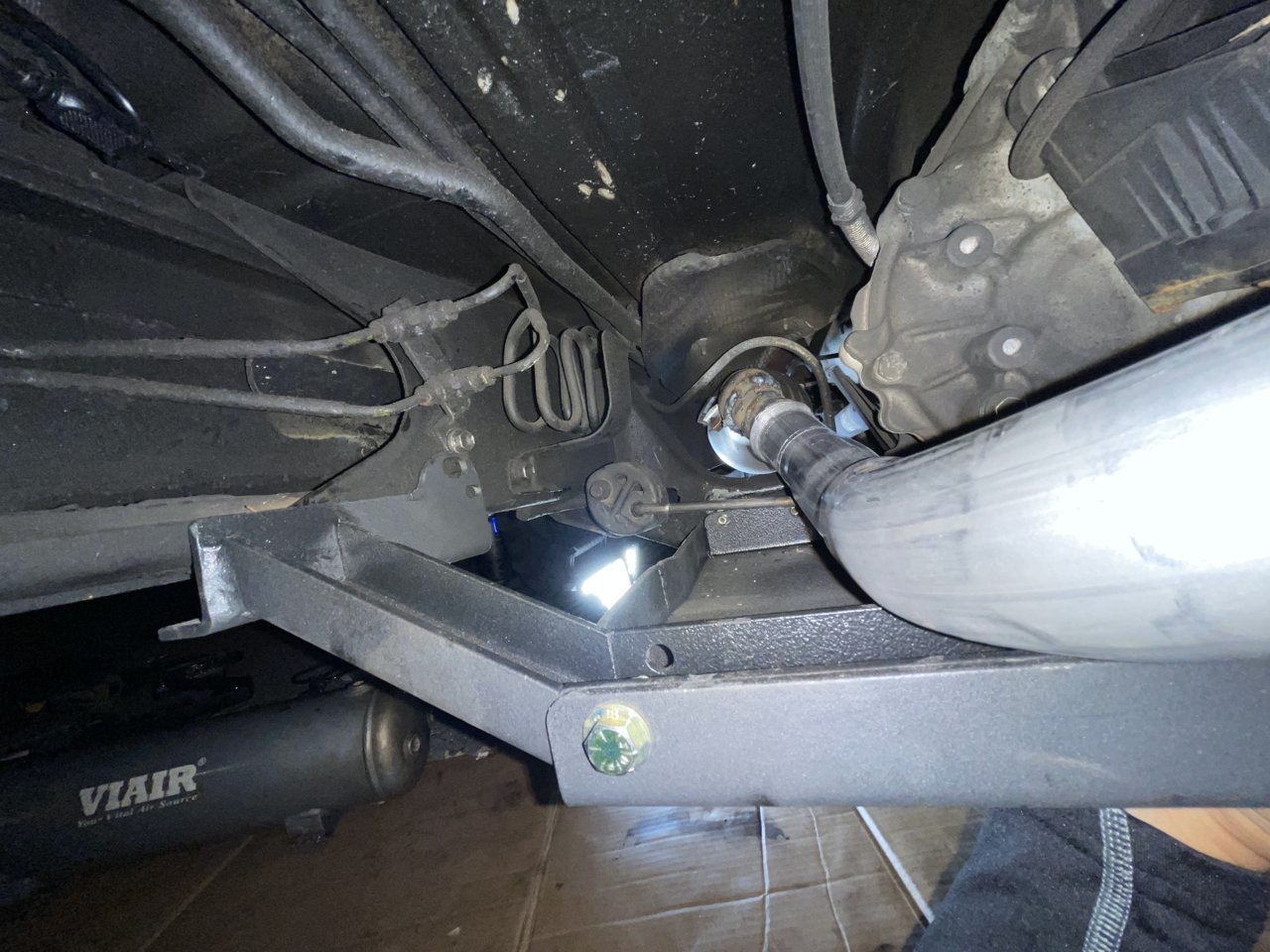

    Something other than the BFG would be good, lol. Here’s how wonky it gets. Not sure why he didn’t just make it go straight. But we are just about 1/2” short.
    The distance from where the skid is, to that bolt, is how far off it is. It’s touching the exhaust at that point.
    Then there’s this, which is good. All the way back to the crossmember and as close to the frame as possible gives roughly 4” of separation. May need to shield that too. Lol.

    Just a thought, there are those clamp on ones that use metal ties. Think those would work?
    I can grab a link from Amazon once I’m back inside, but it’s from the same company @deanosaurus recommended some heat shielding stuff for.
    Probably yes to purchase, if prices are cheap. Let me know how much.

    Should be 2.5 after the collector I'm pretty sure. After the cats it's 2.5 for sure though

    As far as the heat shield goes, damn near anything will work. The on pipe ones are prone to noise, etc. That is why it isn't my go to.
    I've used the DE stuff for..... coming on 20+ years... But, I'm sure I still have at least I bike header here, that is trashed, and wrapped.
    I use it. And hate it. If that makes sense..:notsure:I just wouldn't use it on a driver. Plenty do...

    Those DEI clamp on best shields are meh. The sheet isn't stainless nor are the worm clamps 100% stainless. I put one on the passenger secondary cat when I replaced my trans cooler lines and wouldn't have bought it if I had known those details. I hit it with high temp paint and used stainless zip ties to hold it on. It's been OK but I should have bought some stainless stock and just made my own.

    @TacoTuesday603 you able to buy/weld stainless stuff? I don’t mind paying for the whole ass sheet.

    Are you looking to change the exhuast routing or modify the skid? I think I will be able to weld 304 with a special fluxcore wire. Can also make the heat shield out of 304 so rust isnt an issue.
    If I remember I will look today. At work I use 304 all the time so I'll check if the shop has any cutoffs that would be the right thickness.

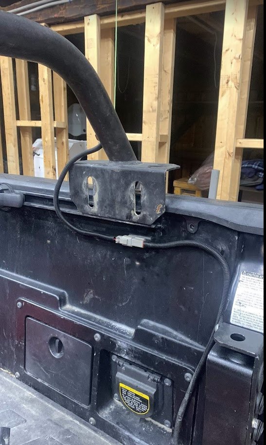

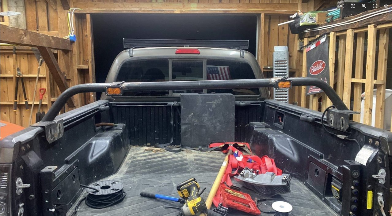

    I finished up dialing in my easily removable bed bar setup last night. Deutsch connectors make the wiring so nice.
    Its funny I'll do all the fun work really quick then it takes me 2 months to connect the two wires.

    Either? But if we cut the skid, would make it super weak in that one area.
