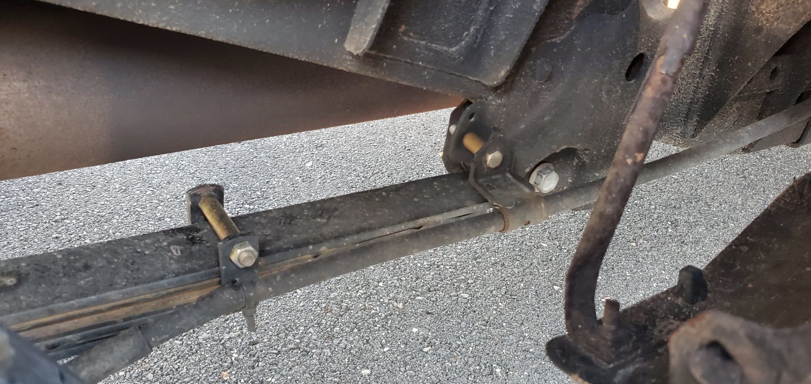

    The list is growing.
    Here’s a pic of mine

    @jpereira2, ok so here is what I did. I purchased a long bolt, and got a 1 inch brass tube spacer and relocated the bracket further up the leaf so the spacer pushes the line out further so it doesn't rub anymore.

    See above.....it only cost me about $10 in parts and works great.

    Oh, I like that, seems like a worthwhile mod :thumbsup:!

    Yo that looks really good! You know what length bolt roughly?

    unfortunately I don't. I just took out that bolt, found the overall thread pattern at Home Depot, found the brass extension that would fit over it, and then picked a bolt in length that would work with that extension.

    Imma guess 35-50mm. Again, looks awesome. No stress with the rest of the cable to the drum?

    No stress at all because it is not being lengthened, just shifted off to the side. I did use a stainless bolt to make sure it didn't rust.

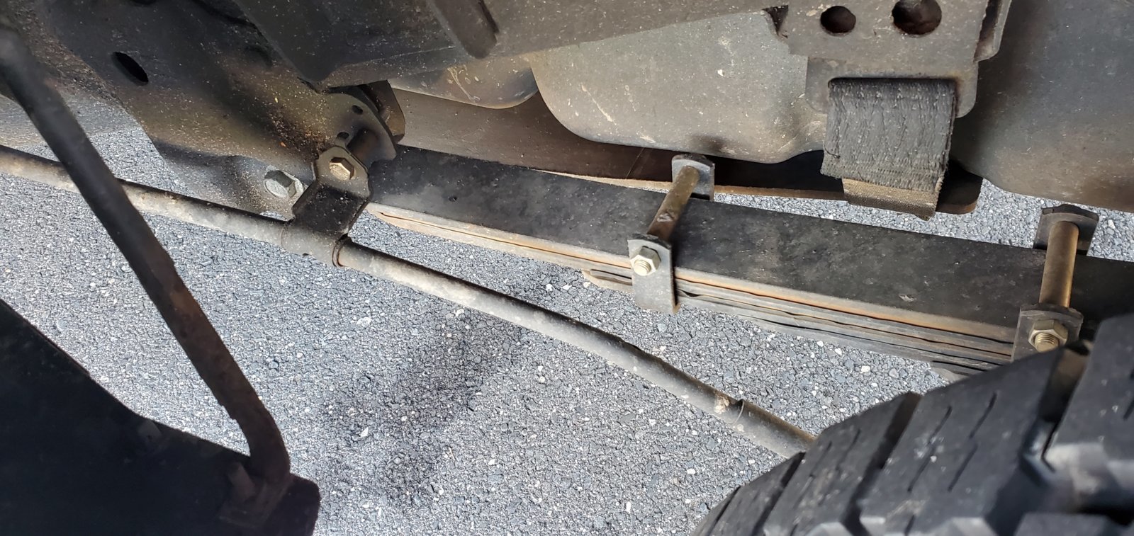

    I assume I can just replace hardware here with a bolt and lock nut? Its the one spot on my truck with dare I say it....rust
