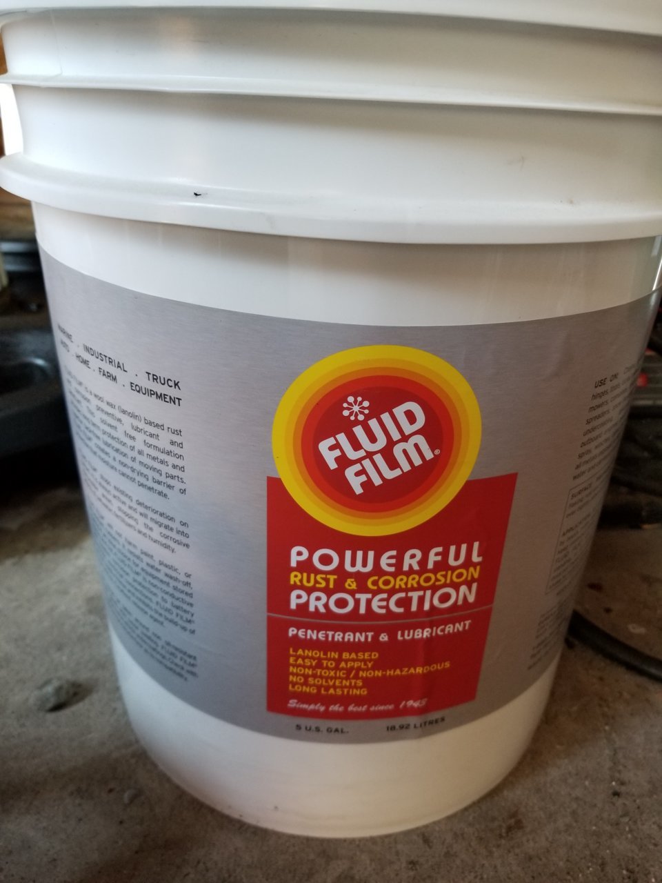

    Fluid film you need at least a solid 2-3 coats and then you will start to notice a difference. One down side is it does stay tacky

    It is but you are paying for propellants in the can so you are getting less for your $. can method would take ~6 cans = $60+ chump change to protect your truck but the gallon/gun method had a better roi

    You can find the ff gun online, then hook up to a reliable 100psi compressor

    No need to, I would let it sit for a couple months. The salt is gone, this will protect through summer. The undercarriage wash wont take it all off but certainly thin it out. Get your wash without undercarriage spray

    I personally would take them off so I can get more coverage.

    I can get around them, the spray has a good throw...dont worry about it. I'll look for a gun extension too
