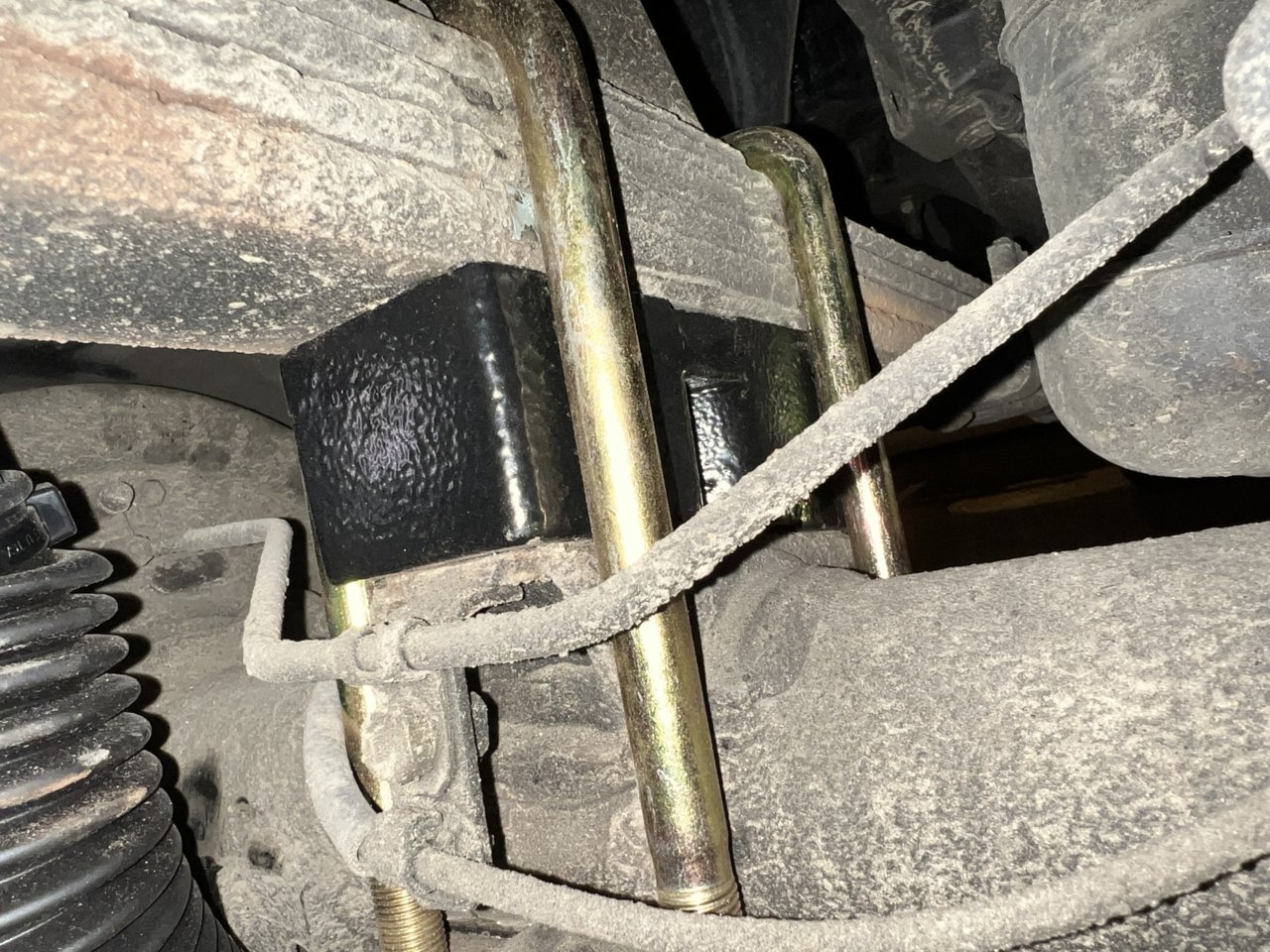

    like I was able to force it forward twice for about five feet then it got caught in something. I assume the u joint is getting caught on itself. The pics from yesterday show the angles of the shaft, doesn’t look severe at all to me

    How did you lift the rear, blocks or AAL?

    2” block

    I believe there's a taper to them for your driveline angle, im wondering if they were installed facing the wrong way...

    I can’t tell but maybe you guys can

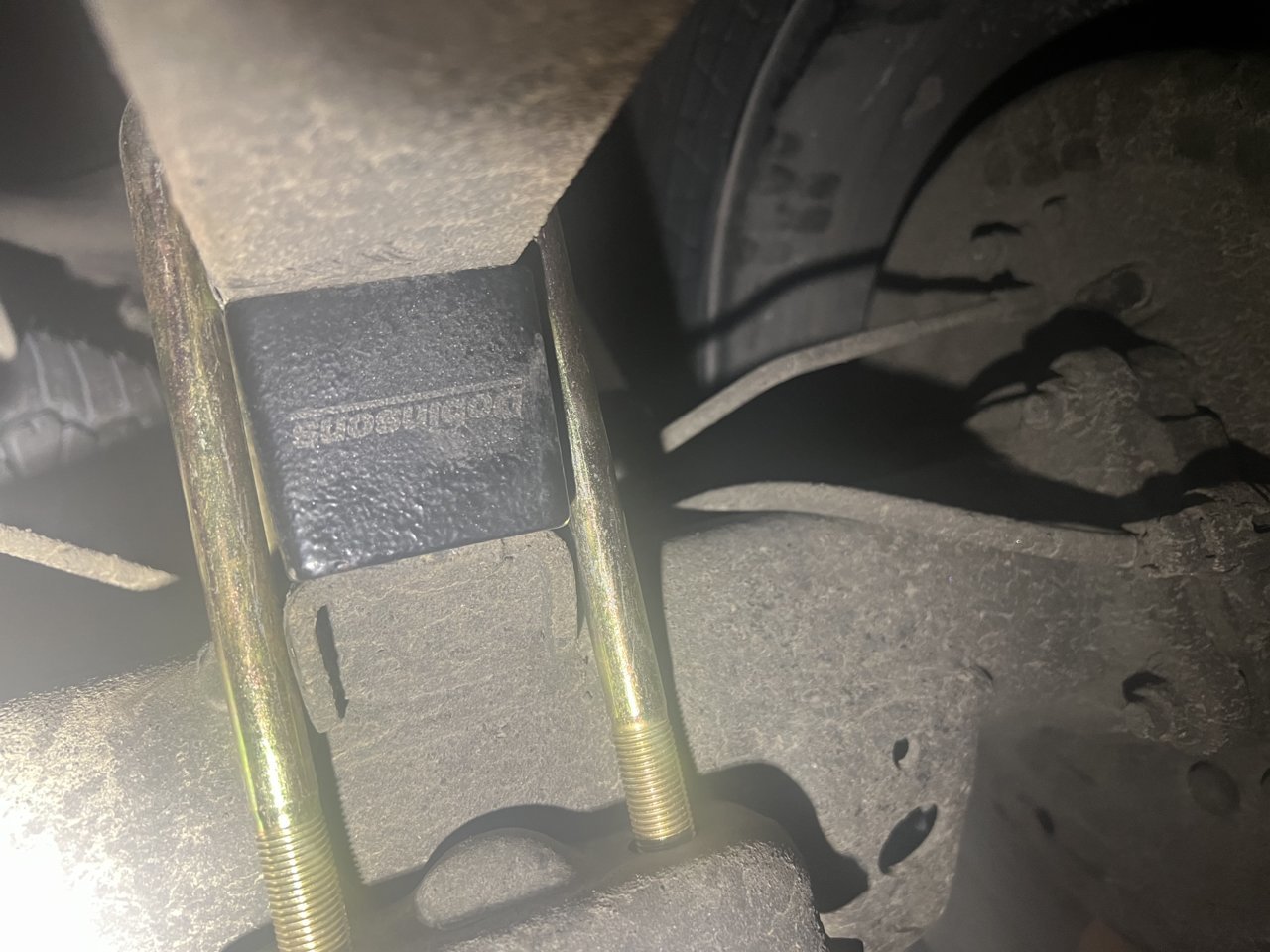

    10503971-24D8-4E78-8512-662271E87F72.jpg Sorry here’s a second pic

    Hard to tell from these pics, can you see a taper to the block? The thinner part should be facing the front of the truck if you can

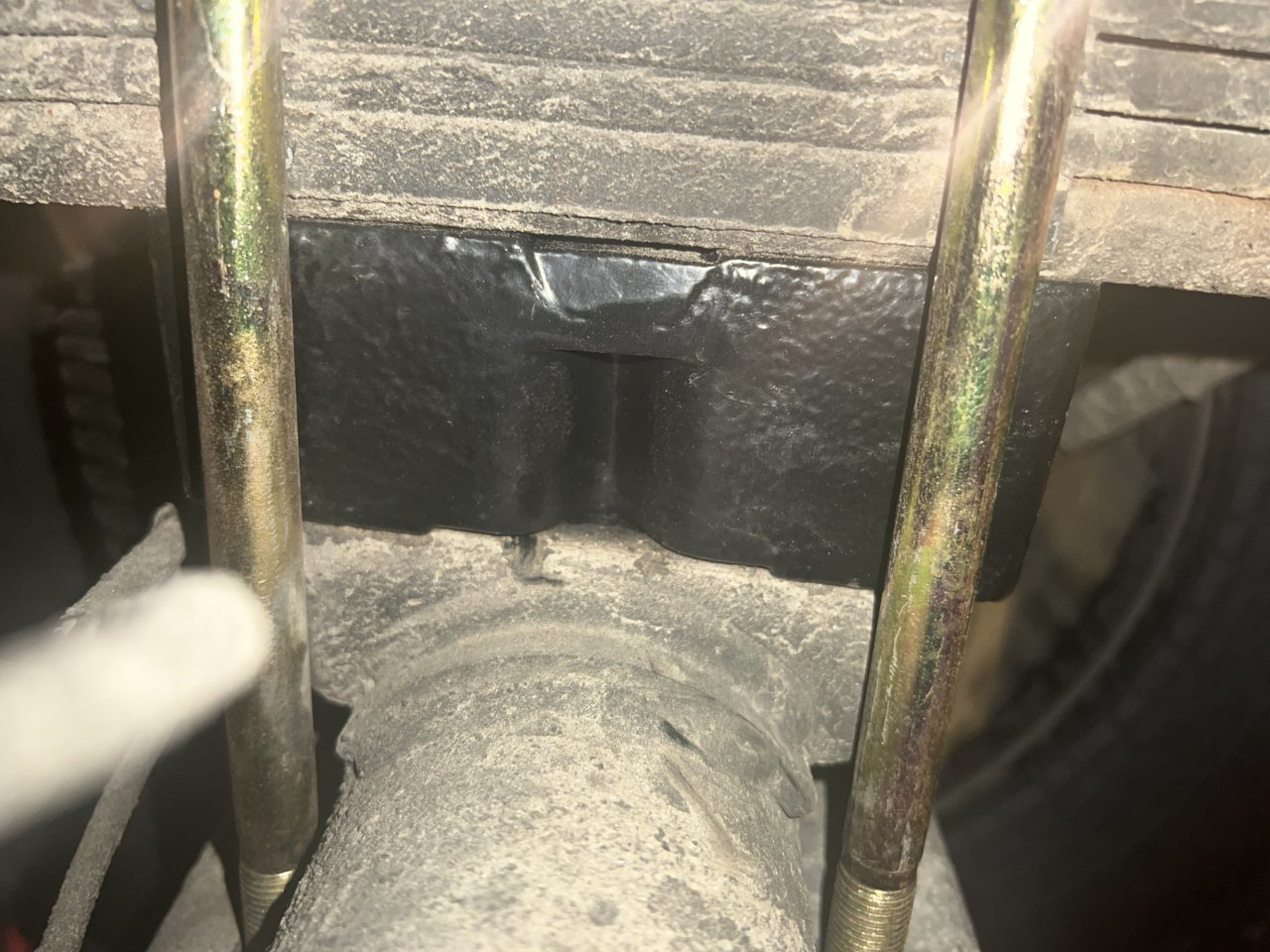

    i only have my phones measure app so I’m only seeing 2” per side, my girlfriends bringing a tape measure
    here’s a pic from the front E0F23C9D-B3B9-47D0-8C7E-E8639ED141A5.jpgis it supposed to read upside down?

    Probably not...I'd call whoever installed it and ask them to take a look

    Well I got home, measured and it’s 1/8” longer in the front. So good catch @Brownmatthall I hope that’s it

    It would definitely account for everything you're describing
