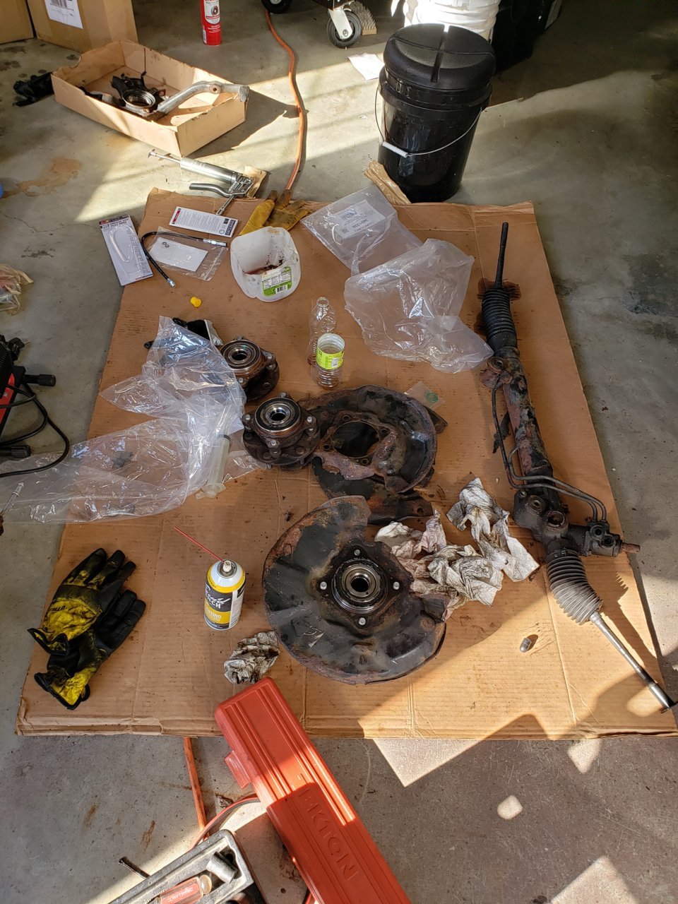

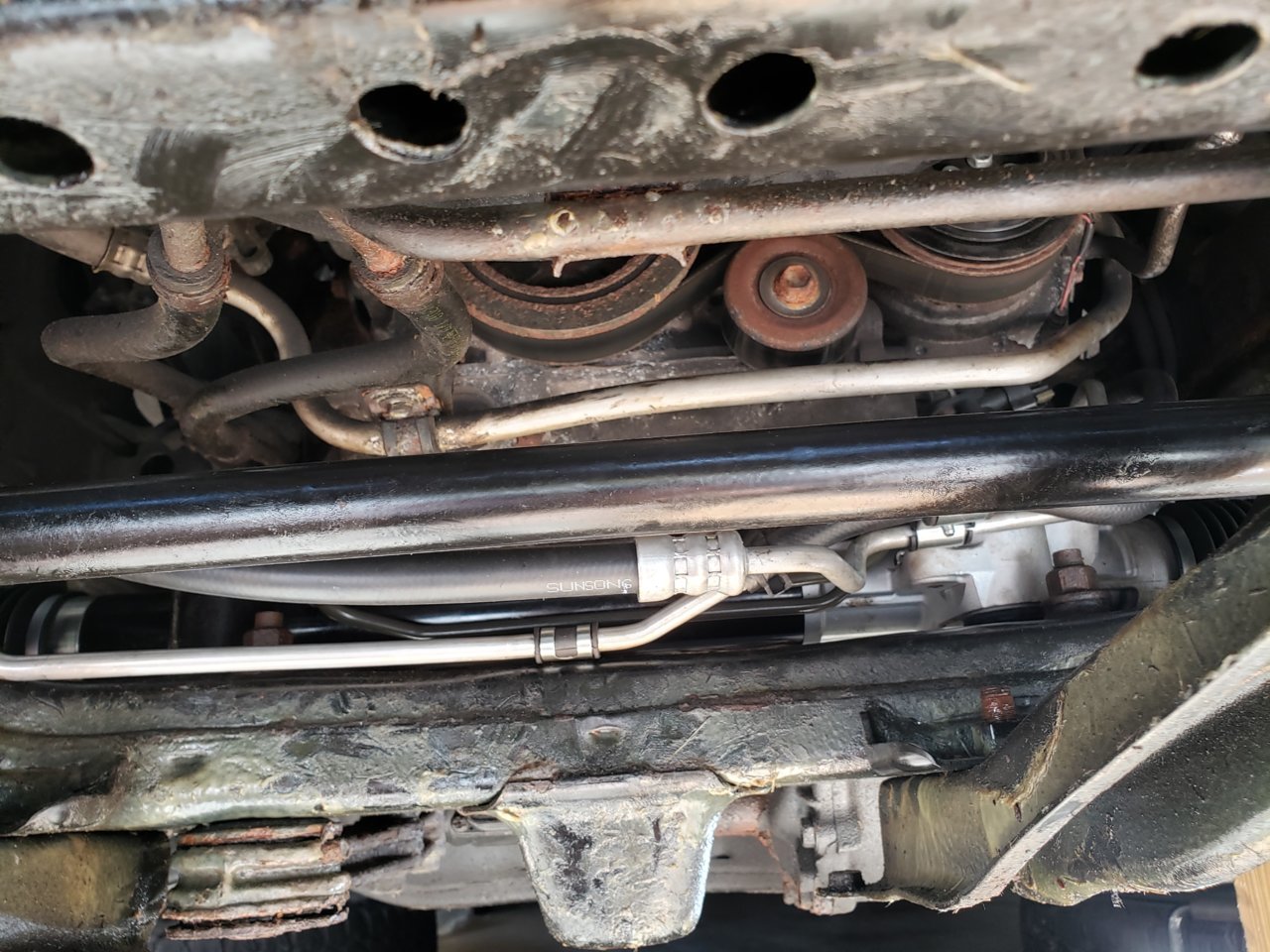

    Just went through the pain last week. Replaced the rack and hoses and replaced the ujoint in the intermediate shaft with the ATV ujoint mod on the forum(had the frozen joint that I had been milking along for several months with PB blaster).
    Used new A1 Cardone rack and new aftermarket hoses.
    Bought two new (Toyota OEM) bolts for the rack, sawed through the old ones about 50% an snapped them off with impact gun. Reinstalled the new ones upside down for easier access next time.
    Full thread is on the fourm and you said you have done it before but here were my issues.
    Disconnected the battery, worried about the airbags while jacking with the steering shaft.
    Removed the wheels.
    Flushed the fluid prior to changing (disconnected the return line to the reservoir, put the return line in an old water bottle and turned the wheel back and forth several times and kept filling the reservoir up until new fluid came out ), hoping to get all the crap out prior to change.
    Secured the steering wheel with seat belt.
    Removed the outer tie rods.
    Removed the hose clamps and hose connections I could get to.
    Dropped the front of the sway bar.
    Supported the tranny and removed the front bolt for the tranny mount. Don't know if it helped but saw it in a video on the steering rack swap thread.
    Removed the intermediate shaft (had to unsecure the wheel and rotate so I could get a socket and wobblly extension on the lower screw thru the (front left front wheel well) to get the intermediate shaft off. Re-secured the wheel again (with seat belt)and removed the two upper screws to the intermediate shaft (used ALOT of PB blaster on these bolts and shaft to get it to slide upwards. Used a 3lb mallet and pipe to whale on the old ujoint area to get the shaft to move, took a while, YMMV.

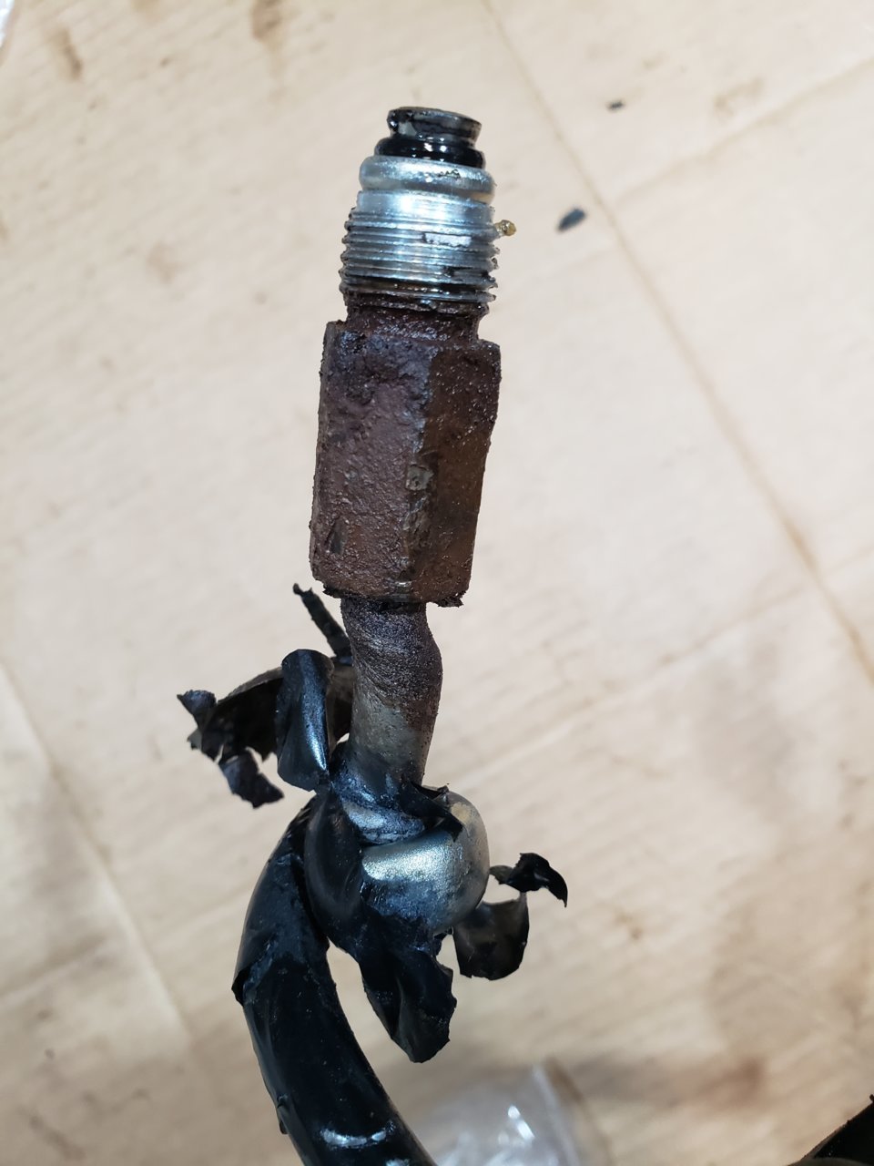

    The supply to the rack wrapped up on me and cost me about and extra hour trying to get it out (see picture). To save time cut it close so if the hose is rusted to the connector you don't waste your time. Also, bought and used a new return fixture in case the old one was frozen in the rack, it was.
    Tilted the rack back and forth and moved from side to side to remove.
    Rack back in (used a video on the internet I think it is liked in the main thread, to center and mark the rack, worked like a champ very close when aligned after the reinstall).
    Centered the rack using the mark from earlier and reinstalled the intermediate shaft. .
    Hooked up new hoses filled reservoir. Hooked up outer tie rods (counted how many revolutions it took to remove and put back on with the same number for each respective side, after the steering rack was centered) bled and flushed again with new fluid.
    Reinstalled the tranny support bolts.
    Bled the system by turning the wheel back and forth with engine off and front still off the ground. Reconnected the return line and ensured the fluid was at the cold mark.
    Inspected for leaks then reinstalled the sway bar front brackets.
    Reinstalled the wheels. Reconnected the battery.
    Removed jack stands, started the vehicle , looked for leaks. drove up the driveway and made a small turn left and right, stopped and checked for leaks.
    When to a short test drive, intermediate shaft was one spline off on initial install, re adjusted the intermediate shaft (if this happens to you make sure you secure the steering wheel with seat belt) on the rack after test drive.
    ABS Sensor was on for about the first 30 or so miles cleared itself after that. Had it aligned and the alignment was barely off.

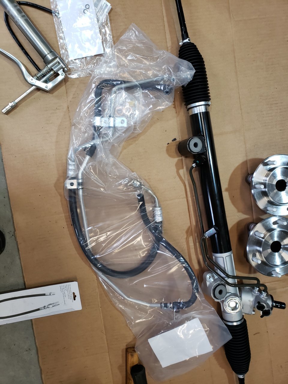

    I ordered oem rack($605), return fitting ($8) and nuts and bolts($17), Gates hoses. Trq lower intermediate shaft. Might grab a new steering shaft today just so it's all new.
    I'm not doing the atv ujoint mod but will be putting a boot over the joint to protect it. Filled with red n tacky of course. Still looking for a nicer boot than diy innertube.
    Used rockauto for non oem, local dealer for the smalls and boch Toyota had the best price for a rack and was one of the few that didn't want a core charge.

    Totally agree except I'm at 235k on the og and it got stiff once or twice. Rack is toast. I'll be replacing the new rack long before the new intermediate shaft has any issues.
    Update on oem racks...national backorder:annoyed:
    Ordered bbb rack from rockauto and a rebuild kit for the original. Should be a win-win

    Really just seemed to be the best cheapest thing. Read that Cardone racks are becoming a crap shoot and a few members recommended bbb over the others. I think any other than oem is a crap shoot so also got the rebuild kit.
    The used racks all had 80k or more on them.
    Sent pretty good at aoaa but it was already going
    Thanks, doesn't seem terrible if you're willing to throw away the hoses and fittings and bolts... well everything :sawzall:
