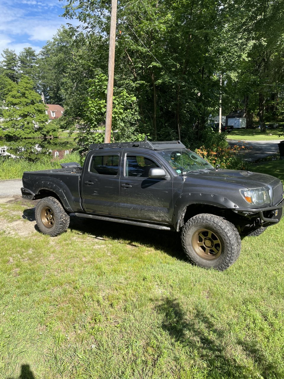

    After being rained out yesterday I finally got it back together! Still need to do some cutting and get her aligned.

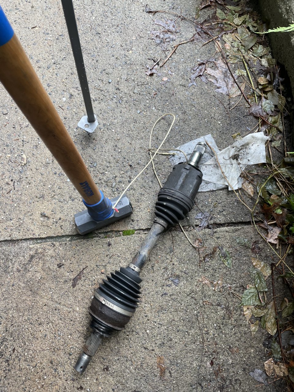

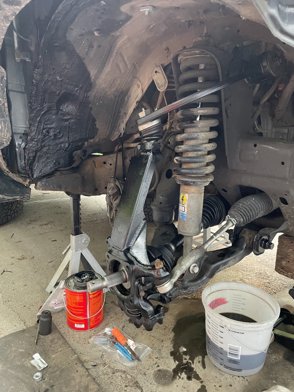

    put in new cv axles, a tie rod end, spc uppers, changed the front diff fluid and replaced the fill plug with the Lexus plug ( no more hex), replaced wheel studs with longer arp Lexus studs, repainted spindles, hammered the shit out of the firewall and fenders, oh and landed on 35s
    :bananadance:
    Yes I rub but I’m willing to cut out the offending parts

    Looks so good. The bronze looks great

    So, for hammering the firewall, fenders, and maybe even pinch weld, what is the stuff you threw on top? Seam sealer?

    Roofing sealer, forgot what thread and who it was but it sticks great and is made to be waterproof. I still have 3/4 of the gallon and did Matt’s truck already. Don’t buy any, just take some of mine!

    The way God intended, looking real good brother :D
