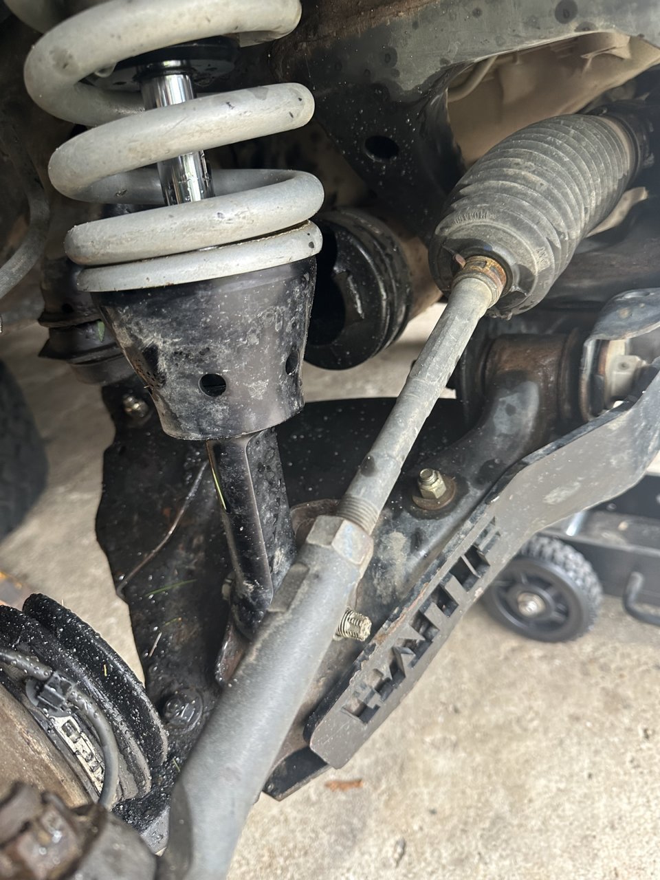

    Did some off grid camping in winchendon and had to hit a decent off camber turn that maxed out my steering and assuming that’s what did it. Boot was ripped(cheap autozone axle) already so it was getting replaced this week regardless lol
    sounds good. I’ll keep an eye out for that mod day.

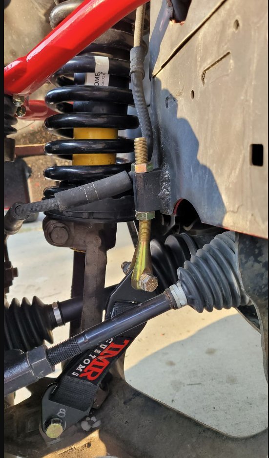

    Those look pretty good. Just need to make sure the top and bottom mount are inline or else youll run into this problem.
    Also Im my opinion it is a really good idea to have a double shear joint instead of single shear. Maybe you can do this by adding another tab and longer bolt on the LCA. or one of these.
    https://www.tmrcustoms.com/collections/limit-straps/products/double-shear-tab

    yeah I saw that comment. If I’m going to weld a tab on the LCA I’d rather wait til I swap them out. My plan was doing them next month but probably not til middle/end. If I do that then I don’t mind welding a tab and mounting it on the backside near the bumpstop.
