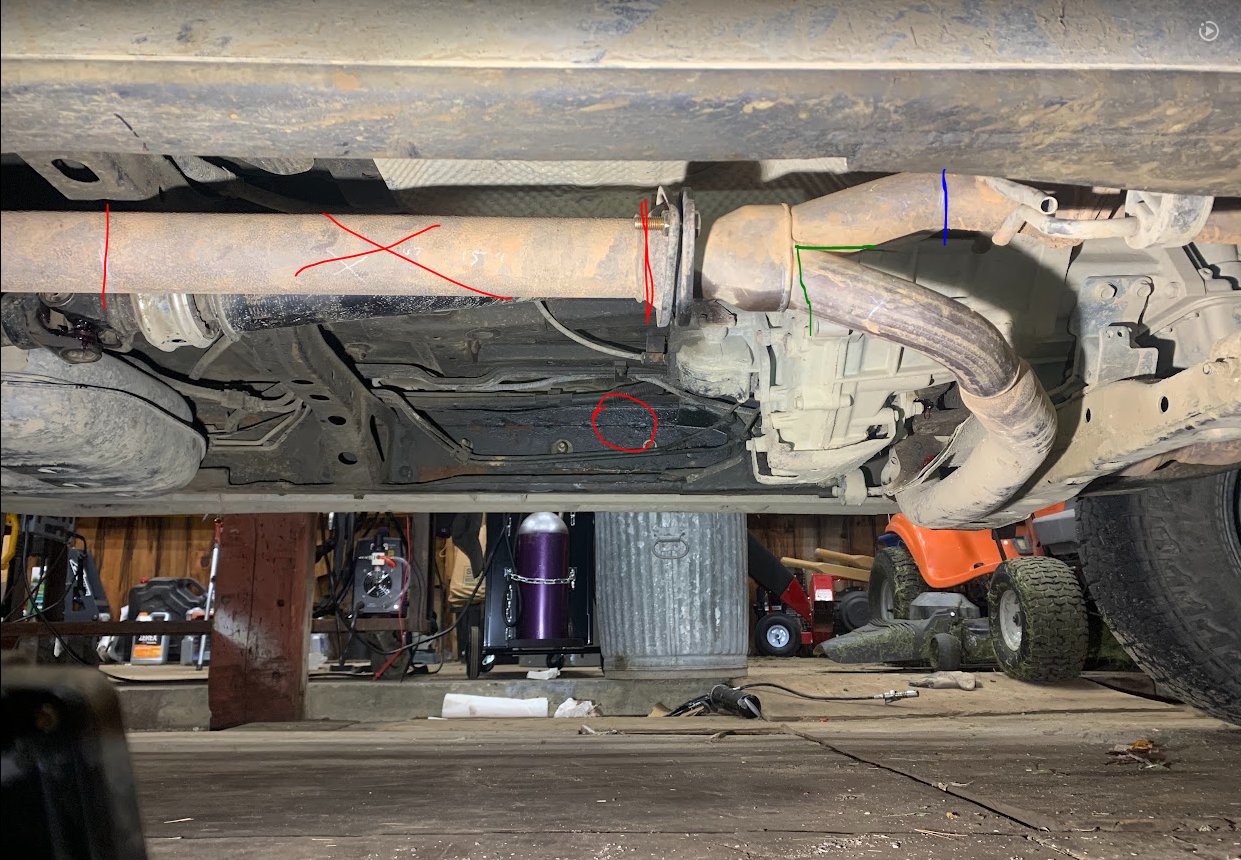

    All this reroute talk made me crawl under mine and get a plan together. Cut the red lines and weld the factory flange ~15" further back. Cut out blue line and weld another pipe in to extend it around ~15". At the green line cut out the drivers side portion(on the bottom) and weld a notched, level 90 in its place to go to the passenger side with another 90 going straight to the cat. That should put it right around the red circle.
    Anyone see any issues with this that I am missing? The only joint I will need to fully weld in place is the rear flange portion. Everything else will be tacked on truck then taken to the bench and finish welded.

    the only issue that I see is that if at any point you choose to replace your rear exhaust, the phalange will not match up with the original distance of a stock or aftermarket replacement so you will have to then look into building your own exhaust system after that rather than a direct bolt on. If that is your original intention then I can't see any other issue. you're pretty much saying that it will look like this, correct?

    Similar to that but I dont think I'll rotate the flange like he did. And less bends sense I'll be buying sections of mandrel bent 304
    Good point about the replacement, but I think if I need to moving the flange wouldnt be too bad.

    @TacoTuesday603 , agree with @crashngiggles
    A good quality cutback like borla, move the flange, and you could remove tailpipe at at will for wheeling, so, it doesn't get mangled.
    But, I'd just send it, and worry later if you're good burning SS...

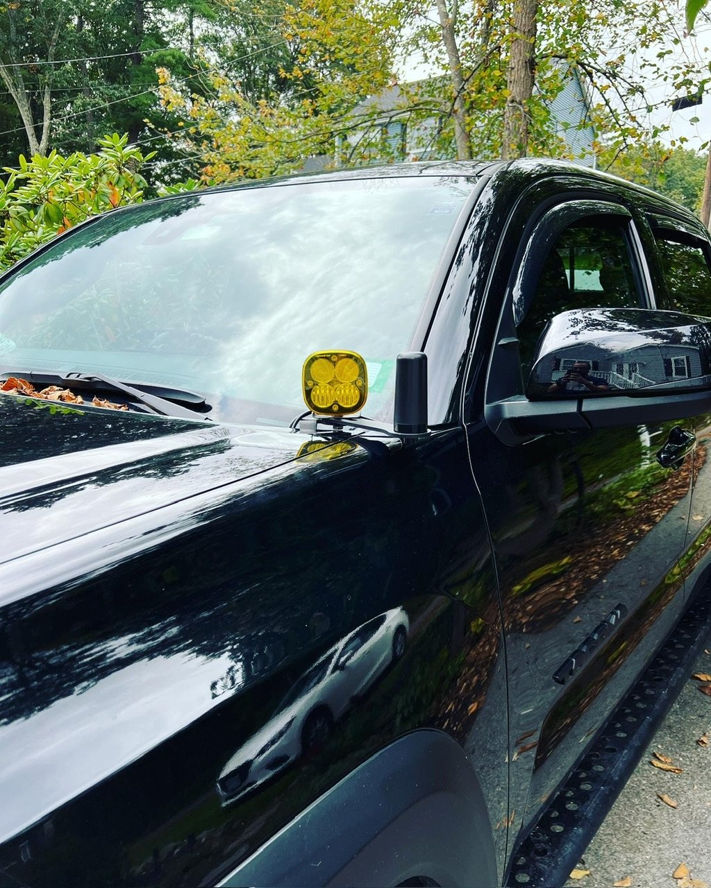

    E5441F4E-99C2-4E36-B027-B6B1A7ECDDA2.jpg Finally installed my radio lol, easy. Not sure if I’ll require it with an add a fuse or just use the cigarette lighter socket

    That is the shiniest mirror housing I've ever seen

    PPF!
    nah just the angle is just right, the ppf is beat up too lol
