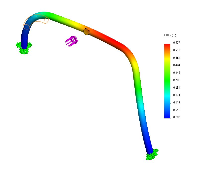

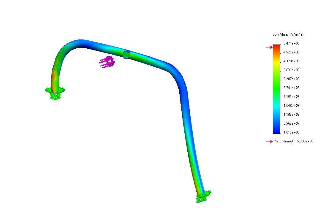

    @AllTacosFloat I did some messing around with simulations. These are approximate for the rear scrub bars out of 1.75" x 0.120". These are all 2k lbs (this may be excessive) going directly into the midspan of the tube.
    0.50" is a lot of deflection for me. At 1k lbs it was around 0.25". Stresses are high around the mounting points but those should be easy to gusset.

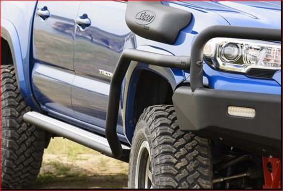

    Thats the plan for Johns, We are thinking maybe using some roll cage parts to make them removable.
    Those are interesting, even going to ARBs website there is no info about what they are made of. (other than 2.375" tube). I expected more techincal details from arb.
